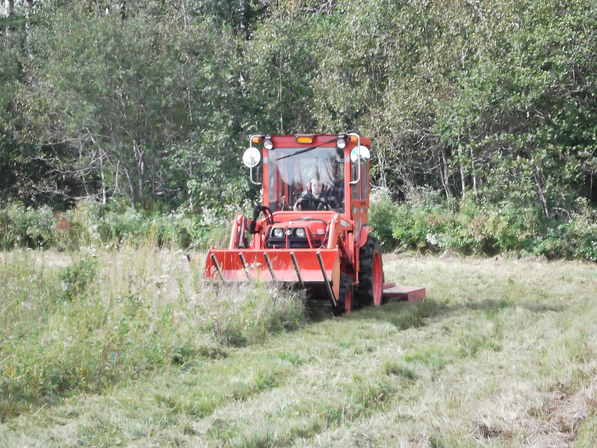

Some sort of light box should work. When I built my cab I moved the signal lights from the ROPS to the fromt of the cab. I also installed a mirror on the left side that sort of shielded the turn signal. Over the next few years I lost 3 lenses from the right side, but none from the left side (with the mirror). Two years ago I added a second mirror on the right side, protecting the right turn signal. Since that, I haven't lost any lenses.
