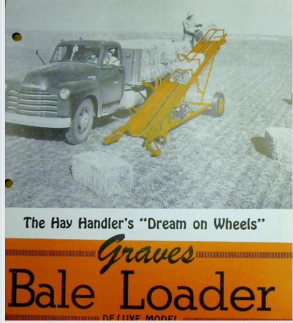

About 3:20 in the video, tell me some more about that trailer and loader please. Ive never seen an accumulator/elevator like that.
Hay loader in video is a Graves that was built yrs back in Clinton,Ok. The unique thing abut that hay loader is as bales tiers get taller on trailer then loader ramp can be raised by an incorporated winch to keep pace with bale height on trailer.
