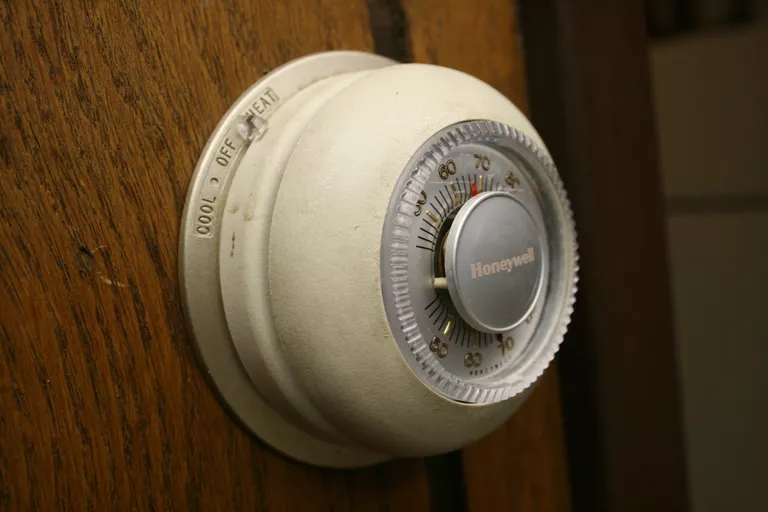

My dad was in his early 60's back in 92 when I put a T86 on his wall. He loved that thermostat as it worked well with his new (back then) V7 Burnham boiler. I have a pretty simple older 8000 vision pro tstat in his basement now living with us. He HATES that t-stat even though I have no problems with it,

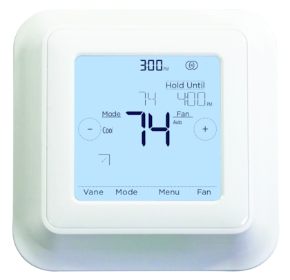

Does there need to be a base unit wired to the air handler to communicate with the MHK2 unit?
Yes, that is what is called the wireless receiver (which I'm assuming you're referring to as a "base unit") . Generally, you won't even notice the receiver on the indoor unit as it's not big by any means.

The way I see it, when you're dealing with someone over 50 years old, which controller would YOU want? ;)
I'm just getting old. For residential use, I still scratch my head on why someone would want to control their residential HVAC system with their phone.
It's simple. Don't have to get up out of the recliner to change the temp. :)
Good ole Honeywell T86 T.stat I must have installed thousands of these back in the day !
Now with this controller I have for the VRF. You just let it do it's thing.
No set back, time delay, smart phone changes nothing.
Like Ron Popeil would say. ''Set it, and forget it''
Up North, generally it was only heat on the T-86 LOL
Then again, my dad was the type of guy that if anyone tried to sell him something he didn't need, out the door you went LOL After mom passed in 2002, I tried to talk him into letting me install some mini splits for AC in his home, as taking the window shaker in and out for the summer was becoming a chore for him as he got older, but he would have none of that.
I just find it amazing that people will spend money on efficient inverter compressor systems with variable speed blowers, only to muck it up because they like to play with the temps on their phone or they like to feel "in control".
Used a different subbase for heat only.
They also made one like the T86 (can't remember the number) used on Millivolt Floor Furnaces. The difference being, the millivolt T stat. didn't have the heat anticipator, as it used up some of millivolts required to operate the F.F.
I probably still have a couple still laying around.
Don't let the Mercury Gods know that, or they'll come looking for that mercury 😂

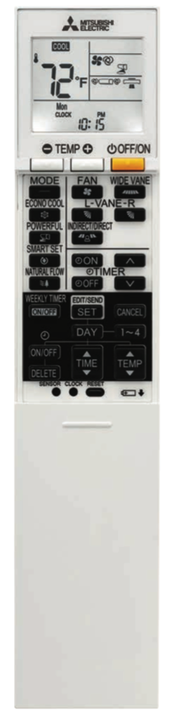

  • The remotes are IR powered. You have to point them at the unit and hear the verbal beep that the unit received the change from pushing the button. There is no thermometer in the remote, the thermometer is in the head unit and is adjusted there based on the air coming into the unit.
  • The units are always on when active, meaning the fan is spinning, the condenser will turn on and off based on the temp setting. There is no way to set these up with a smart thermostat to have them shut off at night or when the rooms are vacant.
