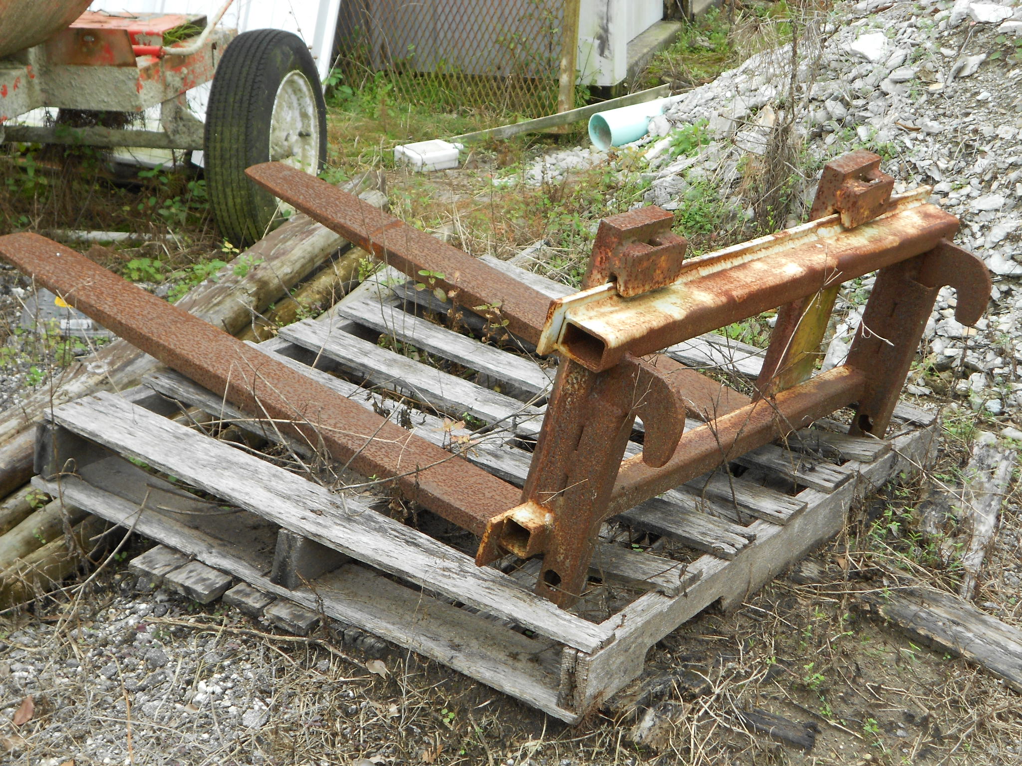

I have a Branson 3510 and I made an adapter for attaching forks.
I pull a spring loaded pin and move a lever and the bucket is off. I pull up to the forks, lift and move lever and I have forks.
When I bought the FEL I could have spent an extra $100. for a universal connection but I didn't think I needed it since I have a metal/fabrication shop.
