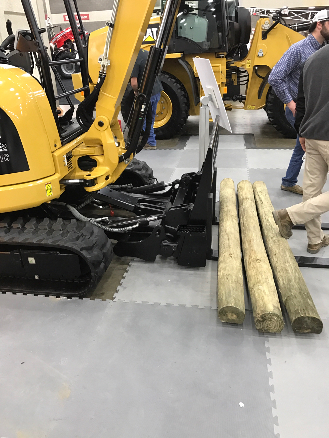

That's slick, I never thought about putting it there!
I was wondering about putting one in place of the bucket or maybe be able to swap out a ssqa in place of the bucket then you could put a whole variety of things on it.

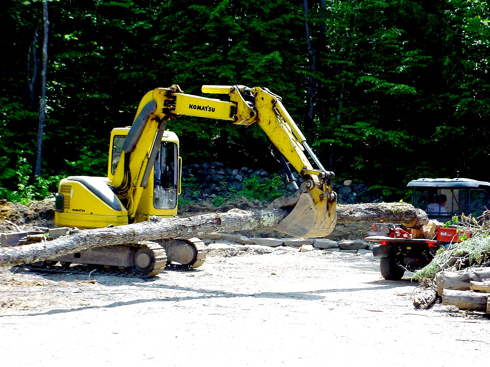

Also Place a big boulder or log on side where tree wants to fall so that when it goes over the stump gets pried out, then pick up tree and cut it up off ground to help save your back.
