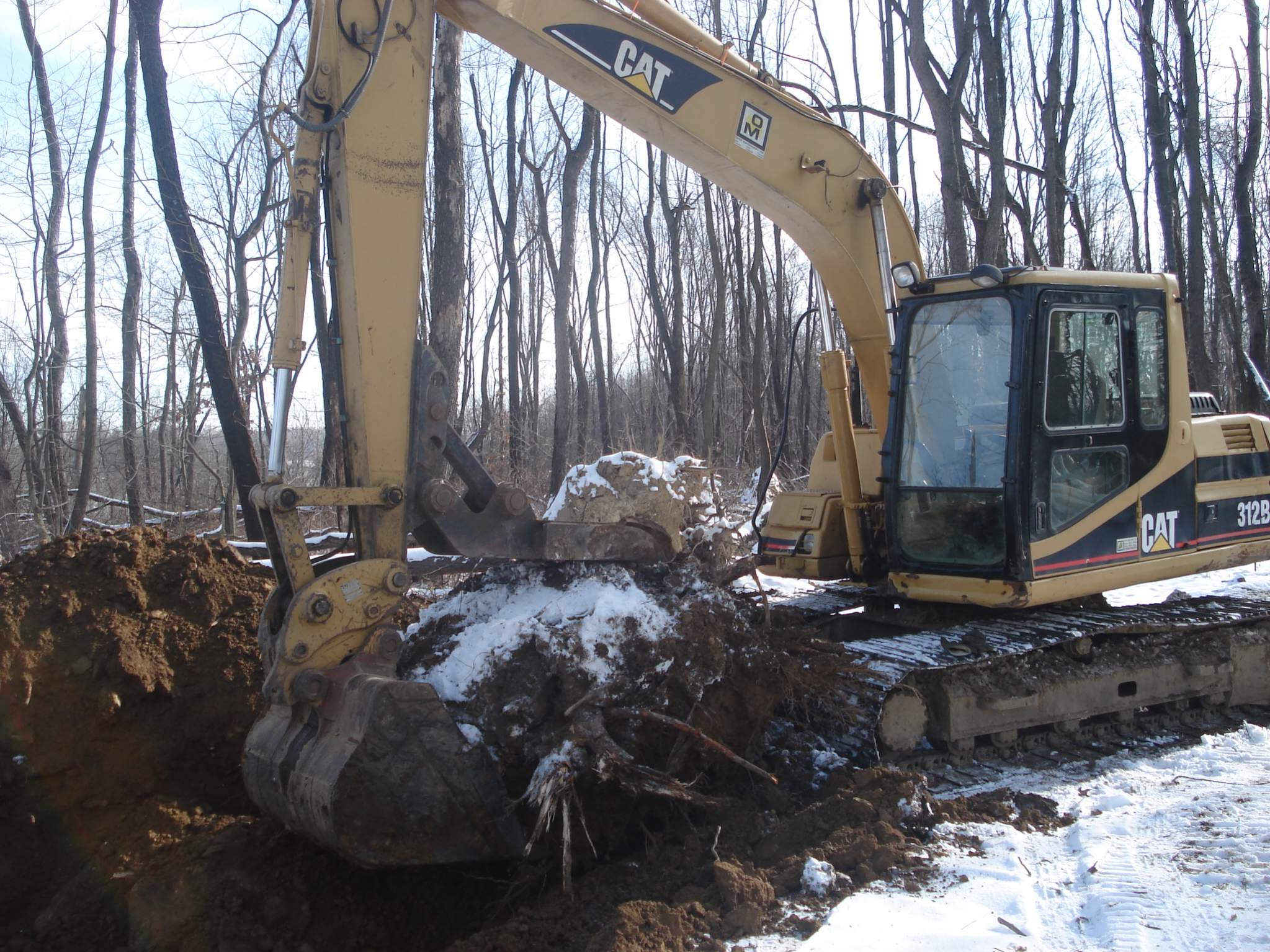

For what you want to do, I would also opt for the mini-ex. I have a backhoe for my 32HP compact, and do do several projects with it, but to pull stumps nothing beats an excavator. A hydraulic thumb can move your logs/stumps, and a blade can level your trails.
Heck, for a few thousand more, I'll sell ya my bigger ex.....:D:laughing::

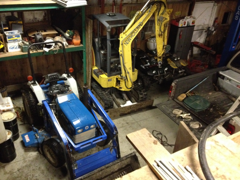

I don't know, I got a mini for my projects and I can't believe how much work it can do. Originally I got it to waterproof the exterior of my basement and just that justified the investment as I completed the project 5k under the lowest estimate. It was a lot of work, but I am still 5k ahead and I have an excavator. Since that project I have used it far more than I ever expected. It has more control than a backhoe moving large heavy objects as it can move the boom like a backhoe, swivel, and the tracks can spin on the same axis. Mine is 7500 to 8000 lbs and doesn't move fast, but I can load more with it than I can with the tractor (it is a 23hp tractor) and the tractor can then haul it.
One day, I wanted to clean out the fire pit and used the mini to dig it out and drop the ashes into the tractor loader to haul them out. The fire pit is about 8' inside the ring of rocks and in a finished part of the lawn. Using both kept all the mess contained within the ring. Couldn't have done that with only one machine.
I love my mini and wouldn't have been near as happy with a TLB. They can't get as close to things and don't have the positioning control that a mini has. Those are important to me on my smaller acreage (10acre) since I don't have as much room to spread out. There have not been any times I wished for a larger machine yet either - maybe when I start dredging the pond, but that is still a couple years off.
