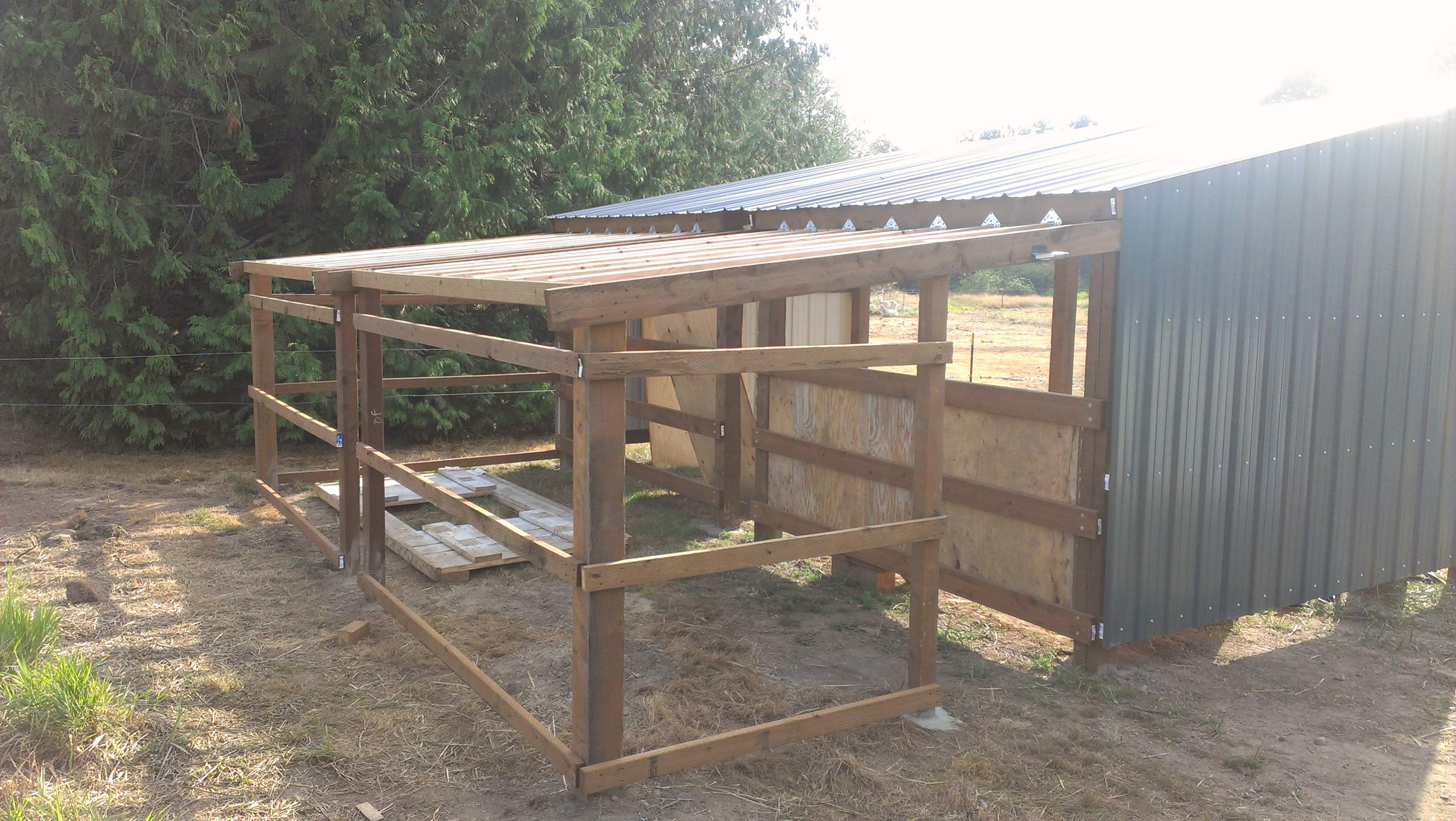

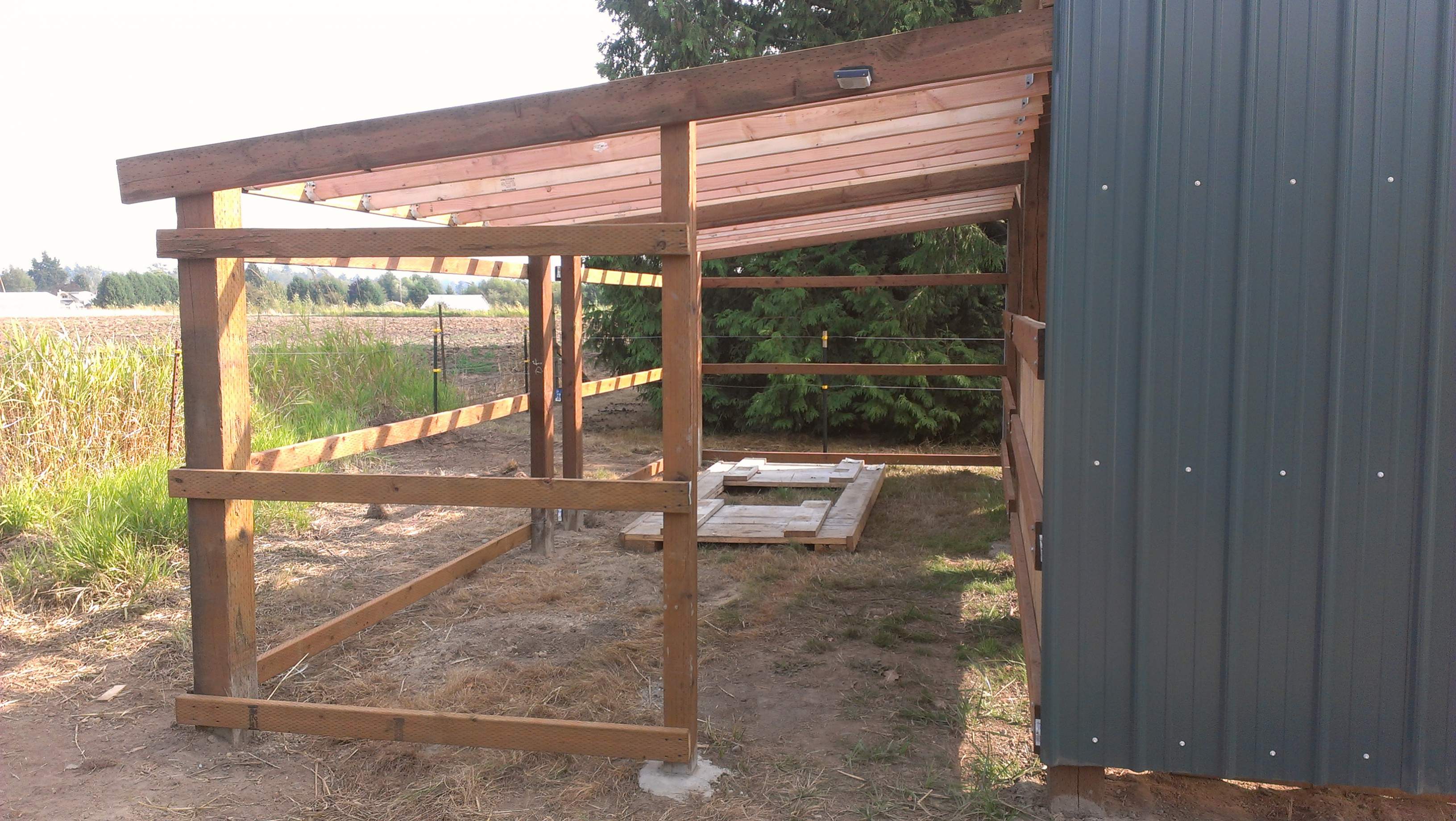

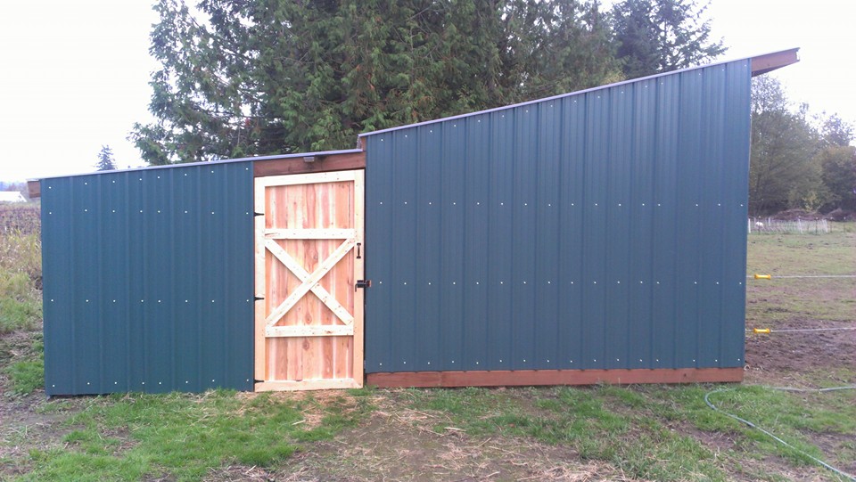

What is the 16" space for? Are you putting a wall between the stalls? I found that all five of my horses get into the same 12x12 stall together. I think they like being all squished up tight to each other.
I did that to avoid having to get a permit with final inspection. In my county, you're only aloud 120sq ft building for a horse shelter, without a permit. So I made two next to each other with the space between to add square footage. I'm just not going to add a wall to divide them, and only join them with the metal roofing material. The lean-to will be considered AG, and doesn't need a permit. For some horse hating reason, horses aren't considered AG in my county.

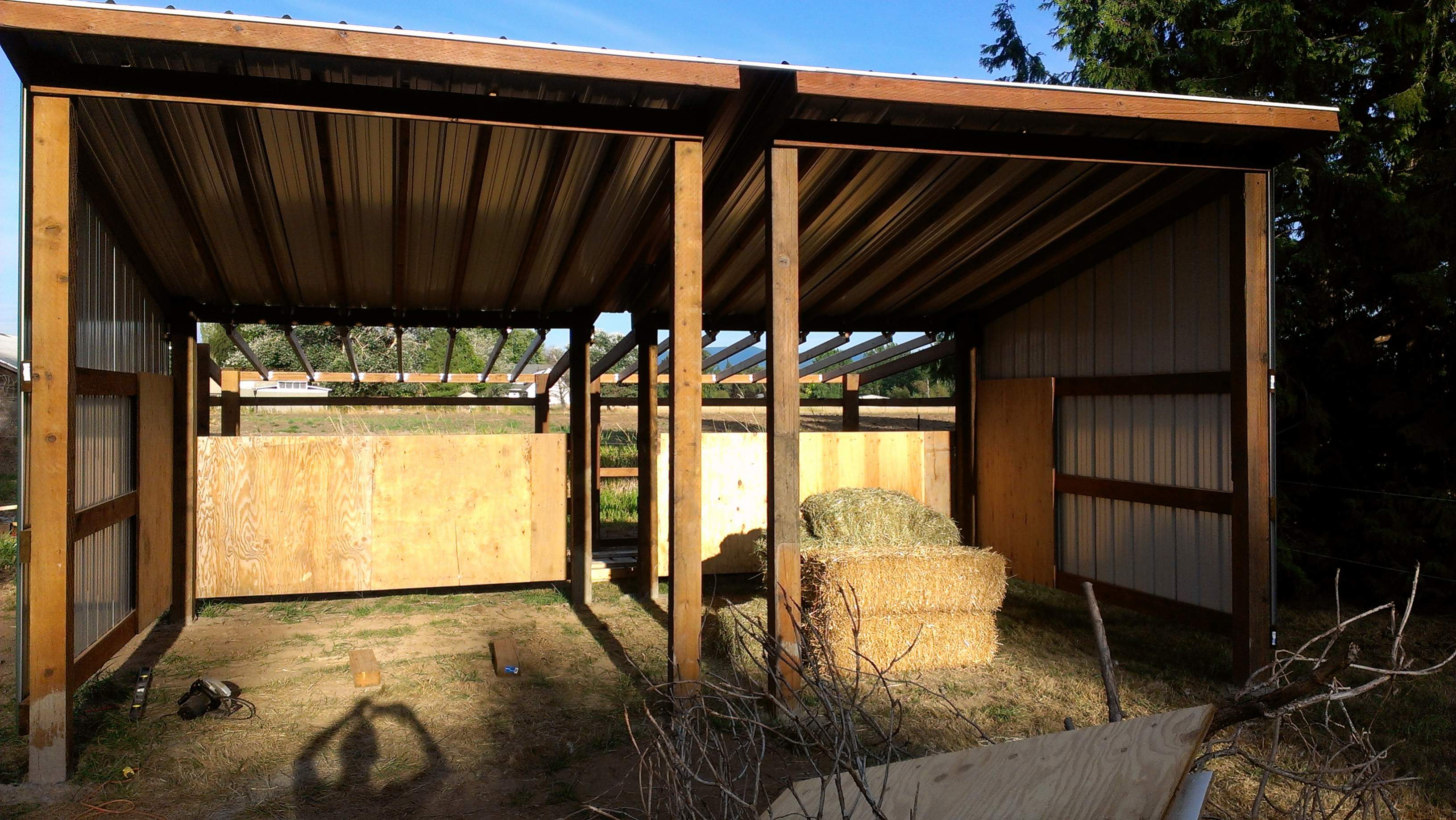

Not trying to be picky, but you may want to put boards on the interior so a horse can not kick the metal siding.
Metal siding and horses really do not mix. A friends horse got bored and put it's leg through 2 weeks before High School Rodeo finals, the horse is now a lawn ordainment. The poor girl was a senior and made National finals Rodeo on Poles and barrels, and had to drop out.

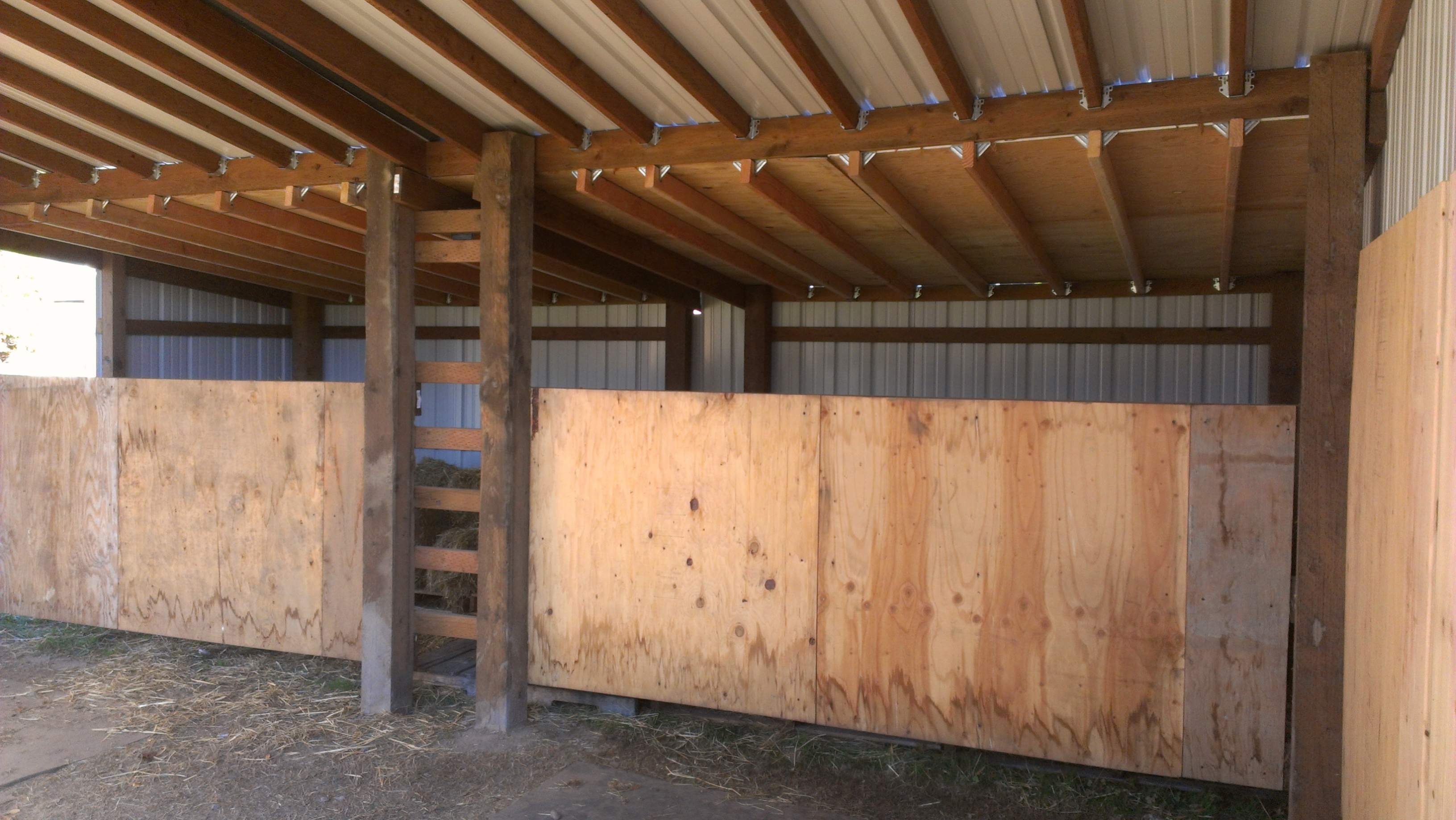

Ha ha! You're not the first person to say that. I started cladding the inside a few days ago with 7/8" plywood (had it on hand and should be plenty strong). The area that what I had didn't cover, will be 2x12's or 2x10's, whatever works out to be the cheapest. I have a good method for keeping them from cribbing on all this too.
As for the girl and the horse... that's a huge bummer. Totally unfortunate. I hope they both recover from this in short time!

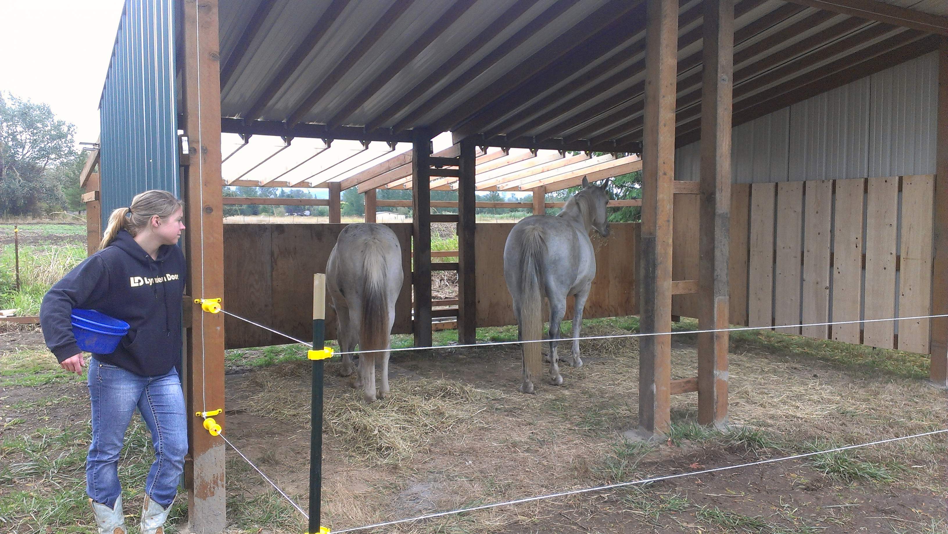

Got the horses in the barn! The way I ran the hot wire is temporary, as fence will be changing a lot in the next few months. Anyway, this made my beautiful wife VERY happy!!

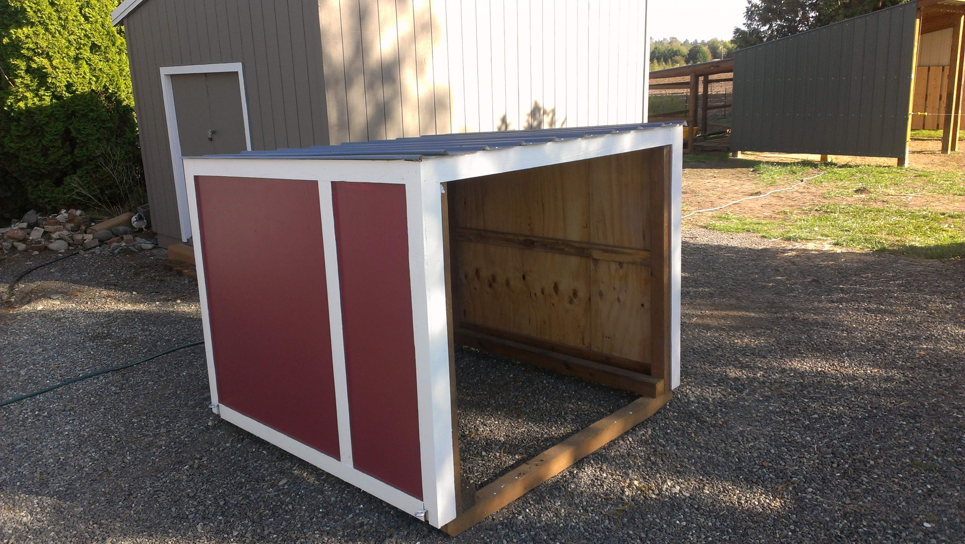

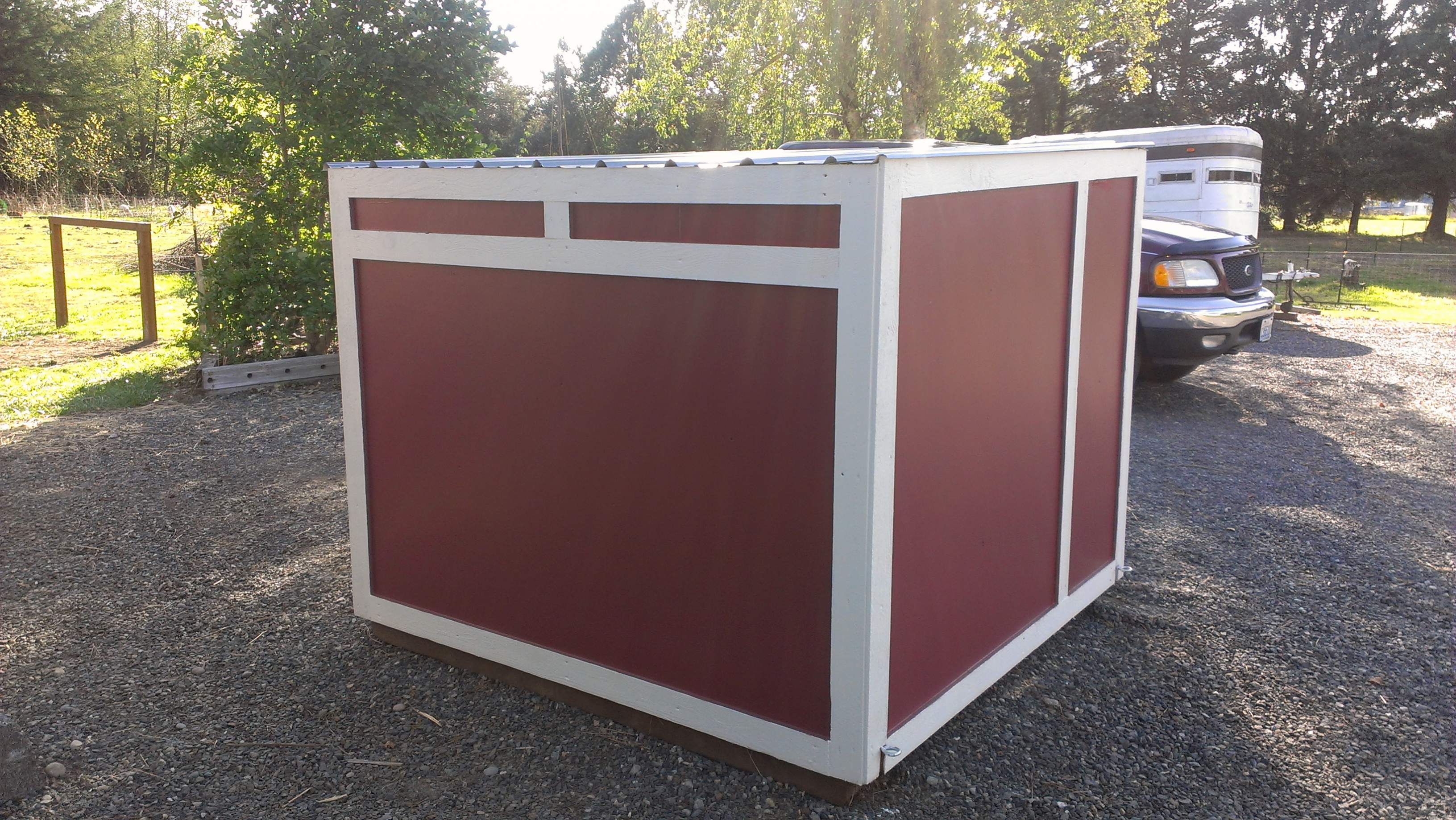

I know it's not related to my barn, but I just finished building our goat shed (6x6x5.5 high). I put it on skids, so I can drag it around with the tractor as needed. Once we get back from vacation in two weeks, I'll finish the barn. I got the roofing done on the hay side, and am just waiting on the siding. After that, I'll be building the permanent goat pen. The projects never end.. Ha ha. I thank the Lord I enjoy this stuff!

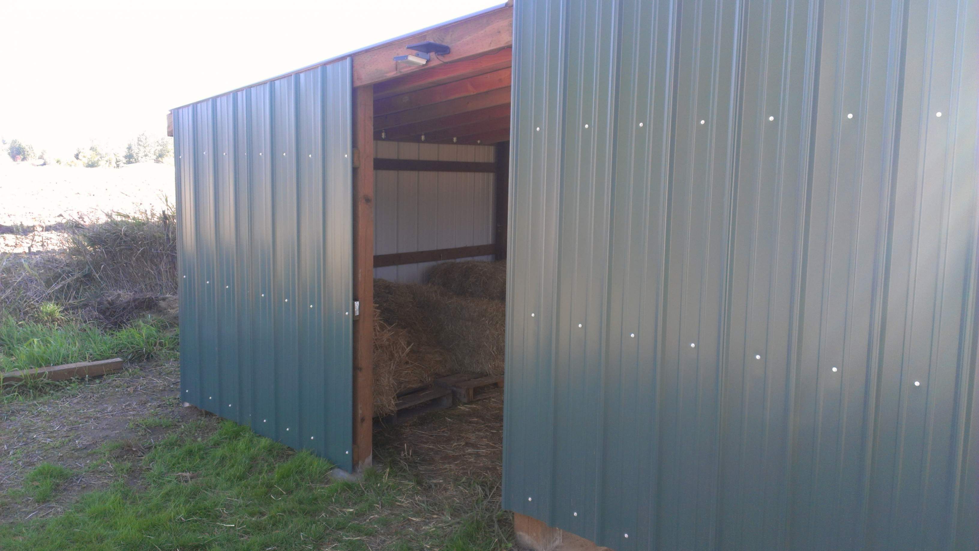

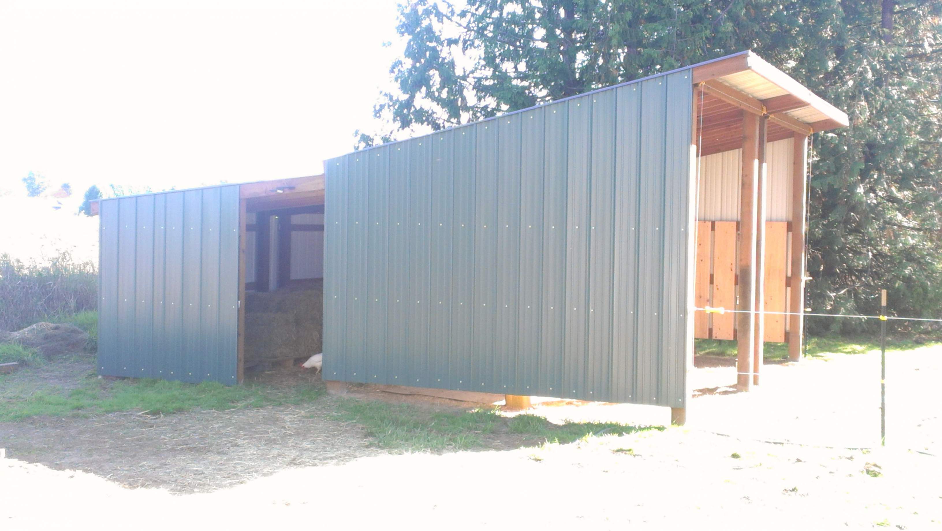

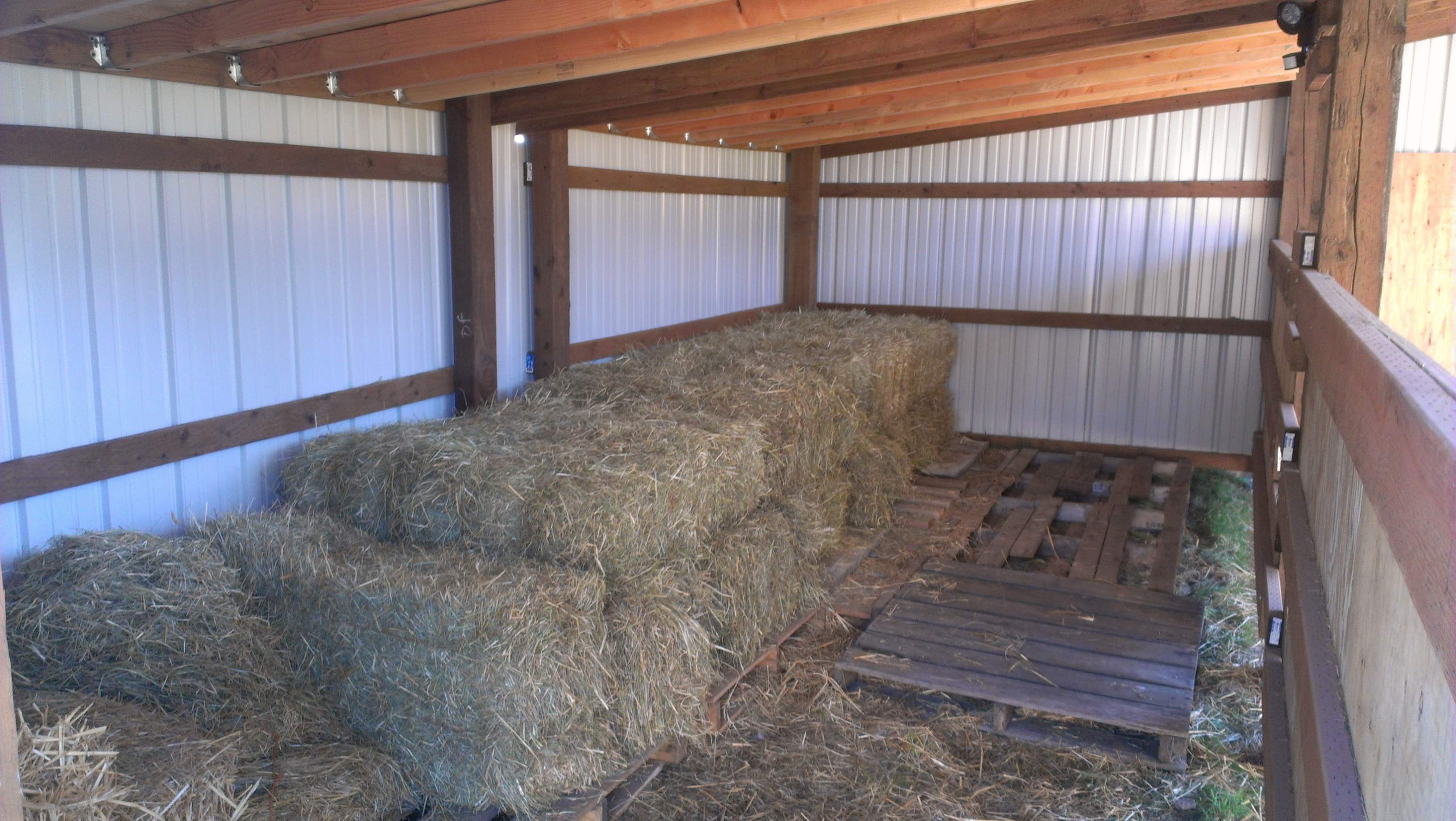

Other than some odds and ends, I have it just about finished! It'll fit around 80 small bales. I ran out of screws for the siding, and want to build a door for the side entrance, but I'm pretty thrilled with the outcome for today. I'm also really impressed with the solar lighting. It beats the cost and labor of running electricity out there.

Just as a side note: This only cost us $2800 to build. Building materials are really expensive, but if you shop around, this can be done on the cheap! The horses and my wife are very happy!

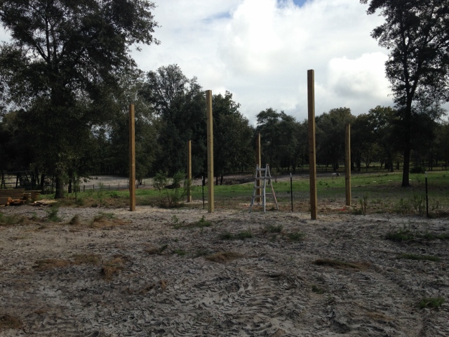

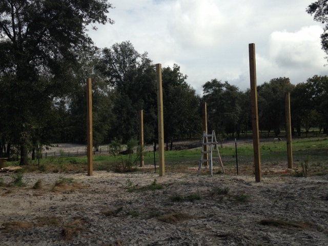

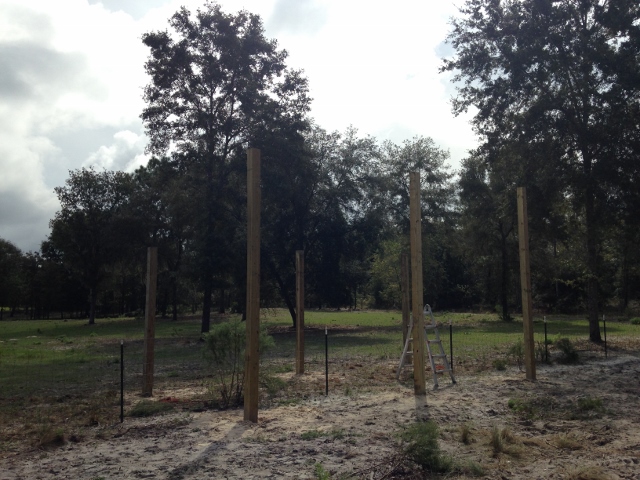

Well, your shed made me start on one for our horses, mine is 12x24 inside wit a 16x 27 roof. I am also splitting the fence line between 2 pastures with a movable gate depending on which pasture they are in IMG_0796 (640x480).jpgIMG_0797 (640x480).jpgIMG_0798 (640x480).jpgIMG_0801 (640x480).jpgpoles 1.jpgpoles 2.jpgpoles 3.jpg We are just starting ours, hope to finish by the end of the month

Just a few finishing touches: Built a door for the side entrance, and added 2x6's on the bottoms of the stalls. I spooked our gelding walking into the hay side while he was eating, he freaked out, fell on his side and got his leg stuck under the 7" gap on the bottom of the wall. It screwed up his leg pretty bad. We're very lucky he didn't break it. He seems to be recovering pretty good now, thank the Lord!!

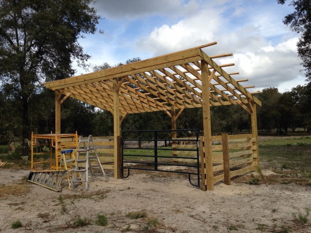

Well this is how far I got yesterday with the roof going on next Saturday. We are only putting siding on one corner I think.
IMG_0857 (480x640).jpgIMG_0858 (640x480).jpgIMG_0861 (640x480).jpgIMG_0862 (640x480).jpgIMG_0869 (640x480).jpg
Corral measures 12 x 24, roof line slightly larger, with gates on opposing corners hope to clean with tractor
