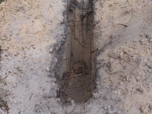

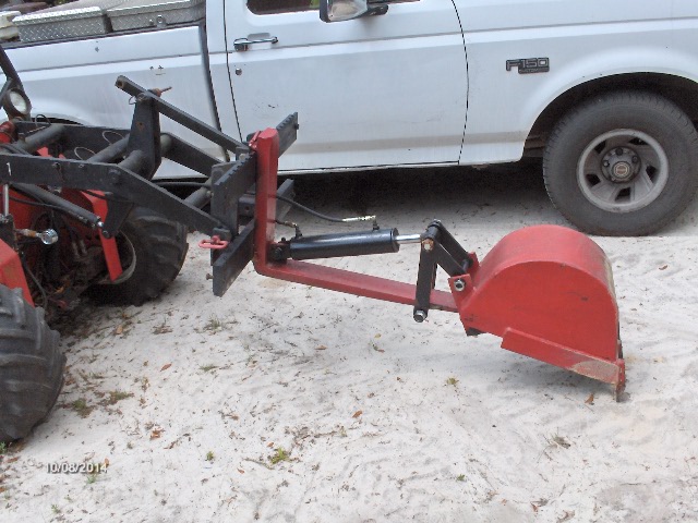

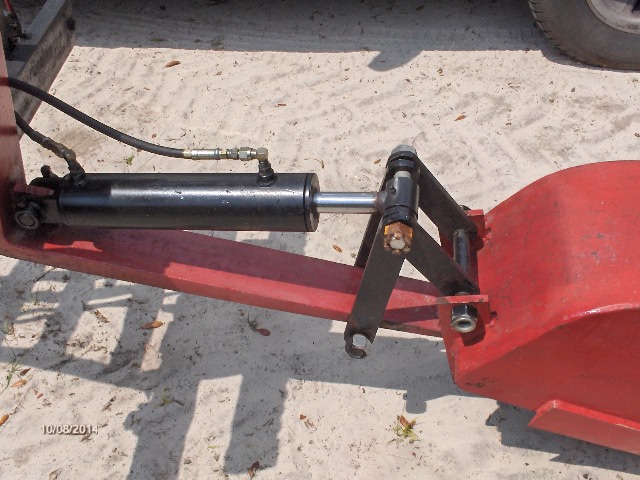

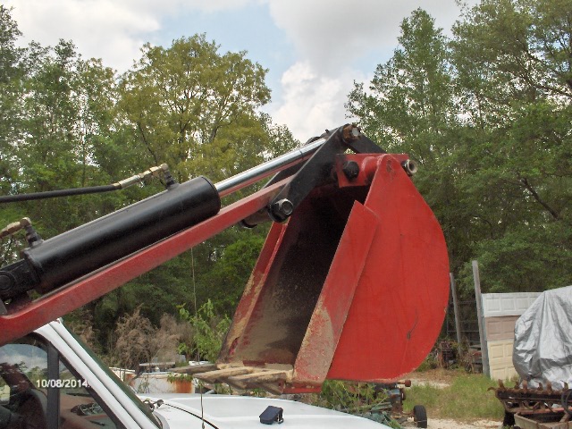

Have you ever seen one of these?
I built this just to see if it would work, and it did quite well.
I used a fork tine as the base and welded the pin mounts on the tine. The pictures show a 16 in bucket, and there is a picture of the hole I dug.
Fairly inexpensive, using a spare fork tine, a cyl, bucket, pins and brackets.
And yes, I know the cyl barrel is touching the fork base.
With my Power-Trac, I can turn the front end to dump.

I have seen them for skid steers but I have never seen one mounted to an articulated loader before. I would think it would be easier to operate witn an articulating loader than a skid steer.
