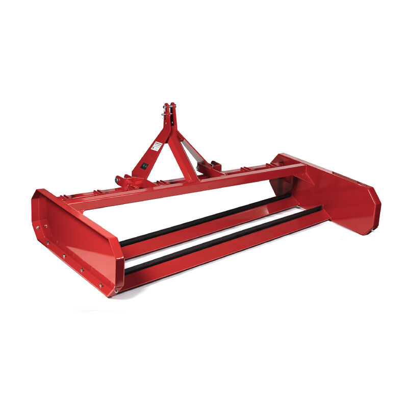

I just want to say when you are looking at gravel driveway maintenance you might want to consider a land leveler (aka grading scraper) in addition to a box blade. It is way easier to use and gets outstanding results.
The relatively short blades on the scraper collect material quickly and then the small stuff floats and pours over the top of the rear blade in a nice even layer. When you hit a dip or pothole the larger stones which stay at the bottom of the blades drop into the holes. My driveway has never been this smooth.
Of course, I am not sure I have seen one of these smaller than 6ft so it will take a heavier tractor.

I just use an 8 foot grader blade with end caps. It's nice, but does take a larger tractor than we are talking about here.
That land leveler just above this post also looks like it would do a nice job - but he has a 50 hp tractor.
