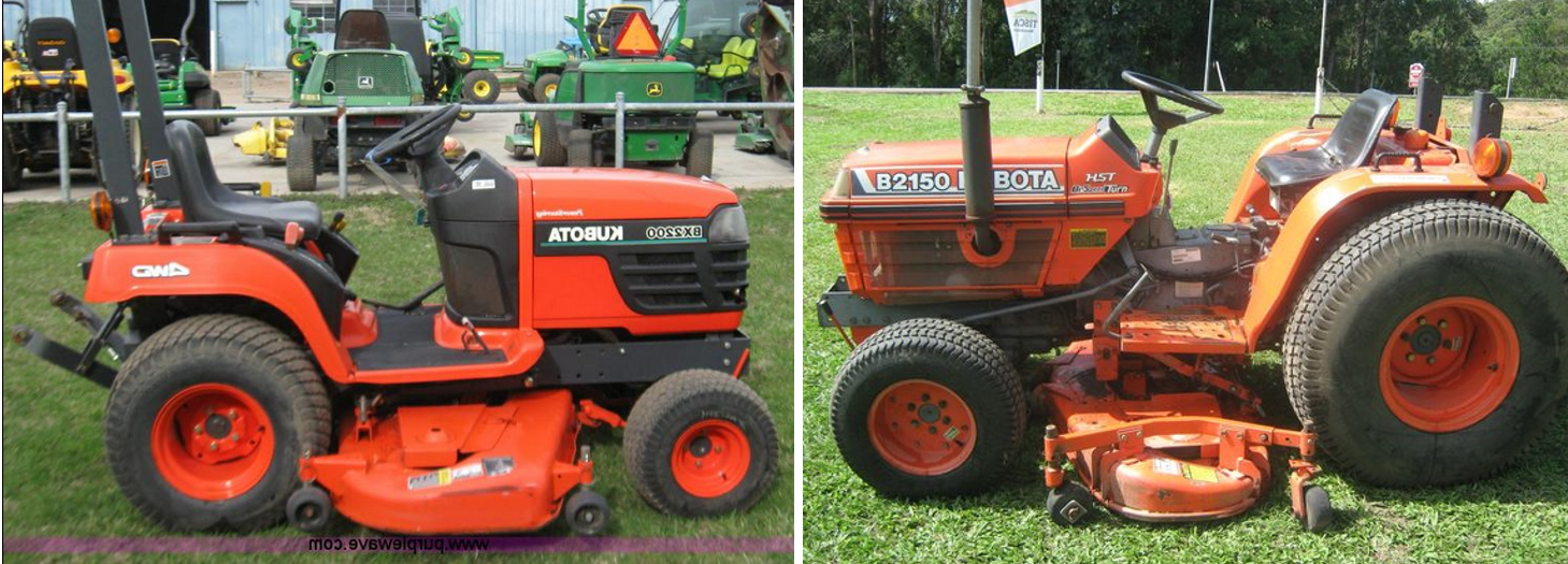

Airbiscuit -- that is a great Youtube find -- super educational w/r to Kubotas in that size range.
JWR,
You own both a Kubota BX2200 and a Kubota B2150. Perhaps you can give your firsthand experience about the difference in their capabilities, and what You would recommend?
