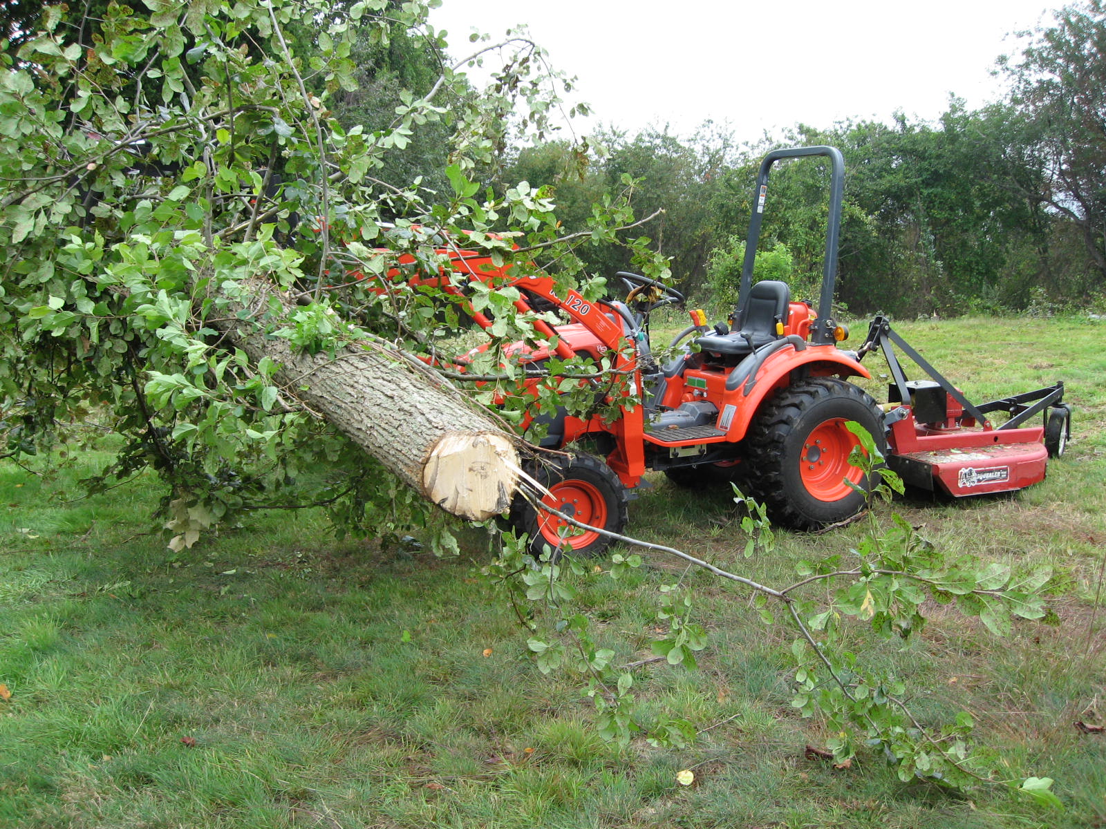

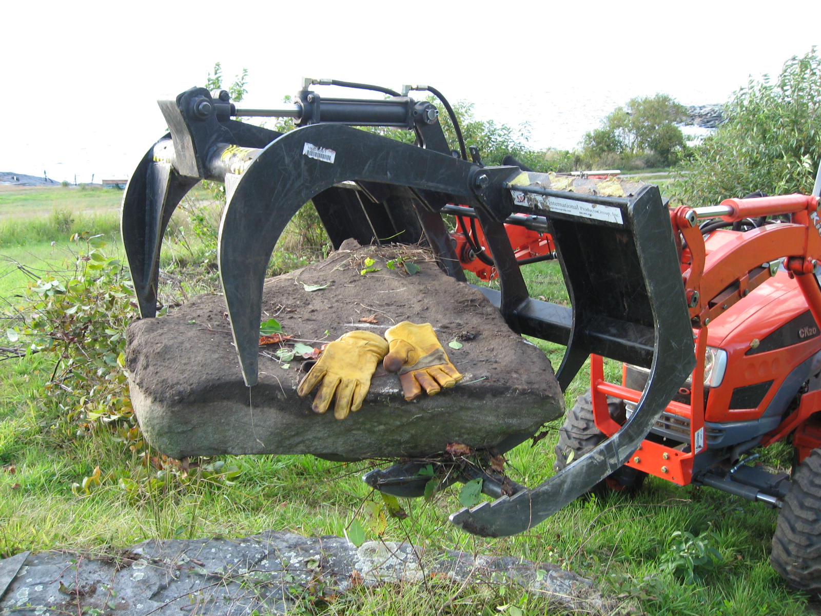

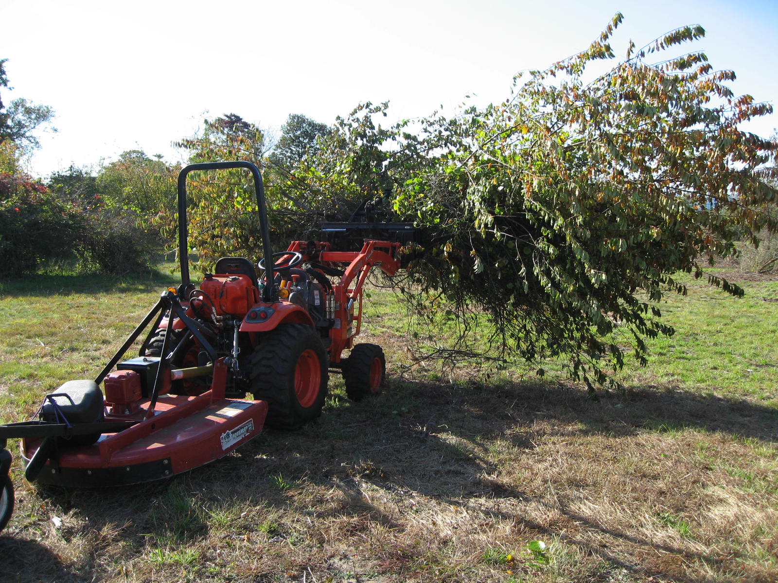

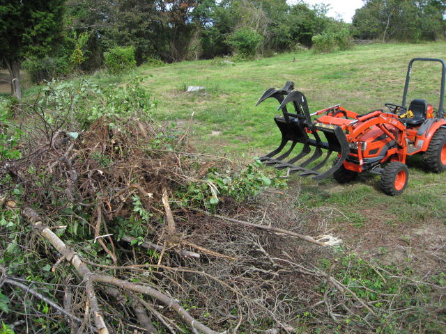

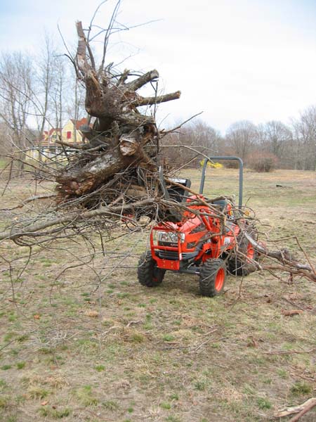

Your initial plan was correct. The 48" "light" duty root grapple is very versatile and I don't think you can hurt it with a CUT loader. I completely agree that a larger grapple offers very little except to decrease your payload weight capacity. I've posted a bunch of photos over the past 9 months but here are a few relevant to your stated uses:
