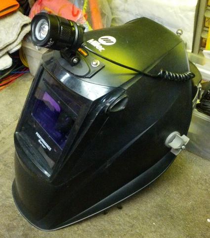

Yes cheater lenses inside helmet ... I have a 2 diopter in mine and sometimes wear my reading cheater also....Also a lot of external ambient light on area to weld helps... Put a headlamp on welding helmet to light your path...
