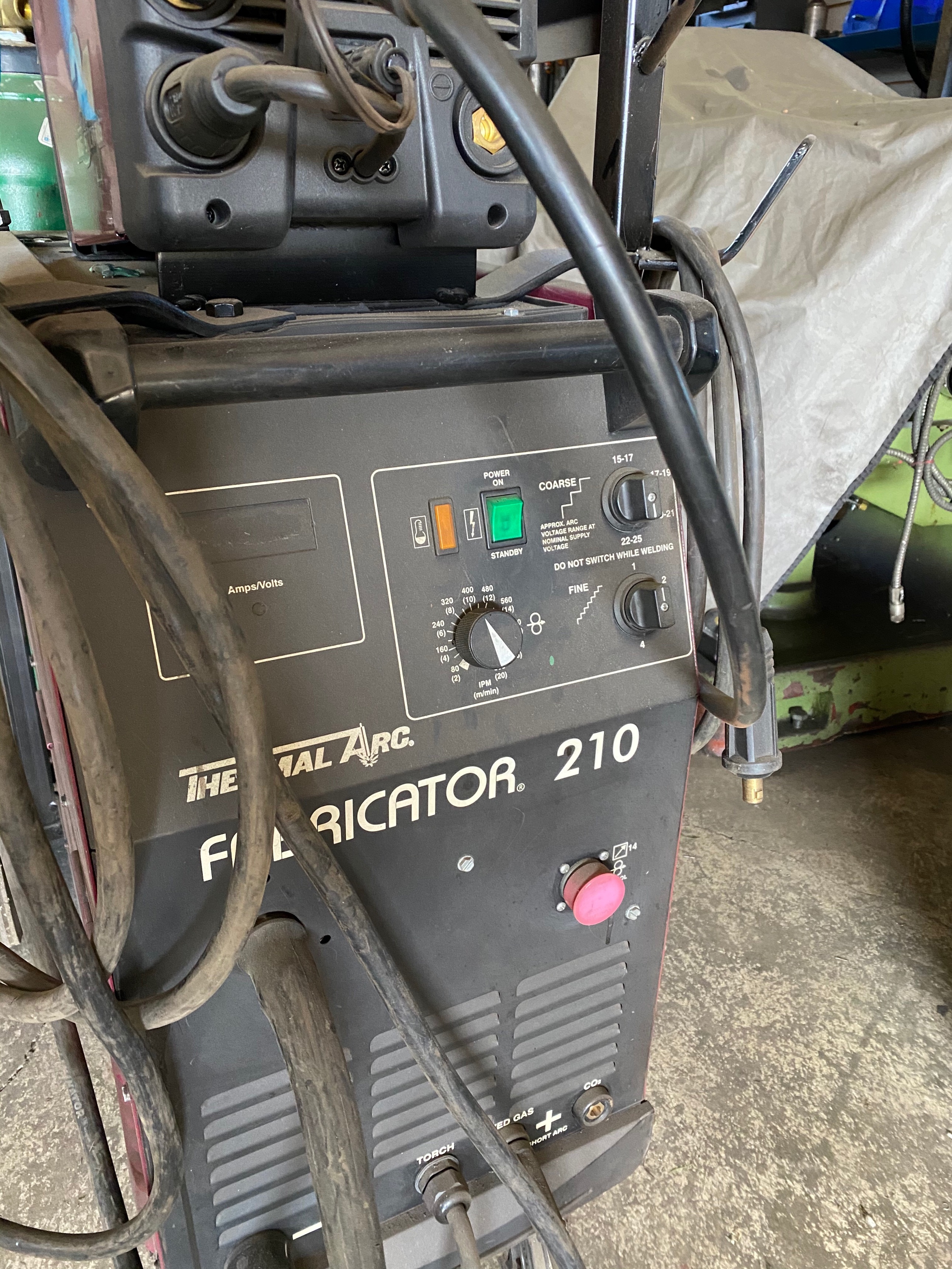

Stepped settings aren’t a big deal to me. On this Thermal Arc Mig the wire speed knob only gets REset when I bump it accidentally reaching for the power switch.
Plus I’m much too lazy to figure out what knob settings do. I just adjust torch angle, stick out and travel speed or weave pattern to compensate.
This Thermal Arc was purchased new 21 years ago BTW. Although I have arguably “better” MIGs this is my go to for light fabrication.
Edit. The above quote was from Steve /BuckitCase. Sorry. I must have screwed something up.
