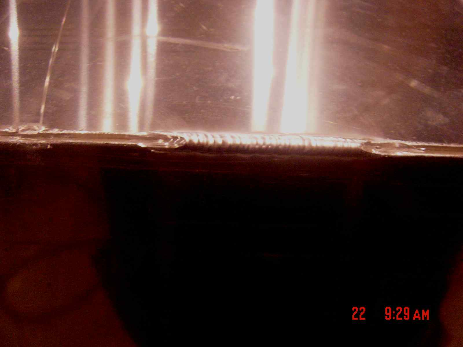

/ Millermatic 140 for bucket hooks #3
Couple things that may help. Sand all the paint off the bucket in the weld zone. Tack everything in place. Take a grinder and feather the tacks. You want a little ramp on both sides of the tack. Depending how long the tacks are, I'll either run completely over the tack with the weld. Or stop right on top of the tack. Then pre-heat with a weed burner, before welding. Always feather the stop, and start of a weld, before making the next weld. Try to always leave the stop of the weld in the center of the object being welded, never on the end or edge. Sometimes this just doesn't work out though.
If you're running gas, 100% CO2 will be just a little hotter. Or run some self shielded flux core.

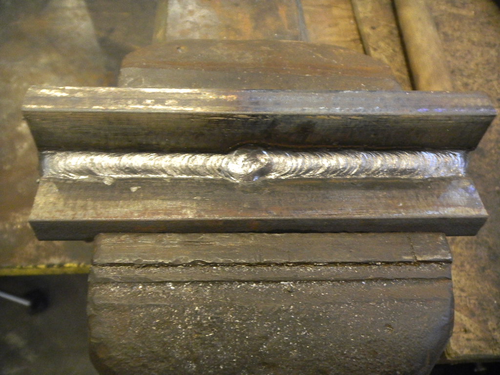

/ Millermatic 140 for bucket hooks #4
Sheild arc will you please explain feathering the start and stop. Some of us newbies might not understand. I always have a bump at start and then end just flows out. But also never had any formal training on welding just picked one up and quite when it held usually try to over do it on repairs and they normally hold.
/ Millermatic 140 for bucket hooks #5

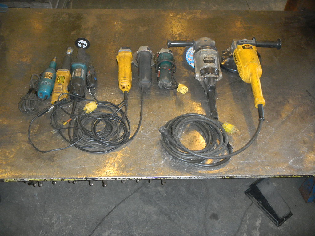

I like to take a die grinder, 3rd from the left in the first pictures, feather the start and stop of the weld, as in the second picture.

/ Millermatic 140 for bucket hooks #6
Ok. Shield Arc I see what you are doing to get your taper. I thought you was doing it with the welding rod during the welding process.
Nice assortment of grinders you have there. Never seen electric die grinders only air.
/ Millermatic 140 for bucket hooks #7
All four of the grinders on the left are die grinders. Personally I don't like to use air tools around objects being welded. Sometimes they'll spit a little oil on the weld zone:mad:. Plus I don't run my compressor unless I have to. I've listened to enough noise in my life:rolleyes:, so I like it quite as long as possible.:D
