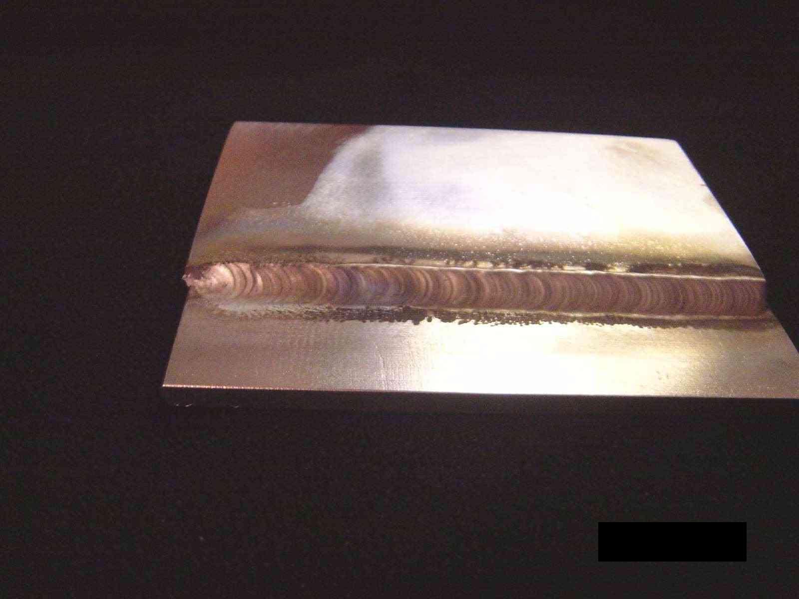

I have not looked into the multimatic at all, but from what you guys are saying it sounds like a scaled down version of the xmt machines. Only with those you had to buy everything separately- tig torch, wire feeder, stick leads... etc. One thing to check is whether it has ac tig function. The xmt did not (at least not most of them). I have never tried but it is my understanding that you cannot weld aluminum with dc tig.
   / Miller multimatic 200 - Jack of all trades or Master of None? #18
Sure you can, here is an aluminum Tig weld on DC.;)
   / Miller multimatic 200 - Jack of all trades or Master of None? #19
well I guess I stand corrected. I will have to try that one of these days- next time I have an aluminum project. I am not really even very good on AC so that may be interesting.
   / Miller multimatic 200 - Jack of all trades or Master of None? #20
Don't take his joke too seriously. DC TIG aluminum welding is technically possible but virtually no one does it. You need the AC for cleaning and perhaps other reasons. Same basic issue with oxyfuel and aluminum I think. It is certainly possible and was done routinely before AC TIG but no one in their right minds would do it routinely.
