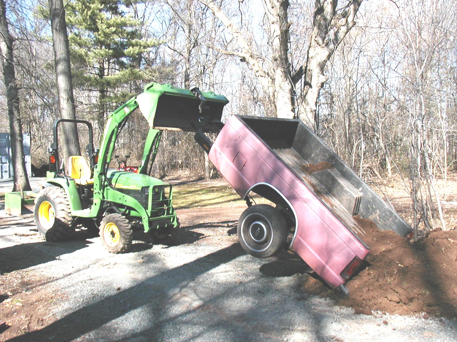

Hey, that looks like mine I built 8 yrs ago......same concept for dump...sometimes (when the terrain is right) when tilted, you can back more and the trailer stands up on end to dump
Yea, it would be nice to dump like a normal one but it suits my purpose, besides if it was hydraulic it would probably break down when needed anyways....
If I was to convert it to hydraulics then I would definetly use a hand pump to manually dump....

From experience, if you were actually gonna dump dirt, you will end up back there with a shovel. I don't know the degree angle but you need the tailgate off the ground and the ability to move forward and at the said angle in the video you will still use the shovel. You may have to lift the suspension.
Mini Kubota Tractor in the Spring Mud. - YouTube
Even with the super high spring over axle lift on my old dump trailer, because the tail hit the ground, I still had to mess around to get all the dirt out.
   / Military trailer turned into a dump trailer? #8
I have the solution for you, put a receiver tube on your bucket and make your own dump trailer.
JB

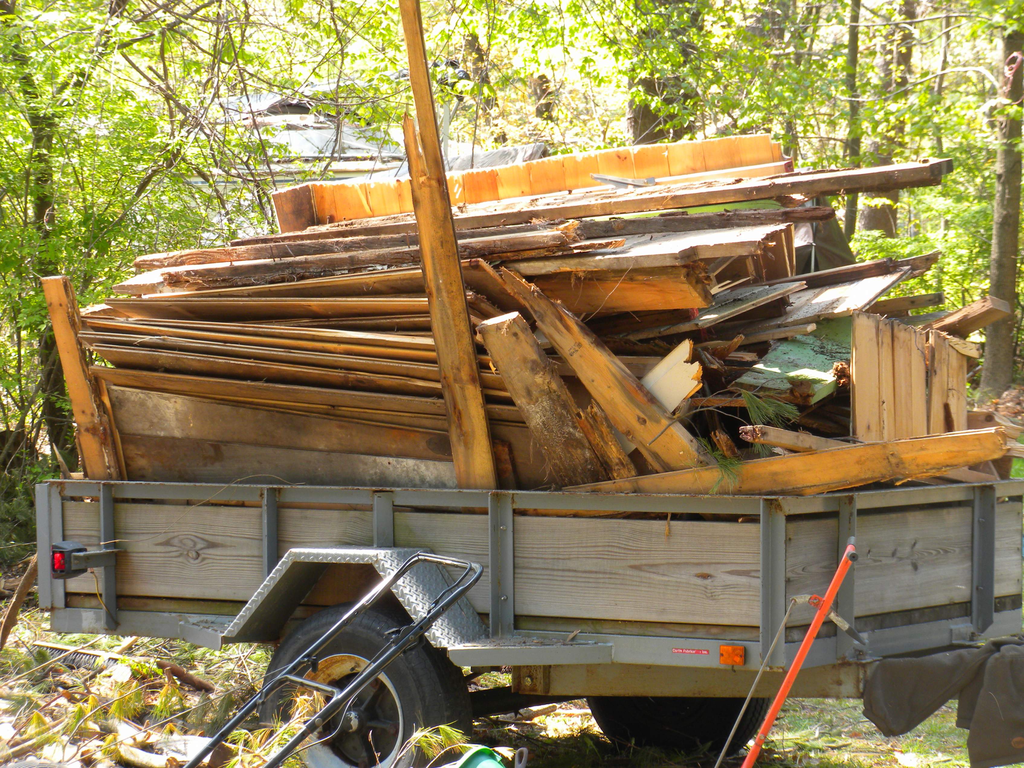

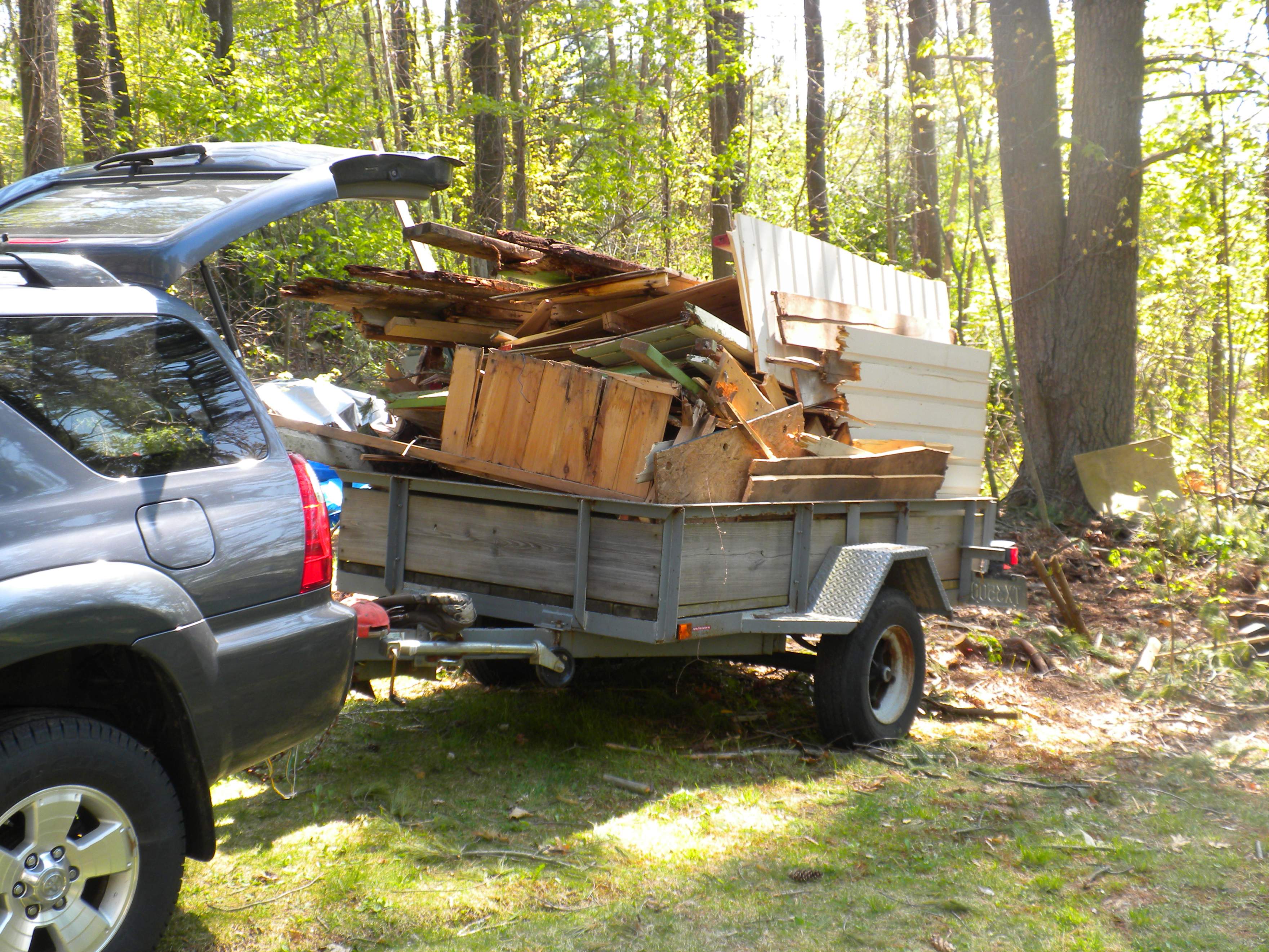

I can shoot some pictures of mine on Saturday and post them up so you can help figure it out.
the other guys are right.........unless you hinge it from the back it dosn't work well for dirt, but it works great for moving wood if that is your thing.
