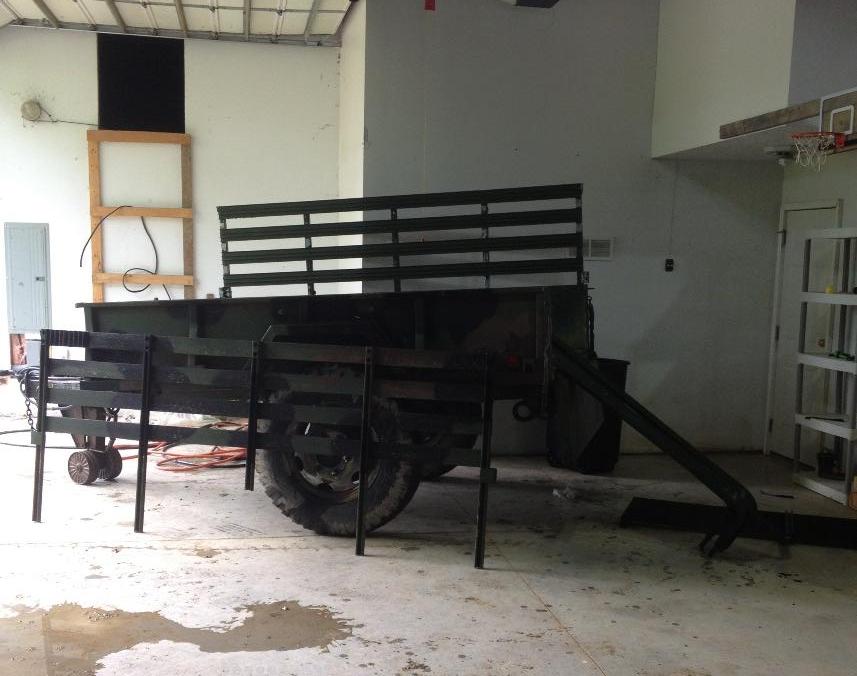

So, I had a M116A3 chassis (pickup truck size) that I wasn't really using for anything and a couple of M105's (2-1/2 ton truck size) that I don't use since selling the M35 that I pulled them with. I needed a "farm trailer" to pull behind my tractor and decided to take the bed off the M105 and put on the M116A3 chassis.
Here's the M105 being stripped down. I was surprised that all the bolts holding the bed on the frame came out really easy.
And here's the M116A3, that was only being used to hold an old paddle boat that was on the property when we bought it.
First I had to take the M116 outside and get the paddle boat off and out of the way.
So with the boat off, I took the M116 in the shop and stripped the genset mounting rails, tool box and fenders off of it.
With that done, it was time to put both trailers into position for the swap.

Once the bed was lowered onto the M116 I was really pleased with how it lined up and was looking. Being bigger than the chassis was
designed for, I didn't know how it was going to turn out or how good the wheel wells were going to line up with the tires.
All the mounting points for the M105 bed sit well inside the M116 frame and happen to fall between the cross beams of the frame as well. The front mounts hit on top of the front of the frame, but that will be an easy fix.
So with the bed down on the frame, I pulled it into the shop and got to work on it.
First thing was to pull the bed all the way forward until the rear mounts on the underside of the bed butted up against the rear of the M116 frame.
Then I raised the bed with the tractor so I could mark where the front mounts needed some trimming.
/ Military surplus farm trailer
Couple minutes with an angle grinder and cutoff wheel got the front mounts in shape to allow the bed to sit down flush on the frame.
I cut some pieces of 2" angle iron and welded the front and rear bed mounts to the frame.
I'll add some more at the middle of the bed later, I just had to get it good enough to haul a load to the dump the next morning.
And here it is all buttoned up. I was VERY pleased with how it turned out. Looks way better than I thought it would.
After taking this pic I pulled it outside and used the backhoe and a chain to remove that side board. It was jammed in there real good and actually picked that side of the trailer clean off the ground before it came loose. So, I know the welds are holding good.

Because it's WAY bigger, heavier and has no brakes (well, has air brakes). If you've ever seen an M105 in person, they are a BIG, HEAVY SOB.
Here's a pic of an M105 that does a good job of showing the scale.
And here's a pic of an M101A3 for scale.
By putting the bed on the other chassis, it is lighter, sits lower to the ground (although is still taller than I'd like) and has surge brakes.
