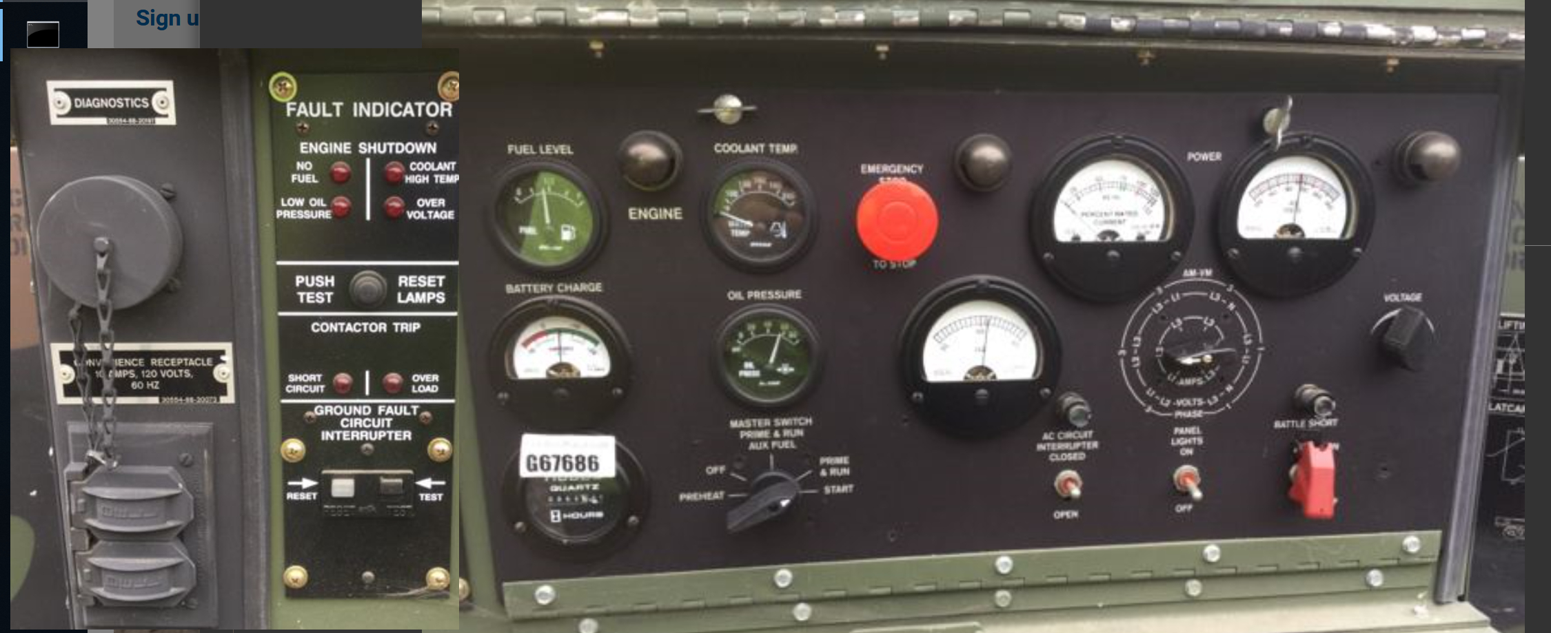

panel.jpgMine is a Fremont but motor is a common Isuzi Onan used all over the world, Emerson on the alternator, same design for years but yes new parts are expensive but lots of used parts. Whole forum of users out there, all WSM are only line. Really simply in a way no electronics any where just lots of relays. What I found interesting is all the relays has serviceable contacts. But your right some aspects like the aux fuel system. Separate fuel pump and filter and a tank level switch, tanks gets to 1/3 pump comes on and fills the on board tank. On board tank has own pump, filter, water separator. Any fault, temp, oil, load, shut the system down shows on the fault board. I love the battle start switch which means I need power NOW ignore all faults and run. Even the start circuit it won't start until it sees good oil pressure. However today's modern expensive do the same thing but all run through a logic board that just says fault and flashing code and is not probably field serviceable. With this style just jump the sensor back in service but the panel is cool.

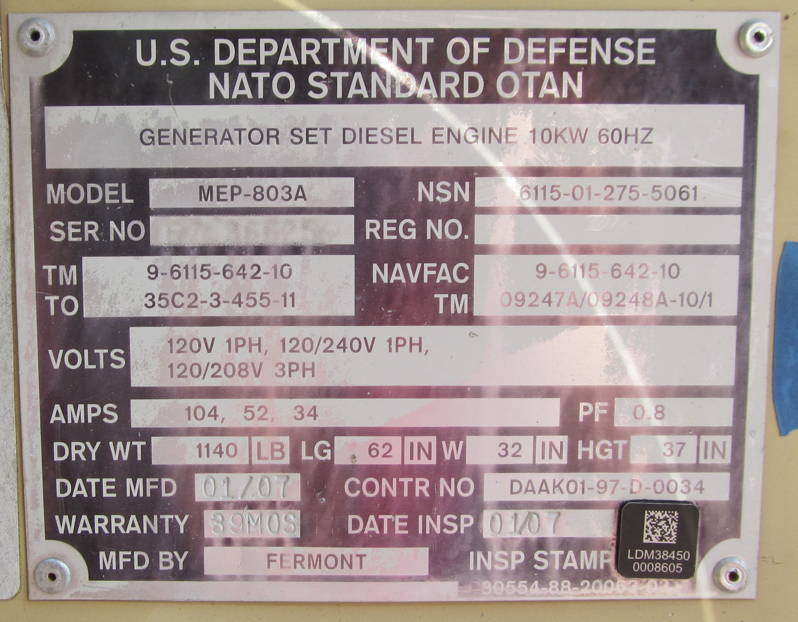

MEP-803A Bought at GL before the frenzy ensued. GL didn't do videos like GP does and all units were drained with batteries removed so it was a total gamble. I've seen crushed damaged units sell for double what I paid after the buying frenzy. I think most are being sent to Puerto Rico.
I've had a 10 KW MEP 803A for a couple of years. Great investment so far.
That 804 your friend bought is 3 phase only. The 802 and 803 are switchable between 3 phase and single.
You may want to join the steel soldiers forum. All the info and support you need for it over there.
The 802 and 803 are designed to run at either but they deliver less current in 3 phase. There have been people that try to cheat a 3 phase only and use two legs. Not only is it not a balanced load but it is only 2/3 output.
Here is the data plate on my 803. It delivers 104 amps at 120V 1PH, 52 amps at 120/240V 1 PH, or 34 amps at 120/208 3PH.
I have placed a resistive load of 13,500 watts and it held it fine. I typically load it to 10,800 for a couple of hours every month to keep it in good shape and make sure it will run when needed.
