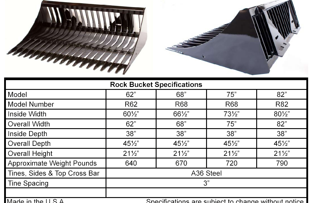

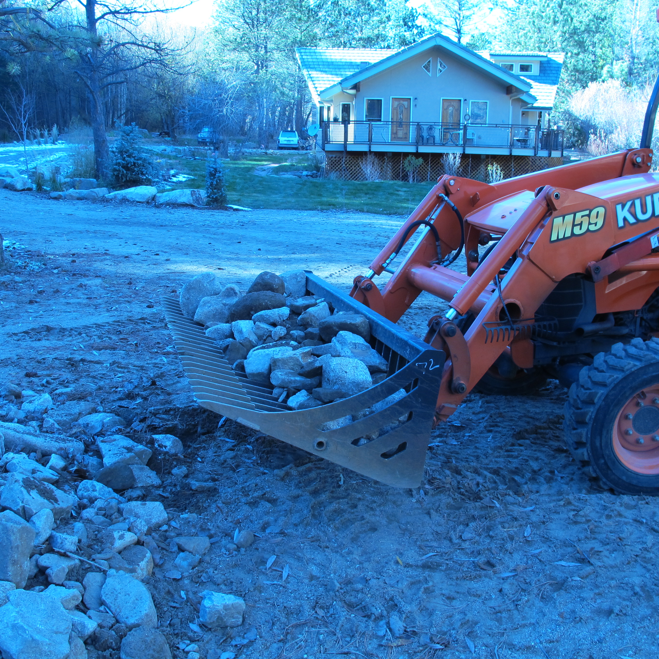

He said it works great on a skid steer because you can see better, not sure on a tractor.
This is true for sure. I also borrowed one to see if it worked. It worked marginally on a skid steer with a jazillion times better visibility and a half jazillion times faster hydraulics over a tractor to separate the scooped rock from the un avoidable dirt and organic matter (grass, alfalfa, etc.)
Your soils and the dampness will make a difference. Dry is good, sandy glacial till is good. I was dealing with just cleared land so roots, sticks and any weeds, grass all got in the way of "screening" the rocks out of the inevitable soil that you scoop up and fairly violent (fast) shaking of the bucket was required, at least for my conditions. In a nice - only so many rock situation on a short alfalfa field I'd bet it might just work better than tossing them in the tractor bucket. Borrow that rascal and find out:thumbsup:

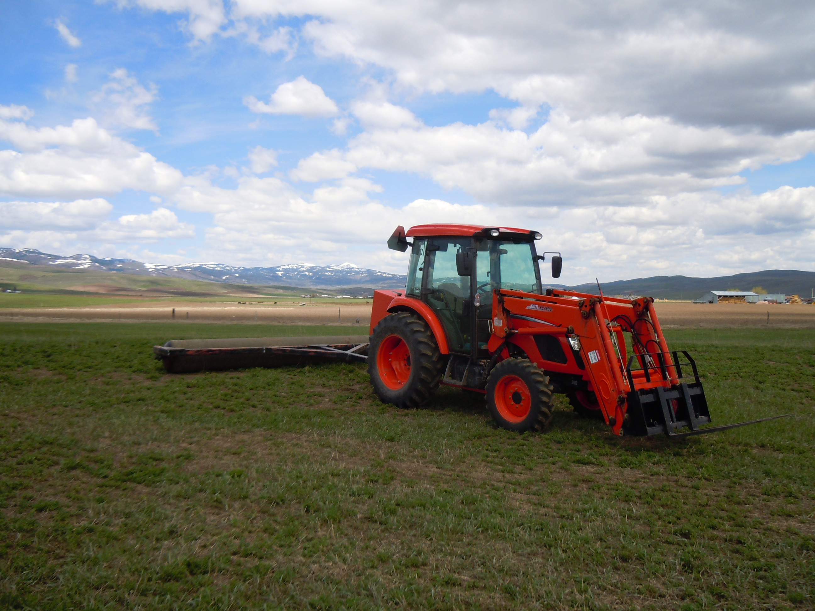

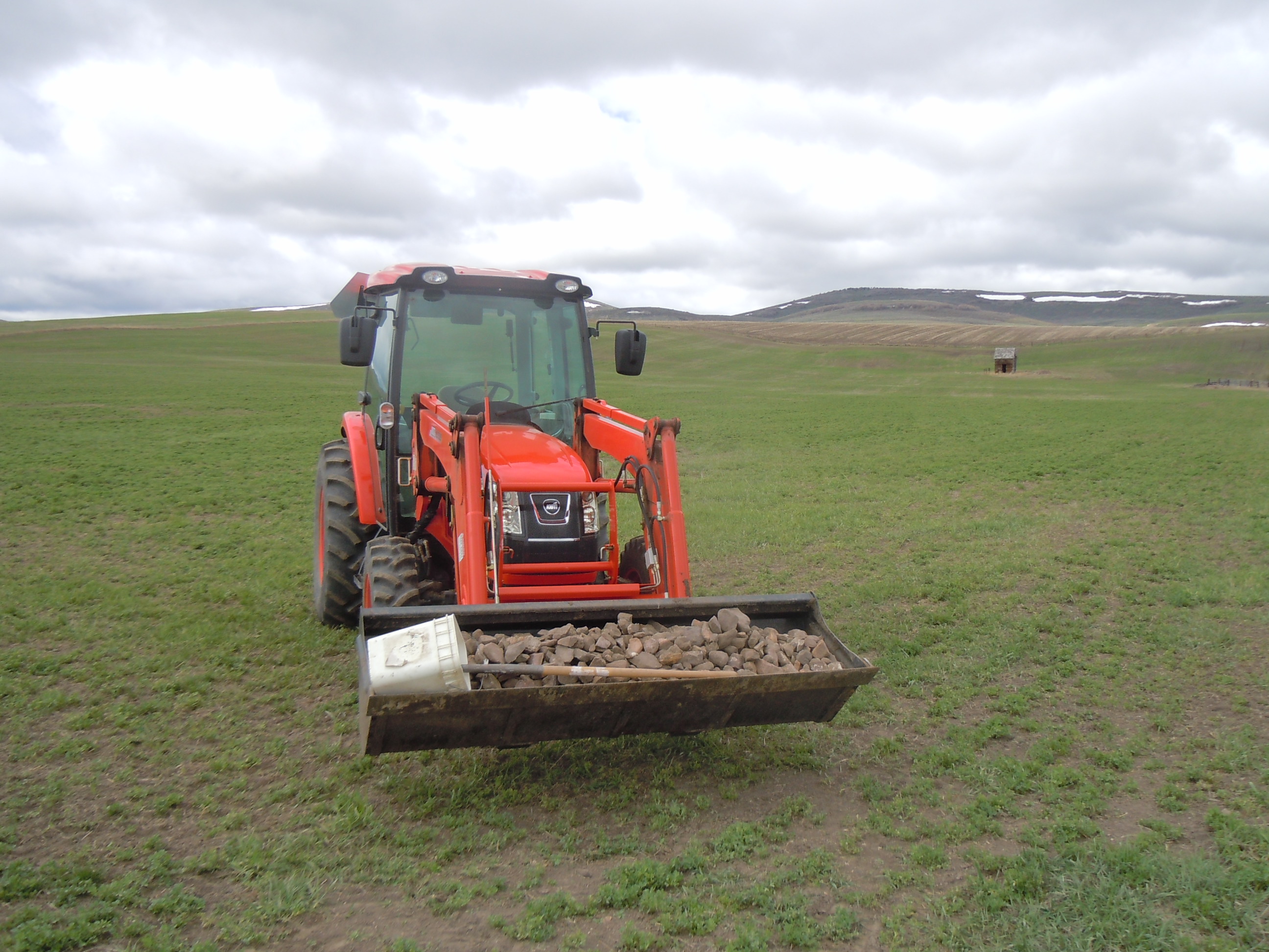

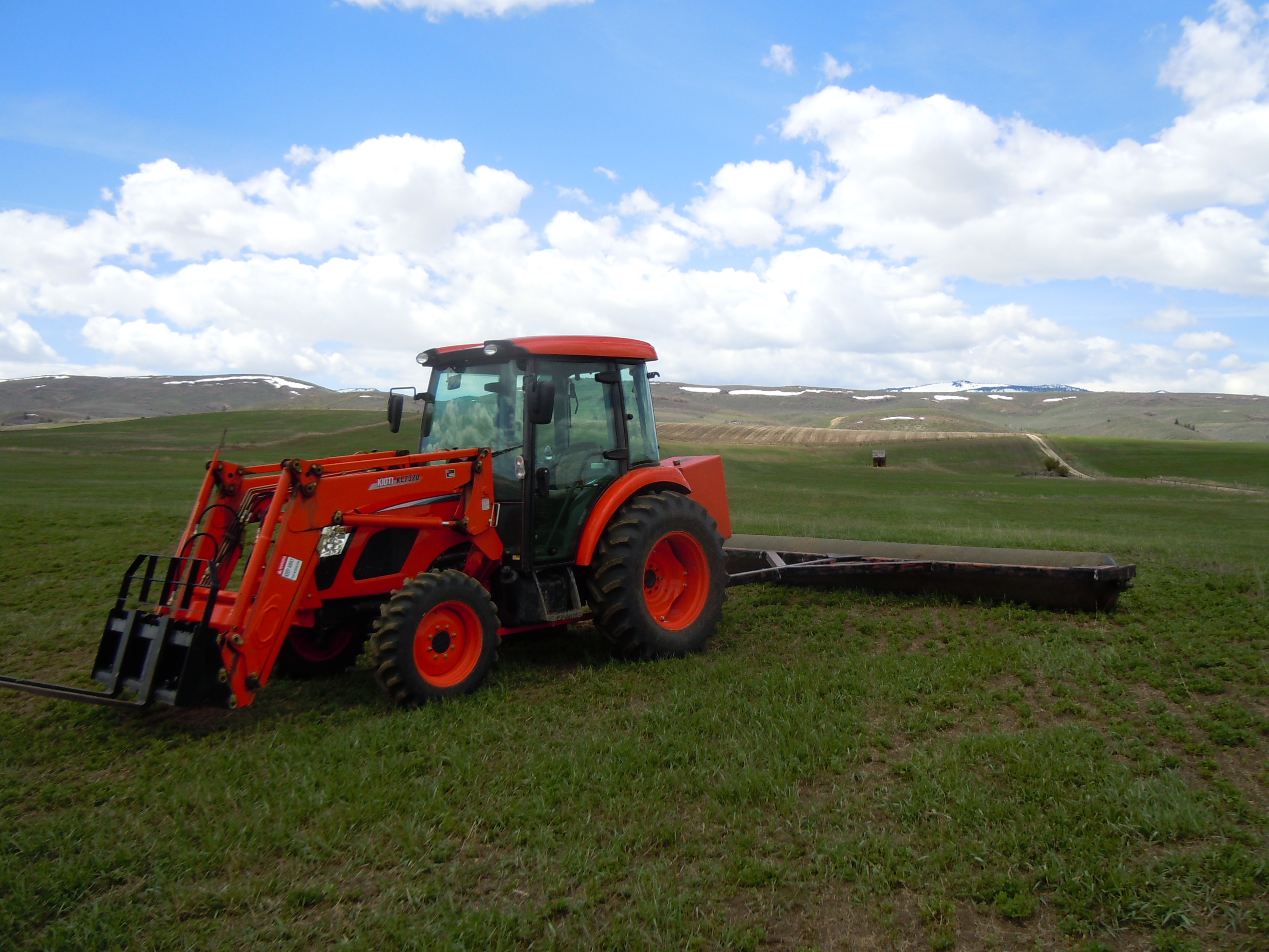

Got the land roller back together and finished rolling it out. It'll take some work but I'm gonna get all the rocks out of the field if it kills me, and it just might. :laughing: :eek:
Here's a some pictures.

As luck would have it, Wednesday it rained most of the day. The ground was still soft/moist so the rocks just pushed in like they should.:thumbsup:

Ya, so we picked rocks, many, many rocks before smashing them in. After I cut and get the hay out of the field I'll go around again and start picking more rocks. It may take a few years but I'll get then sooner or later. :laughing: I'm 56 right now and I'd sooner get them out while I can still bend over and do it. It sure won't be any easier when I'm 66. :eek:
The rocks are not evenly spread over the whole field. Some areas have none while others have a concentrated amount. My plan is to have the field harrowed again in the late summer/early fall so I have time to work on it for some time before it snows. Then again next spring. I'd just like the feeling of cutting the field without one concern of hitting a rock. :drink:
