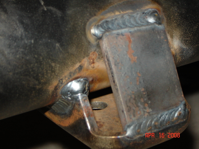

Attached is a pic of the spring seat & gussets I welded on a new Dana 60 rear (1/4" thick axle tubes, 3/16" thick seat & gussets) with a friend's TIG machine. He was watching the machine output gauge as I was welding & said I was running right around 220 amps.

dbdartman,
Are you sure that your friend wasn't looking at the input voltage meter? If this was indeed 220 amps that's a lot of heat. I've done a lot of tig and looking at the picture makes me think that this was a mig solid wire w/gas weld.
The beads look nice but a close look at the picture zoomed in reveals porosity in the weld at the end of the saddle and the ends of the bracket are undercut, especially the top far end. The tan spots on the bottom weld also indicate mig.
What shielding gas were you using?
Please don't take my comments as negative, this weldment would probably out last the drivetrain.
