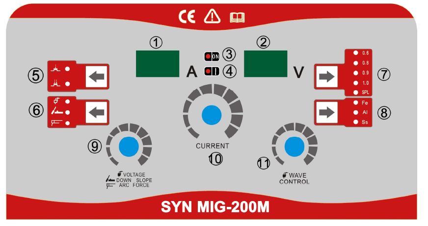

I've searched multiple ways and haven't found a satisfactory explanation, don't know if it's my search skills or there is not one out there?
I was welding over the weekend using a friends Simadre MIG-200M (supposedly called a Synergic Welder and it's controls are very similar to Everlast Power i-MIG 275S Synergic), and was puzzled by it's setup, as there is a setting for wire thickness, voltage, and current. I've read their manual and it's really basic, doesn't explain much other than where to plug in leads and what the icons on the front mean and do, but nothing about setting up. (Nor have I seen this in some other big name brand machine manuals I've downloaded.)
In playing with it's settings, it appears that wire thickness adjusts the starting wire feed speed, and knowing what little I know about MIG, being it's a CV (Constant Voltage) process, you set the voltage for what you're welding, but this welder also can set current. Take for example, Miller suggests for E71T-11 flux core on 3/16" with .035" wire to use 15.0 Volts and 210 ips as a starting point. Being the Simadre has you set the wire diameter, that is all I can do for wire speed, or so I think, without using a custom setting (which there is one).
So, this begs the question, where do you set the current and what is the rationale behind how it is set? Does setting that current to a value coupled w/ the wire diameter establish a wire feed speed by the welder to achieve keeping sufficient wire to keep an arc maintaining the requisite voltage setting? Some information implies that wire feed speed is control of current, so does a automated machine like the Simadre control wire speed to achieve the current set by the dial to keep a constant voltage as set by the dial? I'm good with that if so, and can adjust my technique accordingly just need to understand what goes on in the background.
I'm dumbfounded by these new machines, having done all my MIG using a fairly basic 4 switch setting & variable wire speed machine with pretty good results, I don't know the relationships and how to set up these new machines. I did quite a bit of test beads, but never really got what I'd consider as good a weld bead as with the old box I was used to. Hopefully, if someone can explain this it might serve to explain to me and others that have similar questions.

Uhhh...no. Simadre badly copies other original foreign and chinese designs, and who even knows if they have it working correctly. It isn't similar to the 275S. It's a good bit different size wise, operation wise, and factory wise. A lot are decent, but the warranty tells you all you need to know about them. From what you tell me, there was a good manufacturer that makes Thermal Arc ESAB products that had a quirk in how you set the machine that they copied.
IF you want to talk Everlast basic synergic machines, you select wire type and wire diameter. This creates an optimized volt/amp ratio. You adjust the amps and the volts automatically together as you turn the amp knob. This preset value is optimized based off several factors, but the settings can be fine tuned easily and overidden by simply adjusting voltage to reset a new volt amp ratio, which will be remembered as you readjust the amp knob.
Now, in Syn MIG mode, the unit reads in amps, because when a wire diameter is fed into the machine, the machine can then determine the amperage the machine will produce. In the standard mode, it will revert back to wirespeed when adjusting because the wire diameter is unknown, and it cannot compute amperage because amperage is a factor of wire speed, and the ampacity of the wire at that speed. Larger wires need to feed slower because of that to achieve the same amps of a smaller wire.
No, it does not determine the optimum wire speed or amps, because the metal thickness is unknown. Yes, you could enter that as a factor if the program allowed, but this unit is designed to allow some input from the user to be able to easily tune to his/her needs, so it does not take that parameter into account. By ignoring metal thickness (which is often unknown by the user) the unit defaults to say something like 80 amps and allows the customer to tune in volts and amps by adjusting the amp knob only. This feature also works with the spool gun, which allows the user to control both volts and amps on the dial on the spool gun on-the-go without going back to the machine to tune the volts further. The readjustments can also be permanently saved to the program of the machine. Get ready for a long confusing sentence...but read it through a few times: The arc force control controls the inductance of the machine which in turns controls the current rise time which dictates the stick out of the wire from the gun while welding, affecting the arc length, and overall feel of how wet or stiff the arc feels.

I looked up a picture of that machine. What is the left knob for, if not for wire speed? I could not read the word under the knob I saw.
This is from the manual, although the knobs on the machine I used were in different locations, all were present and labeled the same.
Here's some text from the manual on MIG setup:
ON MIG MODE
1. Gas choosing
...1) When the wire material is Fe, the shielding gas is 80%Ar + 20%CO2 ;
...2) When the wire material is Ss, the shielding gas is 98%Ar + 2%O2 ;
...3) When the wire material is Al, the shielding gas is 100%Ar..
2. Welding mode selection
...1) Set to be MIG mode
...2) Select the correct welding wire diameter (0.6--1.0). You can choose SPL, in which
mode that you can adjust the wire feed speed and welding voltage separately by manual.
Note:The current display is the wire feed speed (cm/min).
...3) Select the welding material (Fe/Ss/Al);
...4) Select 2T/4T;
3. Adjust Welding parameter
...1) Adjust the current knob to set the welding current, the corresponding welding voltage is
changed automatically;
...2) When the programmable welding voltage isn't perfect for the operator, the voltage can
be changed slightly by adjusted the knob;
...3) Adjust the wave control knob to better control the arc characteristics.
Note:When you select the SPL mode, you can adjust the burn back time inside the wire feed
mechanism.
Now, a something I noticed: When you trigger the gun free air, the wire speed starts slow for a second or so, then kicks up pretty fast (unlike my old manual box that is fixed), so.......... this gives me the implication that (and based on the text above) that you set the wire type/size, then the desired current for the thickness of the metal being welded, but this is similar to the 'slow run-in of wire' feature on the Everlast. Yes, Mark, I know it's not a clone of and I wasn't implying so, but looking at the controls they are strikingly similar albeit the Everlast does expose some more features.
I'll have a chance to spend some more time with it not under pressure to get a job completed, so I'll play more with setting it up and trying some beads on some plates, since I didn't have access to the manual when I used it last, now having the set up info maybe I can learn more how it works. The more I read about Synergic control, the more I think I'll like it, but it will take time as it's definitely different than the 4 current setting box I'm used to, it was very easy to set up by sound, and this one may well be so, just need more time to adjust to it. Basically, I believe it's a decent machine, it definitely can lay a bead and weld but unfortunately documentation is less than admirable.

Got a chance to spend some time last nite with the Simadre and got some better results.
I set up per the instructions for it on some 3/16" with .030 FC - (set machine to .045 wire, see comment below) I ended up at about 130A/21V and midpoint on the wave control - when I attempted to run higher A and lower V following some of the charts, it just didn't have the sound I was looking for, it was much coarser bacon fry then the typical egg fry I like, and the weld seemed to stand too tall and not penetrate to my liking. The machine actually set up per the instructions pretty close to where I ended up, it's when I tried to follow suggested settings from a chart that it was disappointing. When I tweaked what the machine started from then I got a much better run. I'm still not done, but what I think I'm finding is that the programing on this machine may be a little different then some other brands. It was just surprising to run as high a voltage as what it (or I) seemed to be happy with.
The other thing I was doing was attempting to compensate the settings for wire size, the machine appears to be calibrated primarily for gas, and I believe flux core generally requires a little higher wire feed. Therefore, I was setting the welder for the next size wire than what I was using, but I believe I actually went the WRONG direction, I was setting for larger dia. wire which would lower the feed speed, but I believe I actually should set for smaller dia. wire (FC actually has less copper cross section for it's size than solid due to the flux being part of the diameter). So, next I'm going to go back and run the same tests but set up using the next size smaller wire, then tweak those settings and see where I get. So, using my .030 FC, I'll set up for .023 wire and see if it improves any.
Other than that, again this machine seems to be a pretty solid machine, the drive sets up nicely, the only other thing I'm still not quite sure on is the 'burn back' setting.

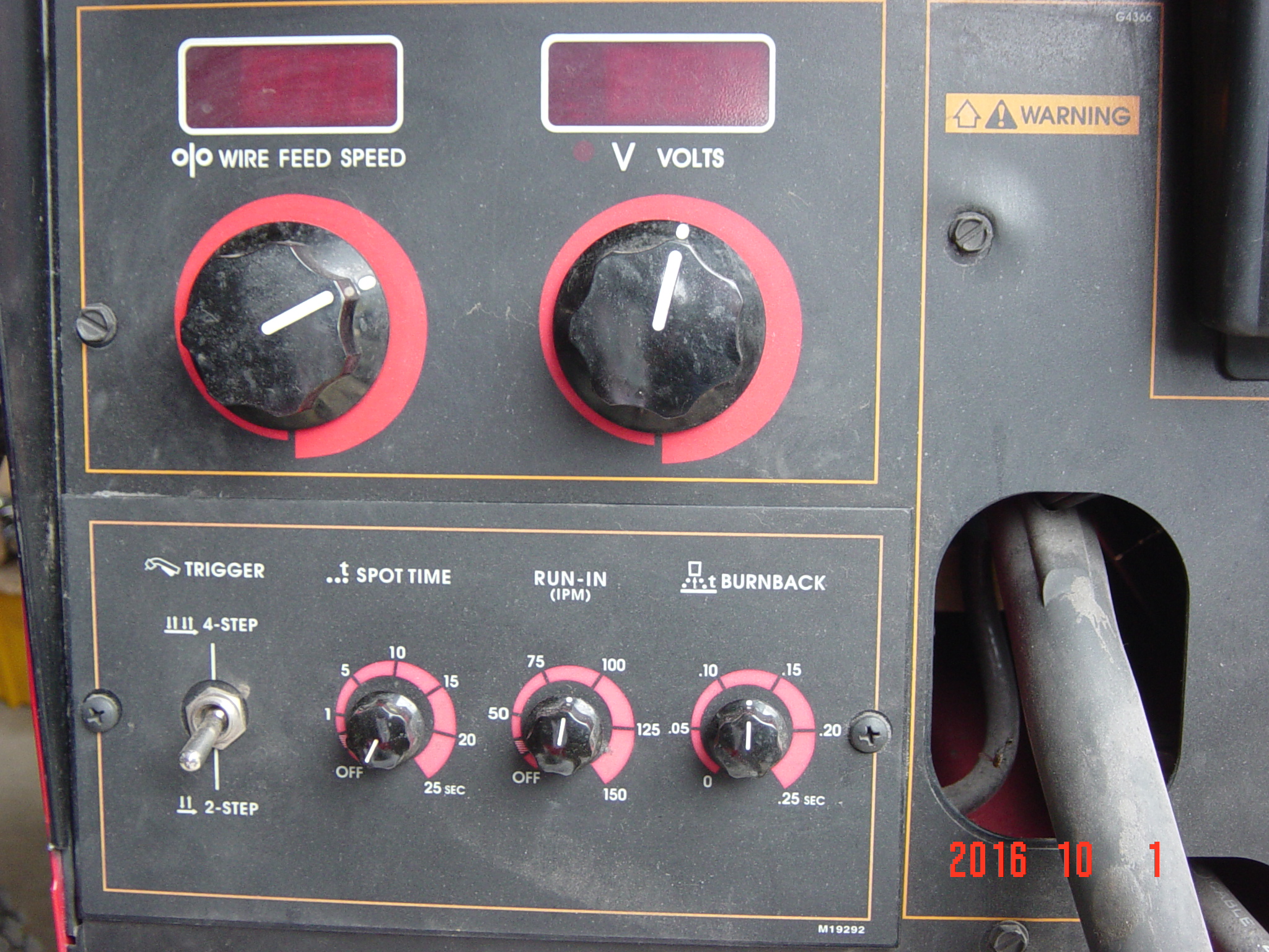

I'm not a welder by any means.
But friends of mine who are, and one has been for fifty years welding 7 days a week rarely adjust their settings unless something unusually heavy or light needs to be welded. They adjust their speed welding and I'm guessing that's easier then fiddling with the controls all the time. In fact, some of the machines are mounted so high and the feeders on booms, so adjustment on these machines isn't even easy.
I too have a Lincoln with all those EXTRA knobs including burnback. I at first tried to make sense of them, but so far have personally found no advantage to them.
At least Lincoln was nice enough to label the knobs rather then just meaningless icons.
