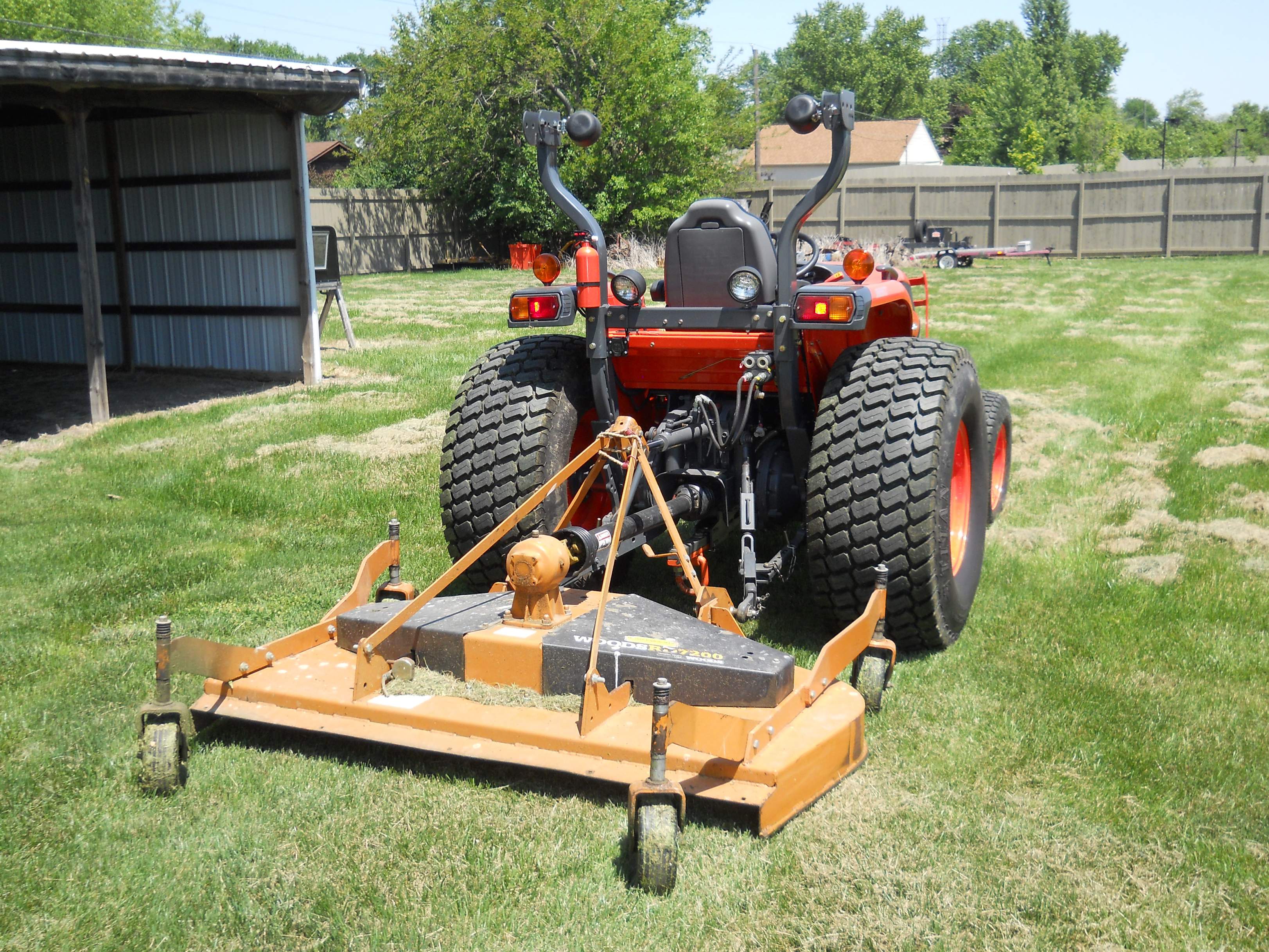

I bought a L3940 specifically instead of the L4240 because you can only mount a mmm to the L3940 and smaller tractors. I had high hopes of someday getting a mmm due to all the great benefits it offers, mainly trimming around trees. The disadvantage to the mmm is trimming in corners, ground clearance when on, and difficulty to remove, has made me keep my rfm. Areas that I cannot mow with my rfm now get sprayed. I like the rfm, easy to put on and take off. I too have long straight areas to mow. If I really need to trim, I just get out the sprayer, riding mower, push mower, or weed eater, which is not very often. Philip.

Biggest advantage of RFM Vs MMM is that the RFM can be used with any tractor that has 3PH and rear PTO. MMM fit only a select model or two. My concern with RFM is turning around obstacles like trees, fence rows, buildings, etc. The RFM is going to swing like a bush hog or any other 3PH hitch mounted equipment. For me and my yard this would be a real problem. Open areas I believe a RFM will do the same job as a MMM mower and seem to have similar costs.
