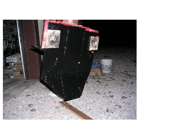

I just completed something simaler. Using it in the center keeps the forces in line with the tractor.
I was going to add a small blade to push the spoil further from the ditch.
