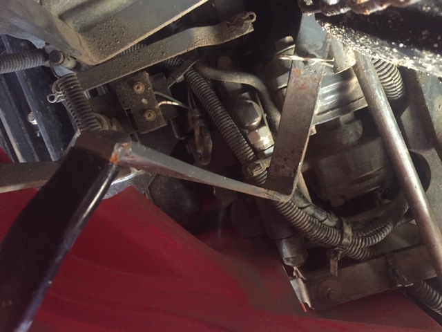

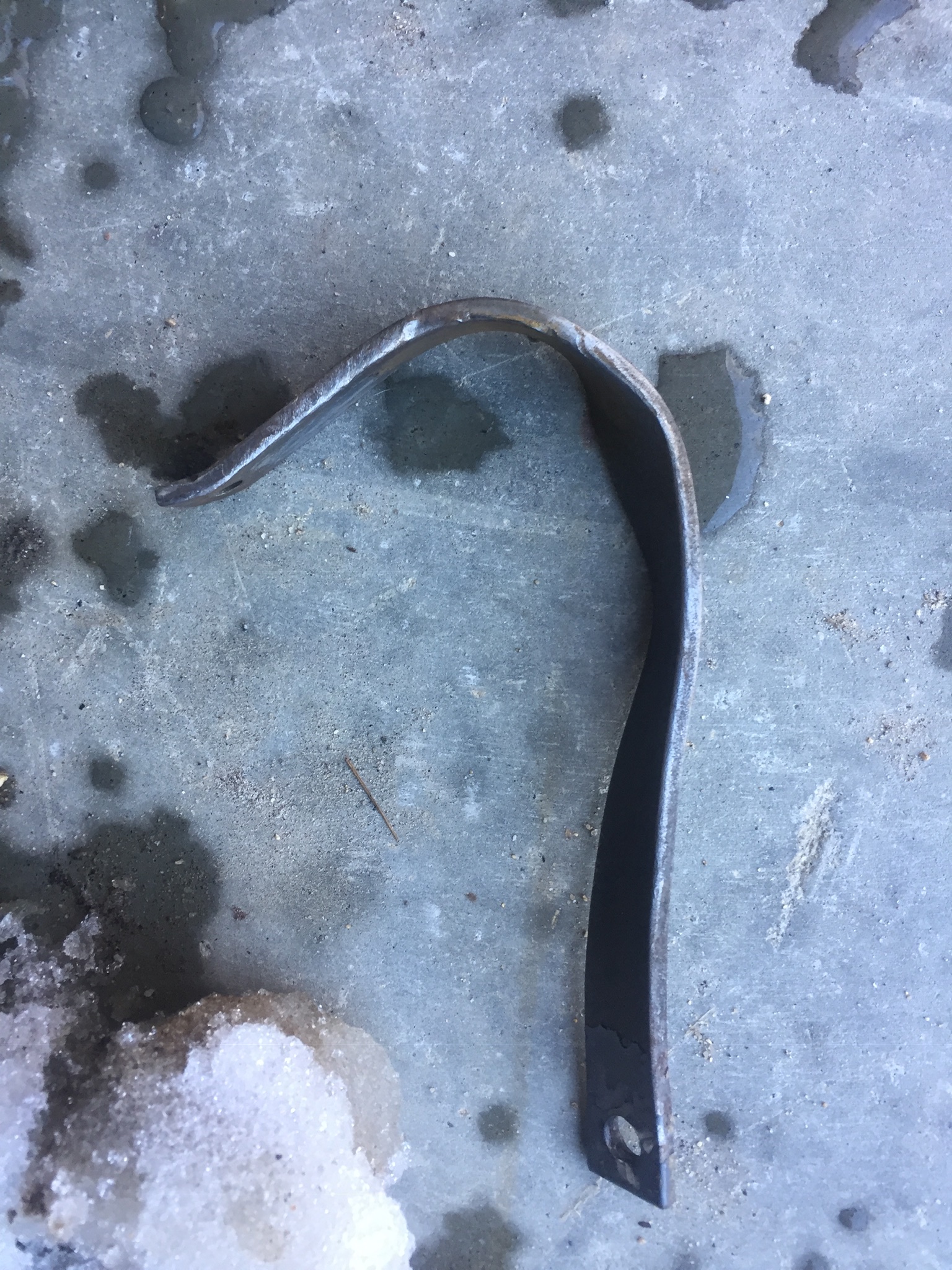

Hi Folks, It appears my rear chains were bit to bulky at the overlap connection and has bent up my mid pto lever. It is still operable but the lever doesn't move easily so I control with other lever.
After looking at the Agco parts book, I believe it is part #6254179M91 which is called the Range Lever.
Am I correct in that? The flat straight bar tht went vertical also bent up.
Your advise would be appreciated.

Not saying what to do, but, can't you just take them off and bend back into shape? You may actually be able to bend them to avoid getting caught by the chains too.
   / Mid PTO lever issues on GC 2410

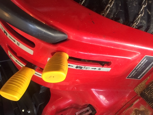

Ok, I did what you suggested and straighten out all the levers. The flat bar was a bit bent but that痴 what good vices are for. Haha.
Overall pleased but will likely replace in the spring. The grip was also a chore and mostly ruined it. Oh well. Back in business.
