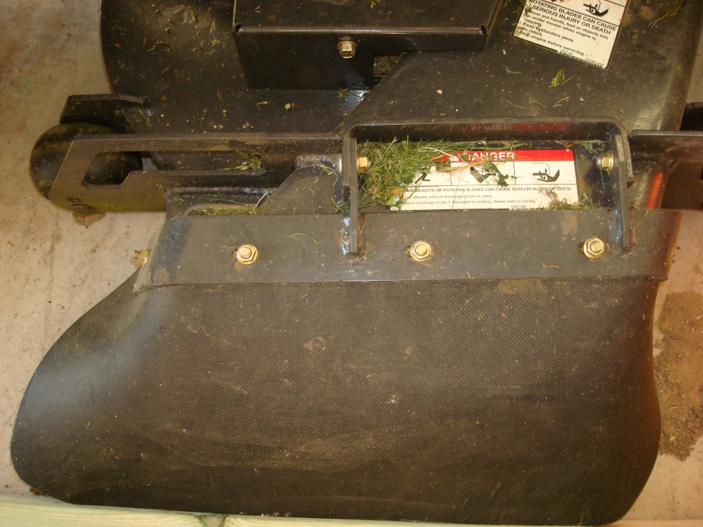

1.) the side shoot for the grass discharge is a non fold up rubber cut horse stall mat

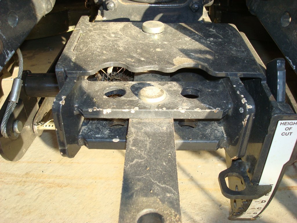

2.) the hit adjustment hangs off the back via a plate pinned to the draw bar which must remain extended

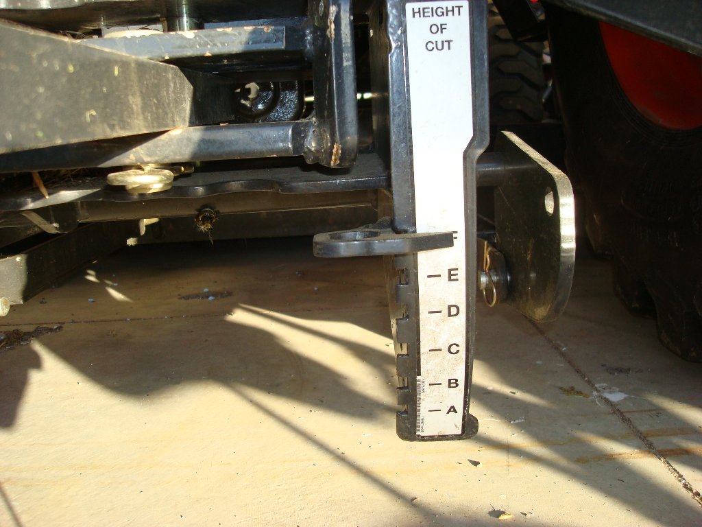

3.) there is no height adjustment well there is but in the highest position ie on "4" the grass pretty much gets scalped all the time, setting it to any thing lower would be disastrous.
4.) the height adjustment is done via a pin on the back of the tractor
5.) the height adjust scoop bracket as I call it is about 1" from the ground so with the mower attached you have zero clearance for anything.

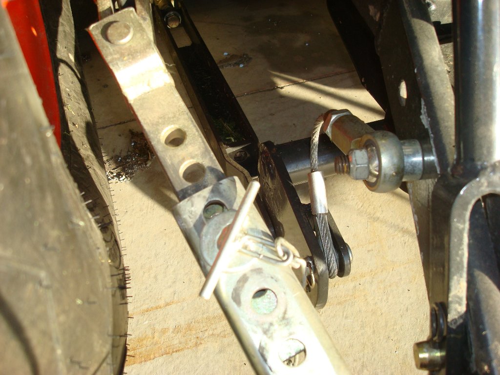

I'll take some photos of the setup tonight and post
/ mid mount mower #13
okay here are the photos, the rear hook up, grass shoot and an under carriage shot

well i do agree with you on the fact that the hieght adjustment hangs down like a ripper but mine isnt an inch off the ground. mine is as high as the deck can possibly go, so i would hit my deck anyways. the rubber discharge flap is nice for me because if it was anything but rubber it would be snapped off or bent.
/ mid mount mower #16
Do you cut in any other position other than F though?
