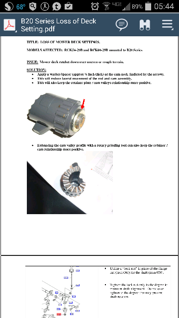

I have a 18 month old B2620 which I love, I have put just over 60 hours on it so far. I have a 54" mid mount mower and today while mowing I noticed a problem, no matter what height position I set the deck to when I lower it the deck always goes to the 2 3/4 setting. If I put it at 4 ....lower the deck the knob will turn to the 2 3/4 mark, set it to 3 1/4 same thing the knob turns to the 2 3/4 mark. Has anyone else experienced this problem or have any idea what is going on. Any help or advice anyone can offer will be very much appreciated. Thanks

I have posted about this before. The design of the height adjustment cam is not great. So when you lower it down it can cause the cam to keep spinning or slipping. There is a thread on how to repair this but I never actually tried that fix. I was having the same problem and my mowing deck would actually drop all the way to the ground while mowing. I replaced the height adjustment assembly and haven't had much slippage since then. But I still do the following to prevent the mowing deck from dropping down while mowing and
First with my left hand on the height adjustment dial I slowly lower the deck until I feel pressure on it. You can prevent it from spinning with your left hand by applying pressure on the height adjustment dial. I then will raise the deck up slightly to take the pressure off the cam and prevent it from lowering while mowing. Last I close the speed adjustment dial so that I'm not even able to lower the mowing deck.
Another thing to mention is that the height adjustment isn't even necessary to mow. You could take it completely off and still be able to mow. You would just have to eyeball the height or actually get off the mower and measure the blade height to know what you are mowing at.

I found the fix that another person had posted for this. Google the search terms "B2620 MMM height adjustment" Then once in that thread, which is on the tractorbynet forum, under the eighth post there is a link to a PDF of the fix. Hope this helps.

I got mine fixed at the dealer last saturday. The tractor never came with the spring piece of steel with the carrage bolt that goes up against the back side of the cam gear. They put one on it and bam! Instant mower deck fix!!!!

That isn't what keeps it from turning when the weight of the deck is on the Cam. It is the part that allows for the turning of the Cam to the next height setting. Otherwise the Cam would just turn freely without the noticeable clicking you feel/hear between height adjustments.

Just thought I'd share my experience with attempting this fix and see if anyone has any other input about it.
The first part of adding 1/4 inch washer to the base of the CAM I was able to do. I had to widen the hole of a washer I had lying around by boring it on a lathe but simply adding this made the height adjustment shaft and the CAM much more stable.
The second part of using a grinding tool to increase the valleys of the CAM I skipped.
The third part of replacing the flange nut with a lock nut I was unable to do as I am unable to find a proper size lock nut to replace the flange nut .
/ Mid Mount Mower Problem #20
Was able to replace the flange nut with a metric hex nut from advanced auto parts which is M10 1.25 and 14mm in width. So I pretty much got the third part of this fix done I just used a lock washer and hex nut rather than the lock nut. If you replace that flange nut it has to be 15mm or less in width or it won't fit up the CAM hole.
If you do decide to fix this yourself it is much easier to work on with the MMM off.
