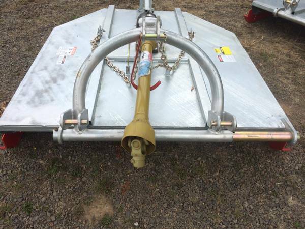

I have a walk-behind string trimmer that is permanently offset to one side. Half the time it is the wrong side!
You could make a sliding hitch like this rotary cutter, and make it go both ways.
