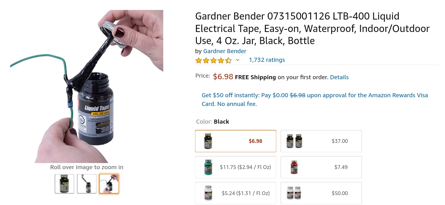

Mice or squirrels are chewing the insulation off the coil pack wires in my work truck. Has anyone used anything like fingernail polish on the wires as a repair to prevent them shorting out?
   / Mice chewing wires #2
They sell liquid brush on products for wire insulation. Plus there are also spray on products that harden.

I like the liquid tape for repairs or if a wire is pierced for testing.
However I have resorted to buying several small containers at a time for a few reasons,
people that borrow it, plus the worst is opening a half used container and it has all set up
or thicken so much you can't spread it.

I am going to start with this. I haven't had a Boa constrictor for years but if I did I would like to try that.
https://www.amazon.com/gp/product/B000XBDK7G/ref=ox_sc_act_title_1?smid=ATVPDKIKX0DER&psc=1
Haven't really had a problem wwith cars etc but we have with mice chewing wiring in the ceiling, a woman I worked with had a couple of pet pythons and she told me about it and gave me some dried stuff, it worked, no more patter of little feet during the night, lasted about 6 months
