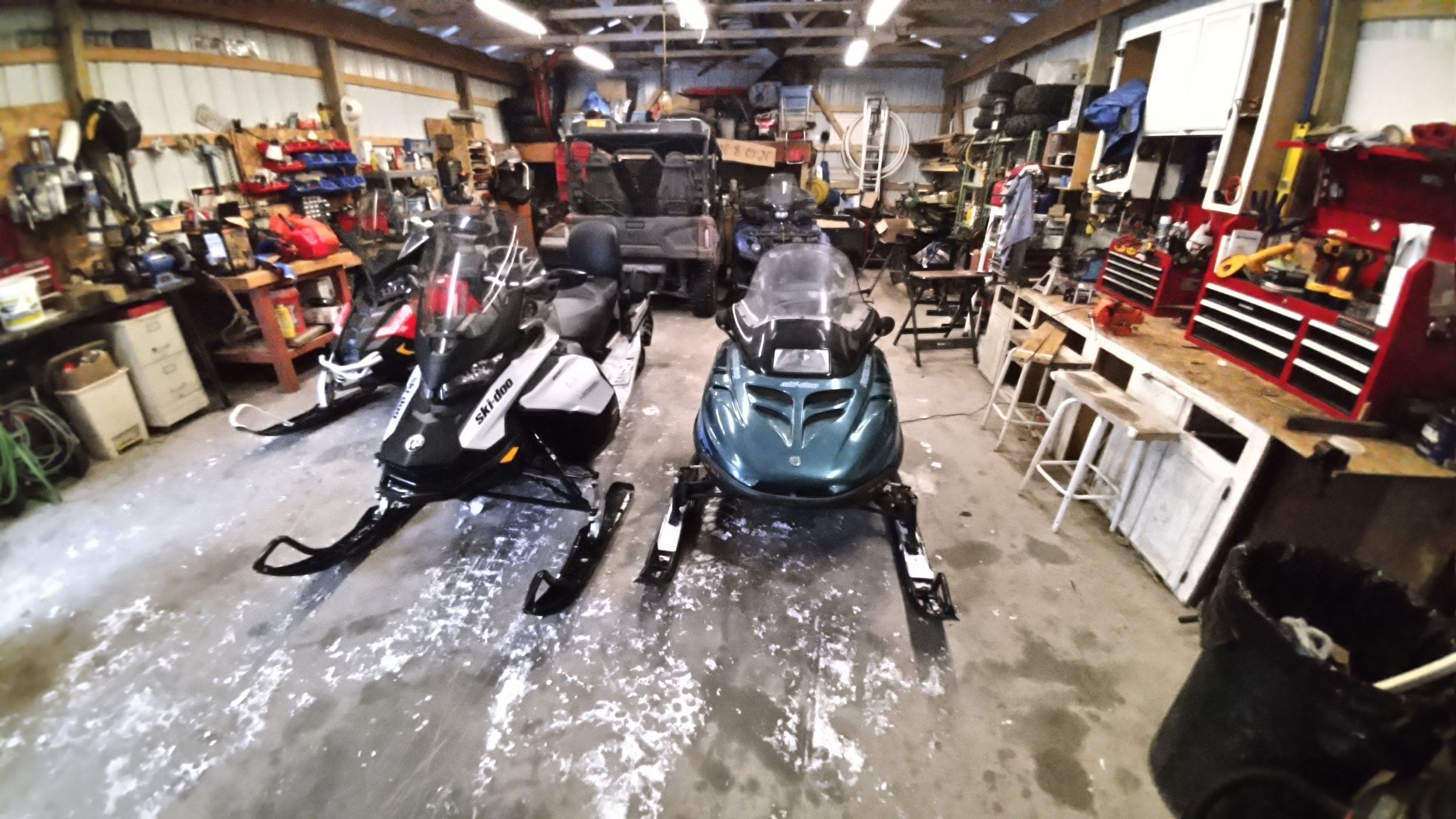

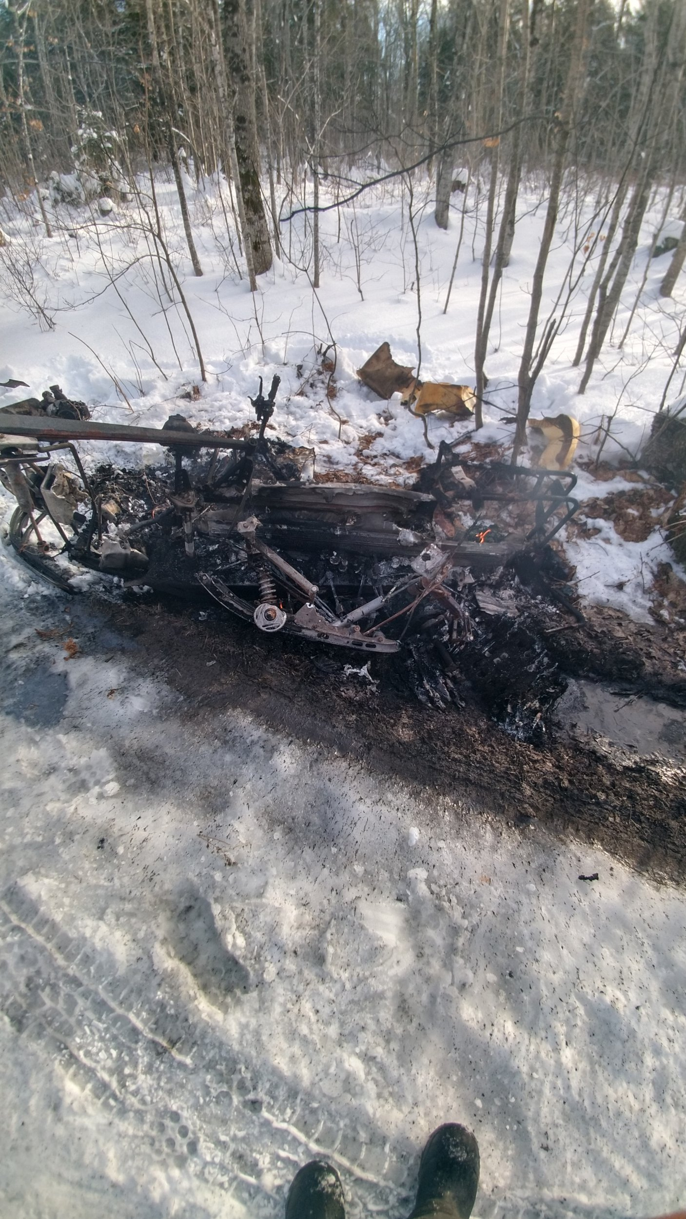

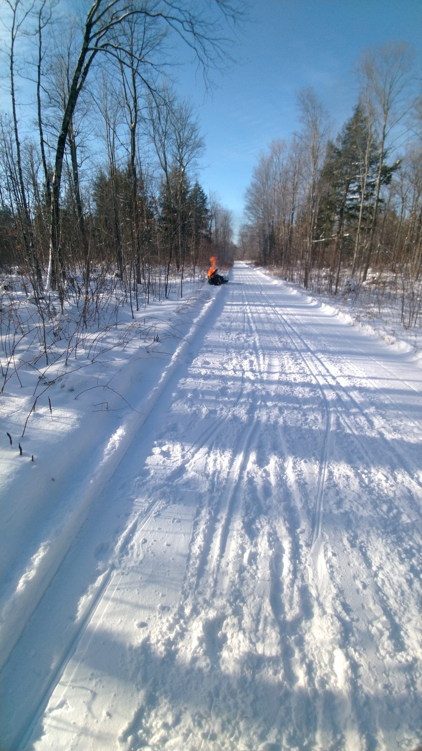

Took my near vintage Ski Doo out checked it over saw a few signs of mice cleaned it up unknowingly the mice got in the insulation between the exhaust pipe and heat shield where I theorize it made a nice flammable nest I just filled up the tank so it's got 10+ gallons of gas. My lesson and experience was check your seasonal stuff again thoroughly. It's the older green one on right before, second is during last is what was left. Thank fully I was operating it and not the kids or wife and the only thing hurt was my pride.

Only thing bothersome is pride and frustration with mice plus a case of would've should've could'ves. Unfortunately no insurance on my older sleds 20+ yrs old I have a small fleet of these old s chassis ski doos I used to buy as a hobby to fix up and use for cheap parts, I think the only parts I can salvage on this one are some heat treated bolts and surprisingly the ram mount survived the fire was so hot it even melted the aluminum reverse gear chaincase. lol.

Sure but not something I thought of until now it was my first snowmobile fire by the time I finally noticed the fuel tank was close to going, that goes no extinguisher would have helped and it's time to watch. There are a lot of hidden obscure areas under the cowling on one of these.

Snowmobiles like a lot of things have a lot of flammable stuff, if your engines running hot due to lack of cooling snow or dirty carbs it may not blow the engine but the exhaust can and will get very hot, glowing in some cases, hence why on some they wrap the exhaust can in insulation with a heat shield over it Mice, unfortunately, don't mind fiberglass. I have an old 440 fanner that blew the fan belt it got so hot it was dieseling with no spark just running off the heat of the engine the y pipe out of the engine was red hot. I replaced the fan belt and its still running strong 10+ yrs later with no rebuild.
