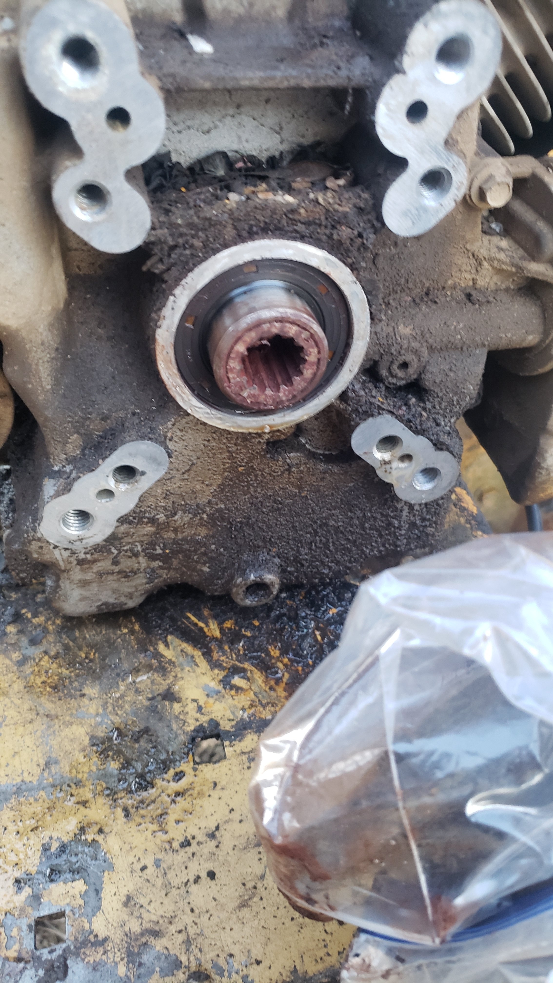

Now here is some info I found in my wonderful endeavor; they no longer make this particular engine & when you are asked for the Spec number be prepared to hear sorry can't help you. on mine they cut the rear crank & left 1 inch stick out with a female 13tooth receiver for the hydraulic motor to plug in too. this engine is only good to run the hydraulic motor (which apparently Struck grinds off the serial numbers) why wouldn't they just use a coupler? thus leaving the crank shaft alone, and the smart spark is non supported while the conversion kits are out of stock.

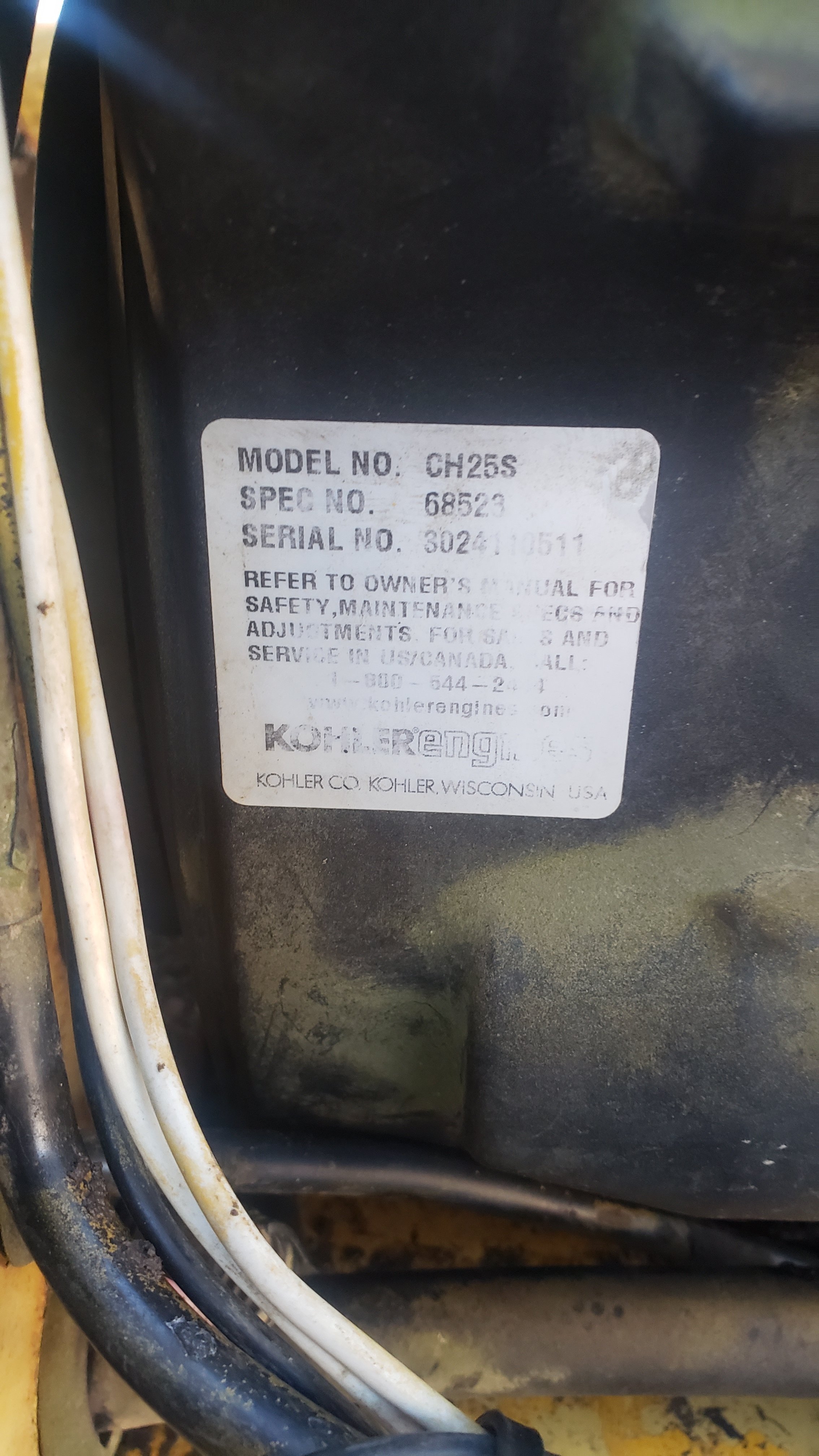

If you don't mind would you post the model and spec number from the engine tag so I can see what it looks like. Kohler now Rehlko was known to make custom engines for specific equipment and in some cases they made only 1 with its own unique spec number. Basically you could take a list of parts for a certain engine and throw them together in any configuration that suited you and they would build 1.

I have a seep in the rear seal, its not to bad - ill keep an eye on it and replace it when weather breaks.
Hopefully the seal is not some special thing, I doubt it and will order one to have on hand

This female splined shaft, good luck finding that.
I can't complain I mean 20 plus year old engine and I didn't baby it. So its been awesome.
There is a guy I found online who makes that shaft on kohlers but the engine is $3200 plus S&H and comes with no muffler, I'd rather get the guy in Illinois to do the diesel upgrade (former struck employee) for not much more.

Definitely one of the Kohler oddball engines. Looks like the ASAM to DSI kit is in stock for at least the Western US at the Kohler distributor. The CH730-0086 superceded to CH730-3240 replacement engines are NLA. But I would say you got your money's worth out of that 24 year old engine.
Looks like there is 1 crankshaft available at my warehouse. And short block NLA. So parts are limited but not surprising. My nephew has a 10 year old briggs Vanguard on his stump grinder that the carb repair kit is NLA and have to repair with complete carb.
