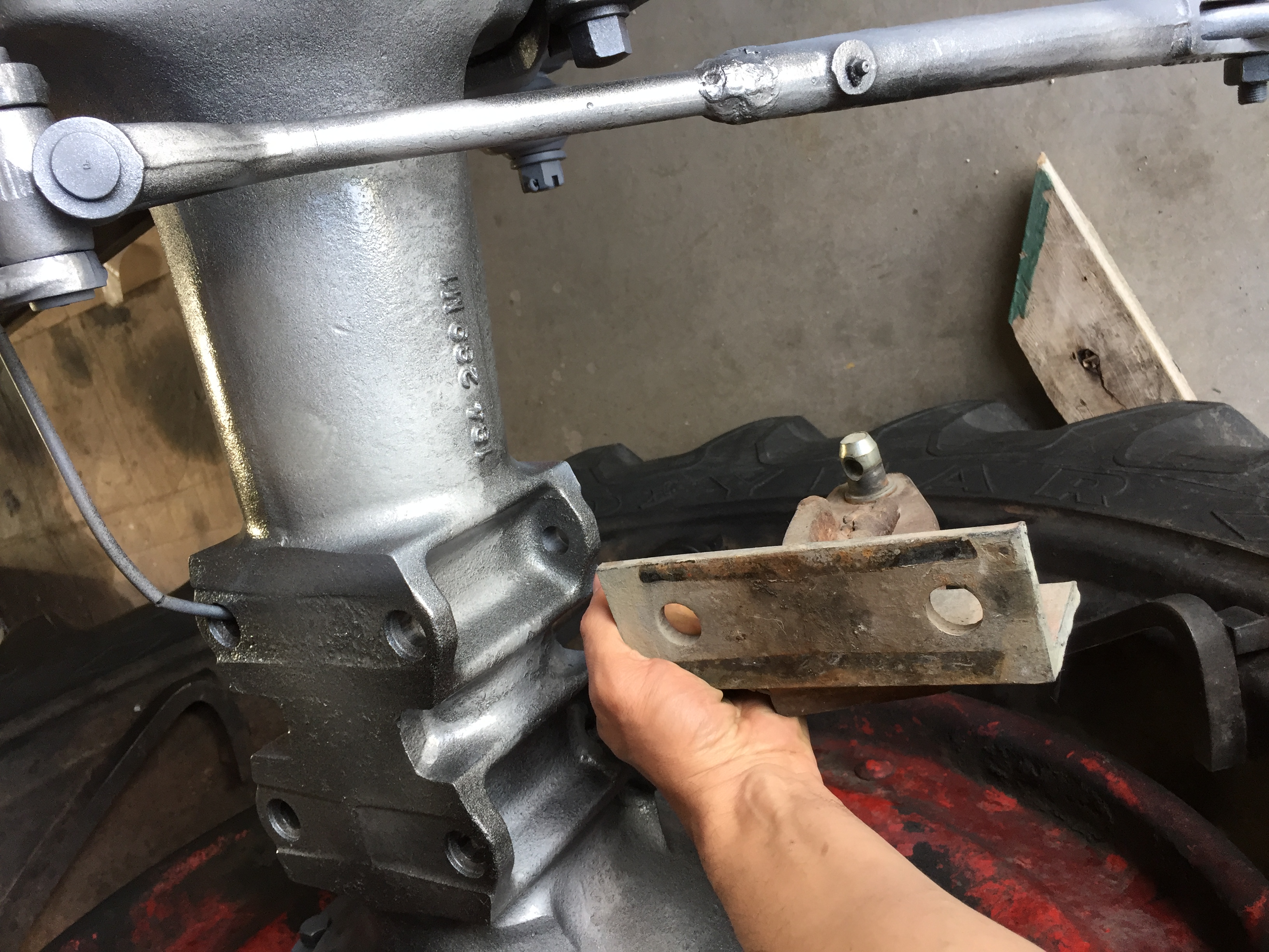

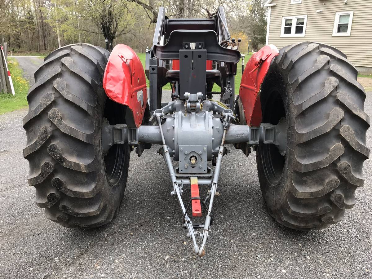

New to tractoring and recently bought a new old tractor '58 mf 65, just wondering if I need to add a top link bracket/beam to use top link and do i need to buy a braket for chain stays for control arms?

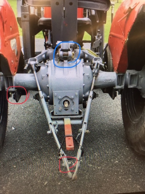

At the bottom red circle it appears that pin is in backwards. Face it the other way.
The red circle on the left. You may be able to fit a pin in there and then use an arm similar to a top link to connect the 2.
That will adjust your control arms.
My Massey came with a bracket that attached to the bolts in the left circle. That is there my control arm connects.
Can add a picture this evening.
As for the top blue circle.
If you can fit the end of a top link in there you can use your top link as is.

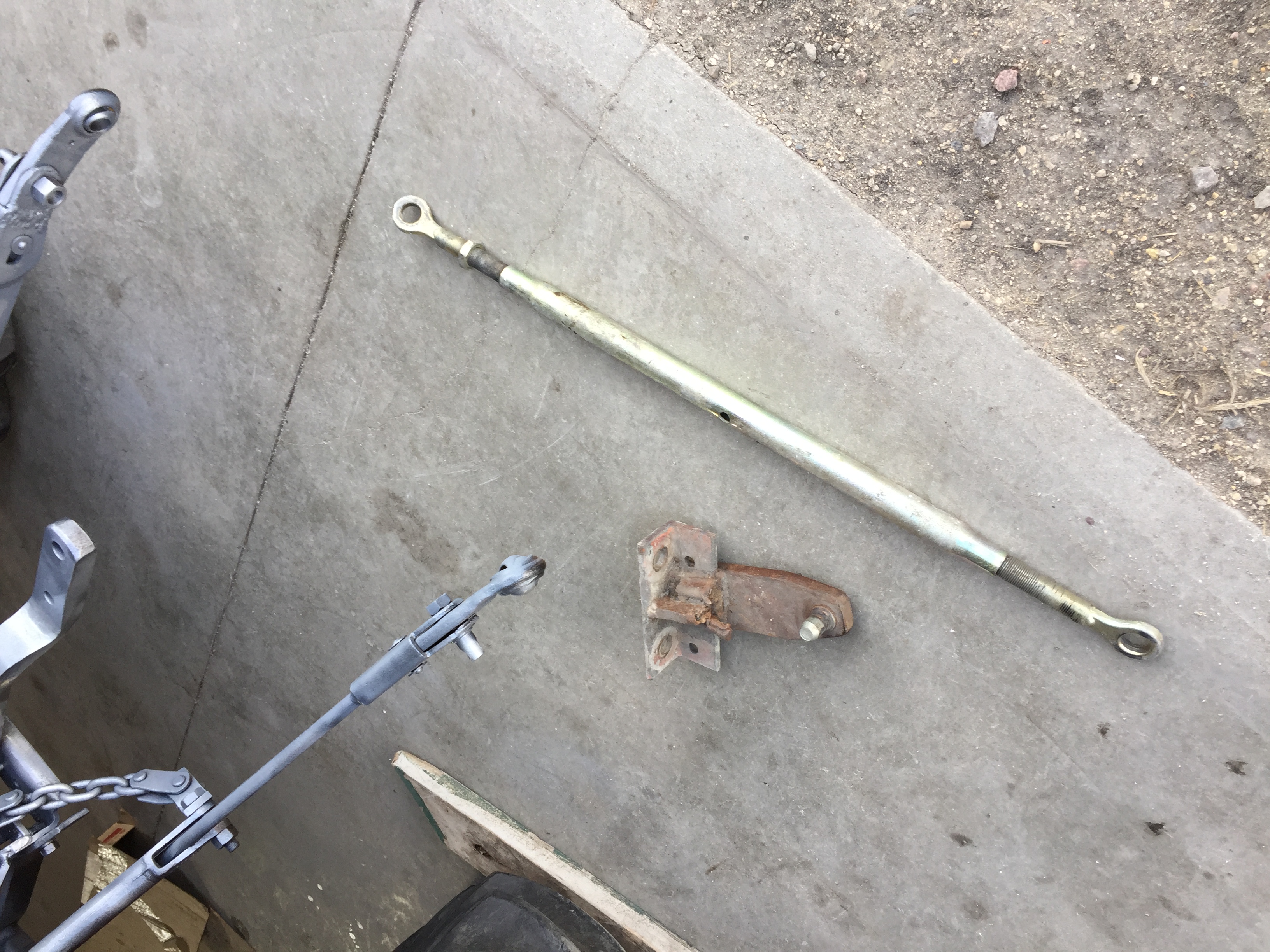

Attached (hopefully) 08128FE4-BBFB-4022-AFE7-BB58658BC3BB.jpeg1106F72C-2C2E-42E8-AA9C-459211691CC3.jpegare h08128FE4-BBFB-4022-AFE7-BB58658BC3BB.jpeg1106F72C-2C2E-42E8-AA9C-459211691CC3.jpeg
   / MfF 65 3 pt hitch
oh ok those are stabilizer bars right?
