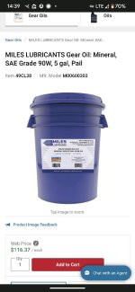

Need help on mf65 trans oil. I have a 1962 mf65 with multi power transmission. I see the manual calls for 80-90 wt mineral oil. Is the miles gear oil ok or is it not gl1? If that’s even important. The local MF dealer wants $110 for 2.5 gallons vs granger at a bit more than half price. If I’m on the wrong track please pount me to the right one at a decent cost???

Stick with the mineral oil ! I'm not sure what the part no. is but I use NAPA brand on my 1959 M-F 50 ! I'll get back with You later on a part no. there 2 different weights that NAPA sells one is 80w90 & the other one is straight 90w I use the 90w in my 1959 M-F 50 which takes 8 gallons , & comes in 5 gallon containers ! I'll have to check my receipt from last year , But I'm sure the price has gone up since then , I'm sure it's not as expensive at what your looking at :unsure: ! & welcome to TBN .

It's been debated a lot. Most of the people I've talked to run Permatran instead of GL-1.
Personally I run Mystik JT-5 because I run that in everything. Specs said it would meet Permatran specs. Haven't used my tractor hard yet but so far, it hasn't had any issues with JT-5. Permatran was
I think from what I've read, the non multipower MFs have to run GL-1. The Multipowers should run the more modern hydro fluid.
Mystik was 99.99 for (1) 5 gallon bucket. I bought two since it needs 8 gallons. Permatran at the dealer was $121. So Mystik was a little cheaper.
