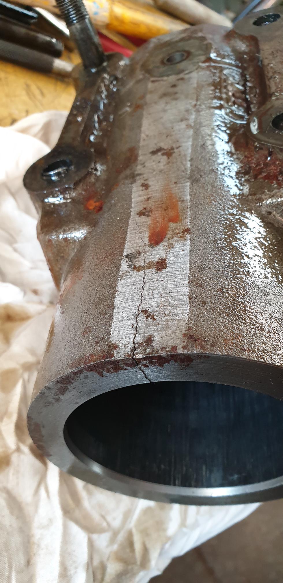

hi guys,
well after completing an engine service after purchasing a MF35 I turned her over and noticed the lift arms were in the top position. I cant recall what levers I pushed next (either operational or draft) but I then heard a loud bang and found that one of the bolts under the lift cover had snapped :thumbdown:
I then lost all lift up and down. The lower linkage arms were basically hanging loose.

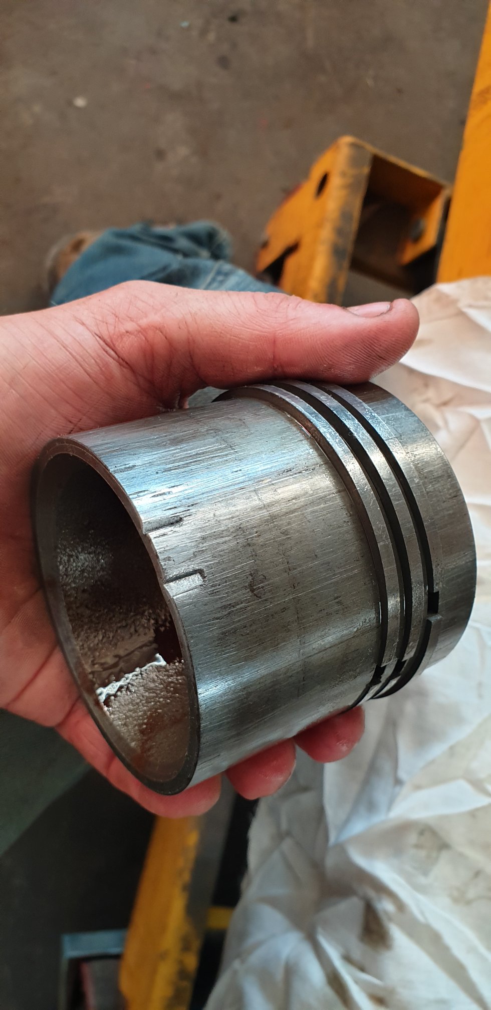

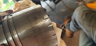

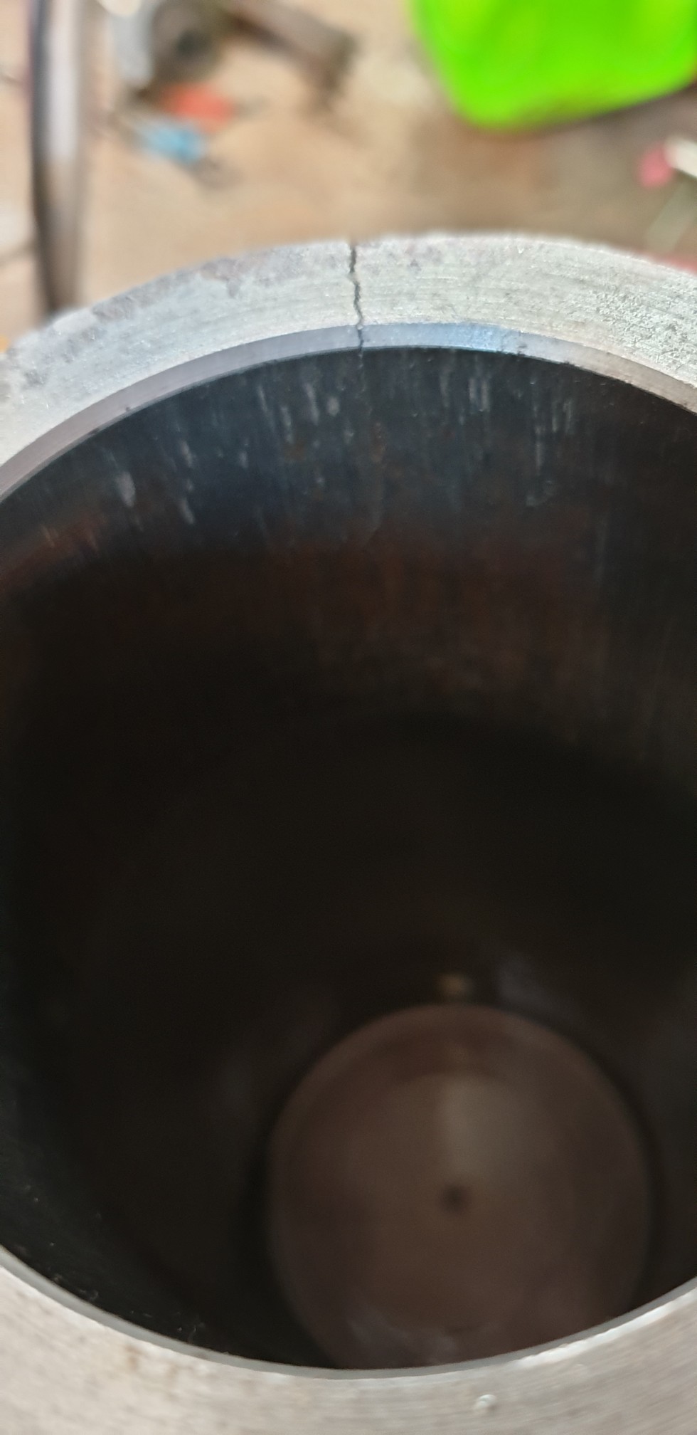

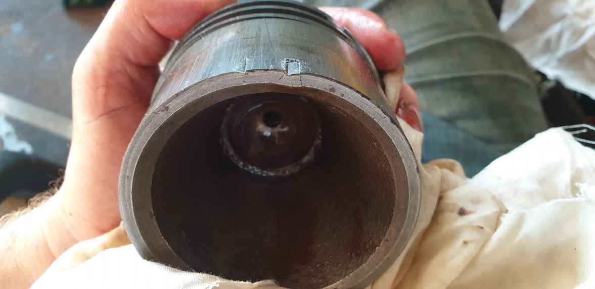

I managed to find a local mechanic to tackle the job and he sent me through the photos of the aftermath. looks like the ram cylinder is cracked and the piston has a big dent in it.
Question; Does anyone know what may have caused this? (When the bolt snapped I heard a loud pop and the bolt shot up on hit the bottom of the seat/chair)

My first WAG would be your pressure relief valve is not working.
   / MF35 cracked Hydraulic ram cylinder #3
Hydraulics have to have a relief valve in the circuit to keep from dead heading.
Without relief valve or malfunctioning valve pressure will exceed working pressures and cause damage.

thanks guys.
Just got a call from the mechanic.
He mentioned the it could have been 2 of the following;
1) relief value could have been damaged/stuck by water corrosion or
2) piston damage could have been from a dislodged piece of steel from elsewhere that got caught against the piston and cylinder wall causing it to crack
other observations;
- judging by amount of water in the oil and the sludge on the top of lift cover seems like oil could be decades old. fresh oil to be replaced
- gaskets leaking near bolts that hold the foot
- PTO has a fair amount of play in and out, its not leaking so he mentioned just to keep an eye on it
His going to replace the whole cylinder and piston with a bigger later unit (with bigger bolts, replace all gaskets, relief valve, fill with fresh oil
fingers crossed I can then starting using this thing!
