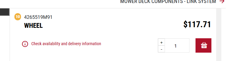

I have a GC2400 with the FEL and the 54" 2320 mower deck. Yesterday I was surprised to see the front left gauge or caster wheel was gone...just the bracket that attaches to the deck was there. I've never had a wheel fall off any of the 3 tractors used for mowing, so I spent an hour or more walking around the farm where I had driven the tractor, mostly hauling logs and rarely mowing, but to no avail. I have no idea how this could come off, and not be noticed as I would surely have driven over it when it happened. This morning I thought I better see what the replacement cost would be. On my 2 tractors with Woods mowers, I expected them to be high, and replacing the wheels on one of those a year ago set me back around $70, each. Imagine my shock when I looked up the cost to replace this one small wheel assembly...$350!! Holy smokes! Is there an alternative out there. I was literally blown away.
/ mf2320 mower gauge wheel #2
was it the wheel came off the "axle" or did top restraining clip break and whole assy came off?
the wheel 4265519M91 shows as approx $118 and the 2 bushings, washer, end clip can really be anything.
disregard I misread your post about what was missing, yeah you need axles and everything. yeah that fork (as they call it) lists as 152$ alone and thats with no wheel. bushings, etc. the pin alone is approx 79 $.

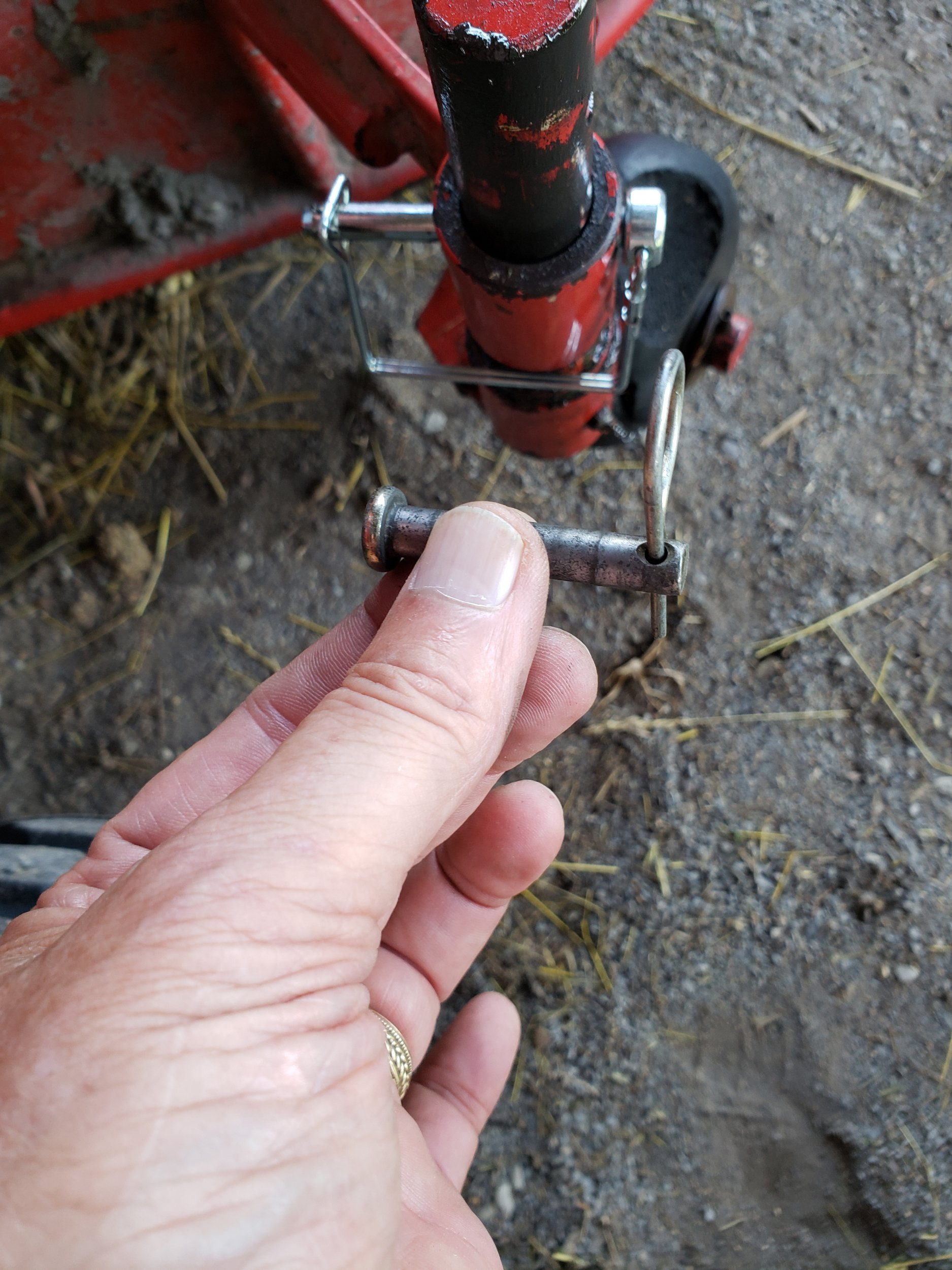

Well, miracles do happen. Over 3 days I spent hours in the fields and on every trail I had used that tractor this year, even using a weed eater to cut back taller grass to see if the wheel was hiding, but to no avail. Today I was going to pull the other front wheel to take around to other dealers (the Massey dealer 30 miles away seems to no longer carry the brand, anyway) to see if a Kubota or JD wheel would work. I found it was impossible to pull that wheel on level ground even with the deck fully raised, so off again revisiting any place where I would cross a ditch or go over large rocks. Sure enough, on one of the woods trails I found it kicked back in the undergrowth off the side of the trail. The rubber wheel was pretty chewed up, so this happened when I was passing there and had the deck up but running the blades to clip the tall weeds. As I went over the rocks it was high enough in the center to drop the wheel (no telling where the cotter pin and metal pin were lost) and the it was grabbed by a blade and hurled into the woods. It is back on and usable, but I will replace the iffy pin with a PTO-style square safety pin as used on the back wheels and keep an eye open for a less expensive wheel.

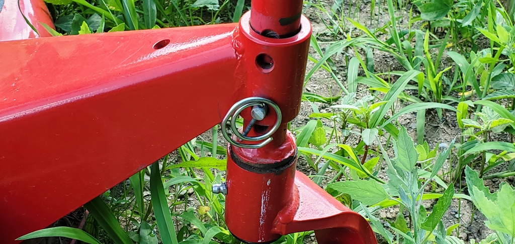

The original metal pin with cotter pin was replaced by the safety pin shown installed on the deck. I can see how the original cotter pic might have snagged on brush and pulled out without being noticed, then it was just a matter of time before the pin vibrated out.Then the whole assembly was just waiting for a dip to drop off. The safety pin, now on all 4 wheels, should resist that.
/ mf2320 mower gauge wheel #9
Those retaining clips get yanked out by weeds, I've learned that the hard way. I just replace them with a shcs screw and a nut, that wheel ain't going anywhere.

I do not see any way that one of those spring type concentric circular clips would ever comp off unintentionally. I've seen many over the last 3 or 4 decades and never saw one of those come off without human assistance.
/ mf2320 mower gauge wheel #15
Mine also has those spring-wound clip things. What a PITA to remove... but I've never lost one, either....

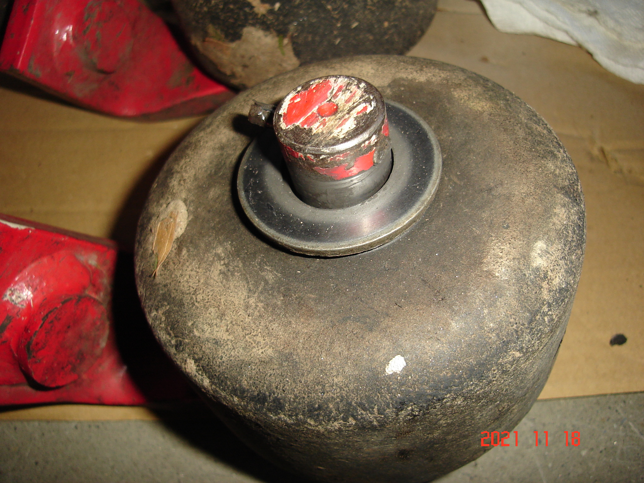

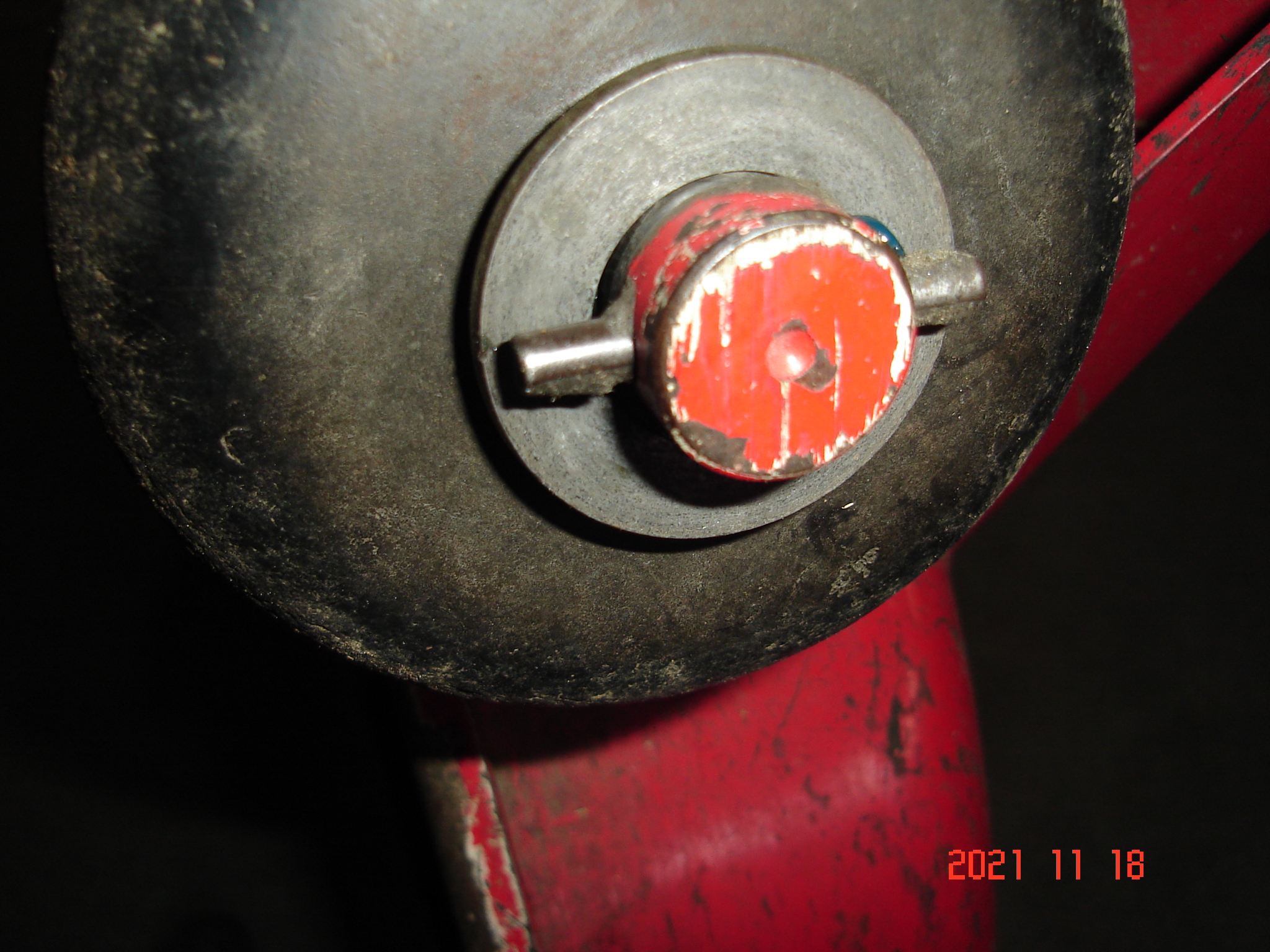

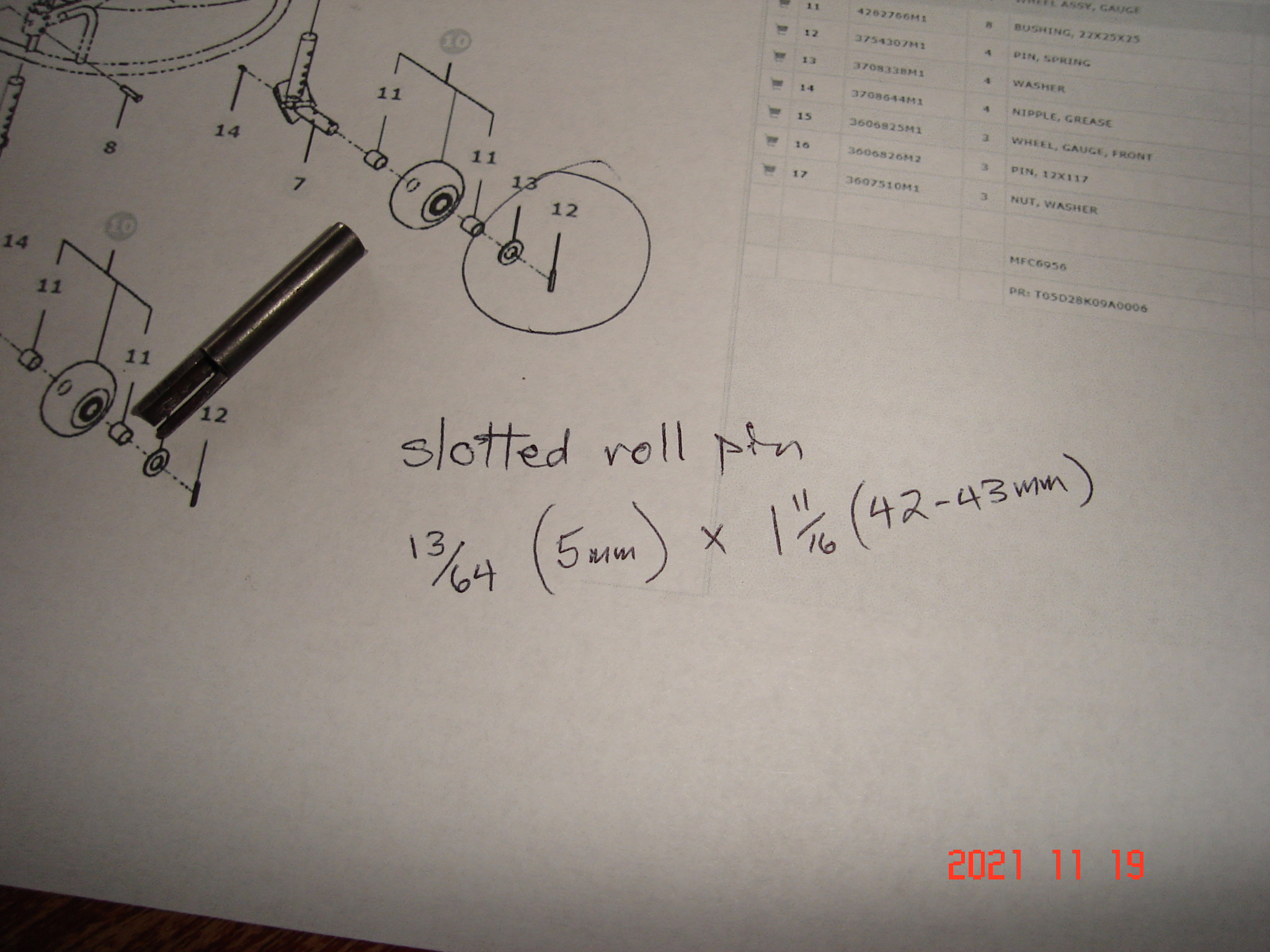

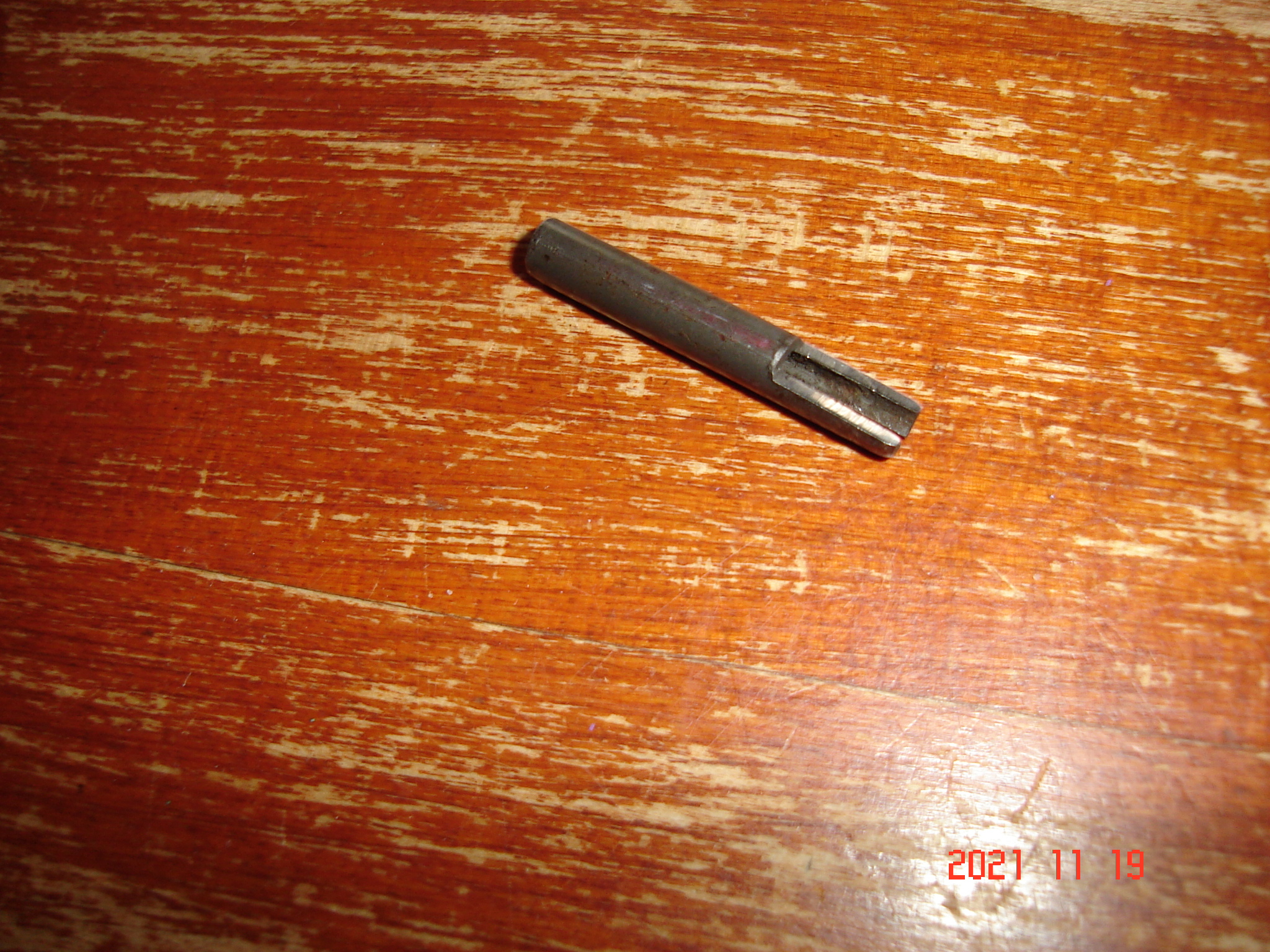

I had a different set of problems with my 2325 MMM. First, the snap ring at the base of one of the swivel wheels (front) apparently fell off(??), so the whole thing dropped down and the washer fell off and was lost. Had to drill out a large washer to get that to fit, but daughter's R&D outfit had a snap ring... so that was a fairly easy fix.
While putting the MMM up for the winter, I discovered that on the rear wheels, the slotted spring pin that holds the wheels onto the axles (all four wheels use this method) had been ground away by rubbing on the washer(s) over the years, no doubt because of the sandy nature of the backfill put in around the house when it was built.
Half of the pin was ground away, half-way through... but the lower section was completely gone. Turned the wheel over in my hand to get at the grease fitting... and one of the washers dropped right off! (WTH??) Then I saw the pins were worn away.
So-- if that ever happens: pins are metric, 5mm. Closest I could find locally was 3/16" (Tractor Supply), which worked, but the fit is not so tight. Have some 5mm x 40mm pins on order (Grainger).
Fist pic is front wheel, showing the pin the way it's supposed to look. Second pic is one of the rears -- note that the lower half of the pin is completely gone. Third pic is from MF parts diagram. Fourth pic is one of the 2 pins after it was removed & cleaned up.

Well you got the 5mm spring pins ordered already. I was gonna say, just hit ebay, I find stuff like that pretty cheap on ebay.
/ mf2320 mower gauge wheel #20
Got the pins from Grainger yesterday, and my assumption was correct, they need to be 5mm. Old new ones (3/16) came out very easily; suspect I could have pulled them out with a pair of needle-nose pliers so they probably wouldn't have lasted long. New 5mm pins definitely needed some force to tap them in. Good to go. BTW, pins were 5mm x 40 mm and I have extras (pack of 25) if anybody needs a couple.
