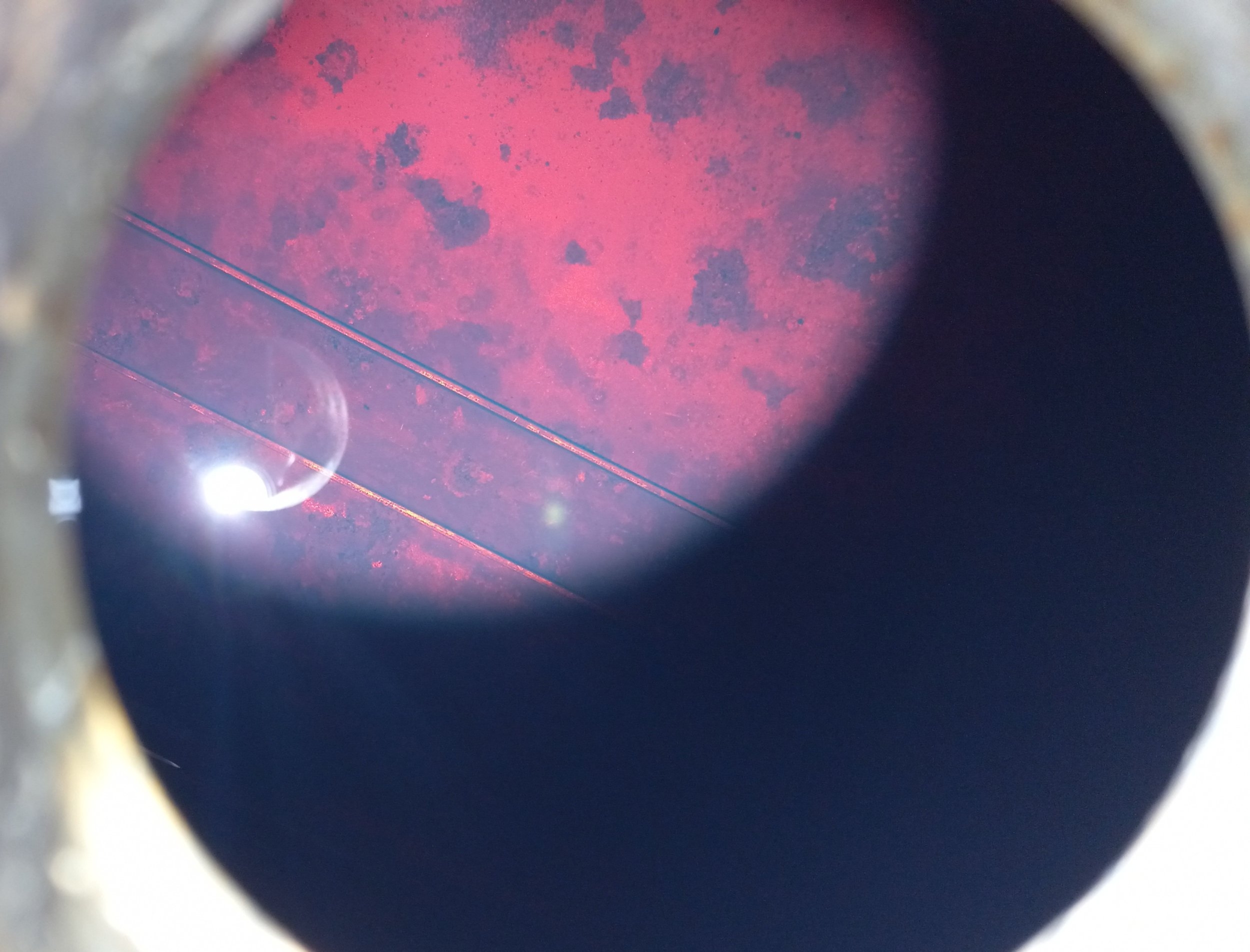

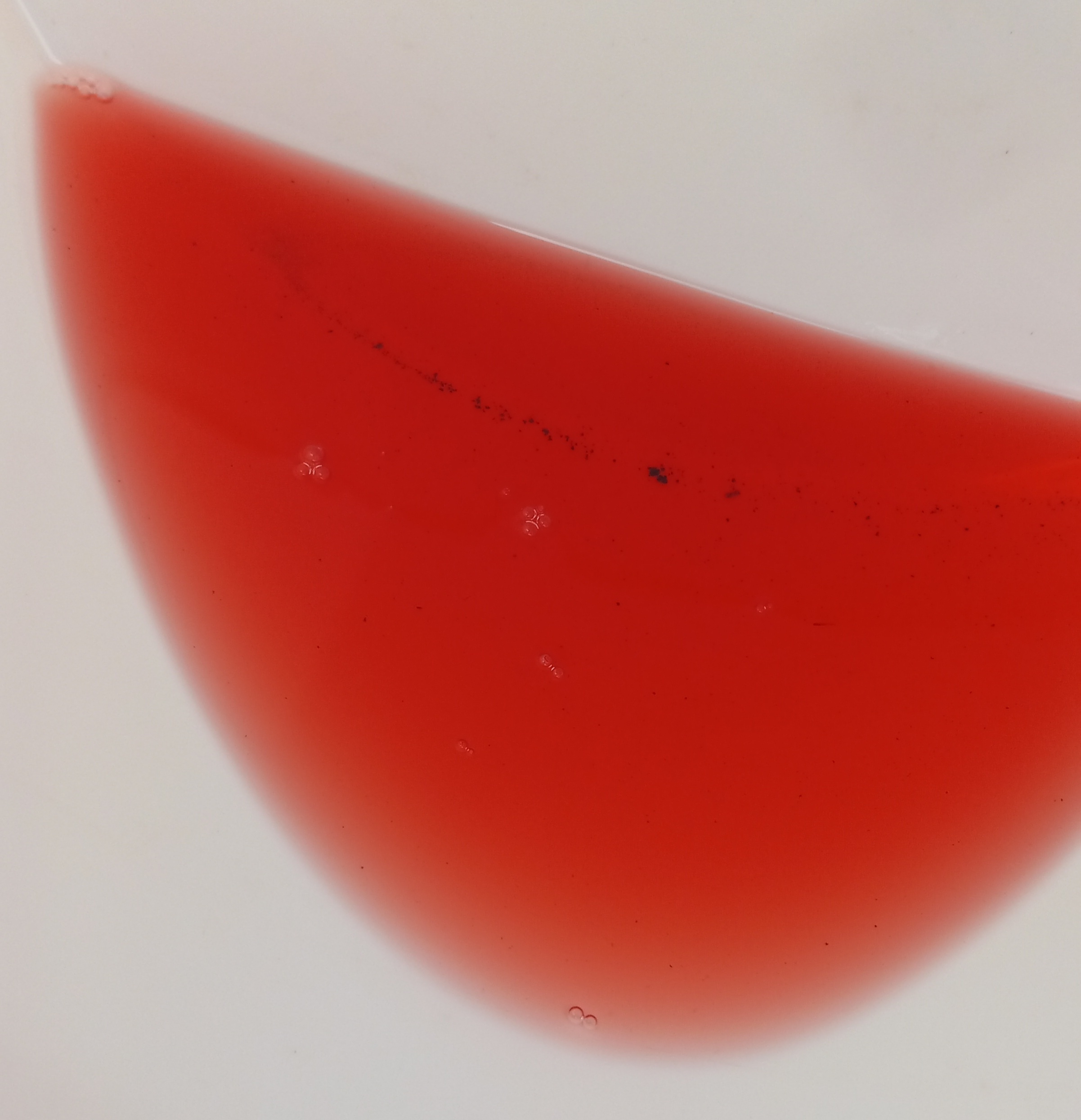

Siphoned out the fuel I could. A little trash came out with it. Also included a picture of the inside of my tank. Should I go through the hassle of pulling it and washing it out?
Keep in mind the tank might have a lower sump then what you can see from the filler, I know the 240 does. I would see if you get lots of fuel flow to the filters. Likely wouldn't hurt to change the fuel filters too.

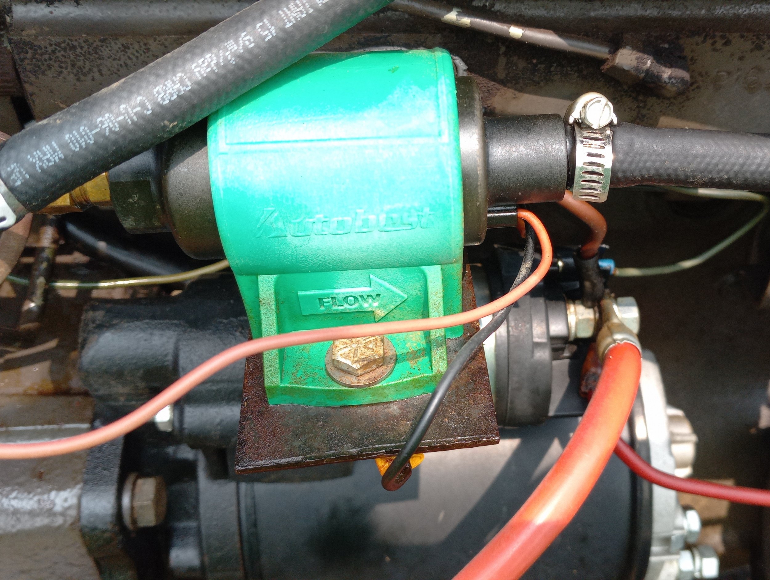

/ MF231 troubleshooting #11
Looks like an electric fuel pump?
Different setup than the 152 perkins in the 240.
Are you getting fuel to the injection pump?

/ MF231 troubleshooting #13
Make sure the lift pump is working. Check by pumping with the lever and open fittings leading to injection pump. Then get a hold of the procedure for priming the injection pump and follow it. There is on mine a vent screw on the body of the injection pump to open while pumping or cranking and before that vent along the way up to that point at connections. After that I opened the lines at the injectors one at a time while cranking and closed and started it. Mine is an older Perkins engine but the basic procedure should be the same

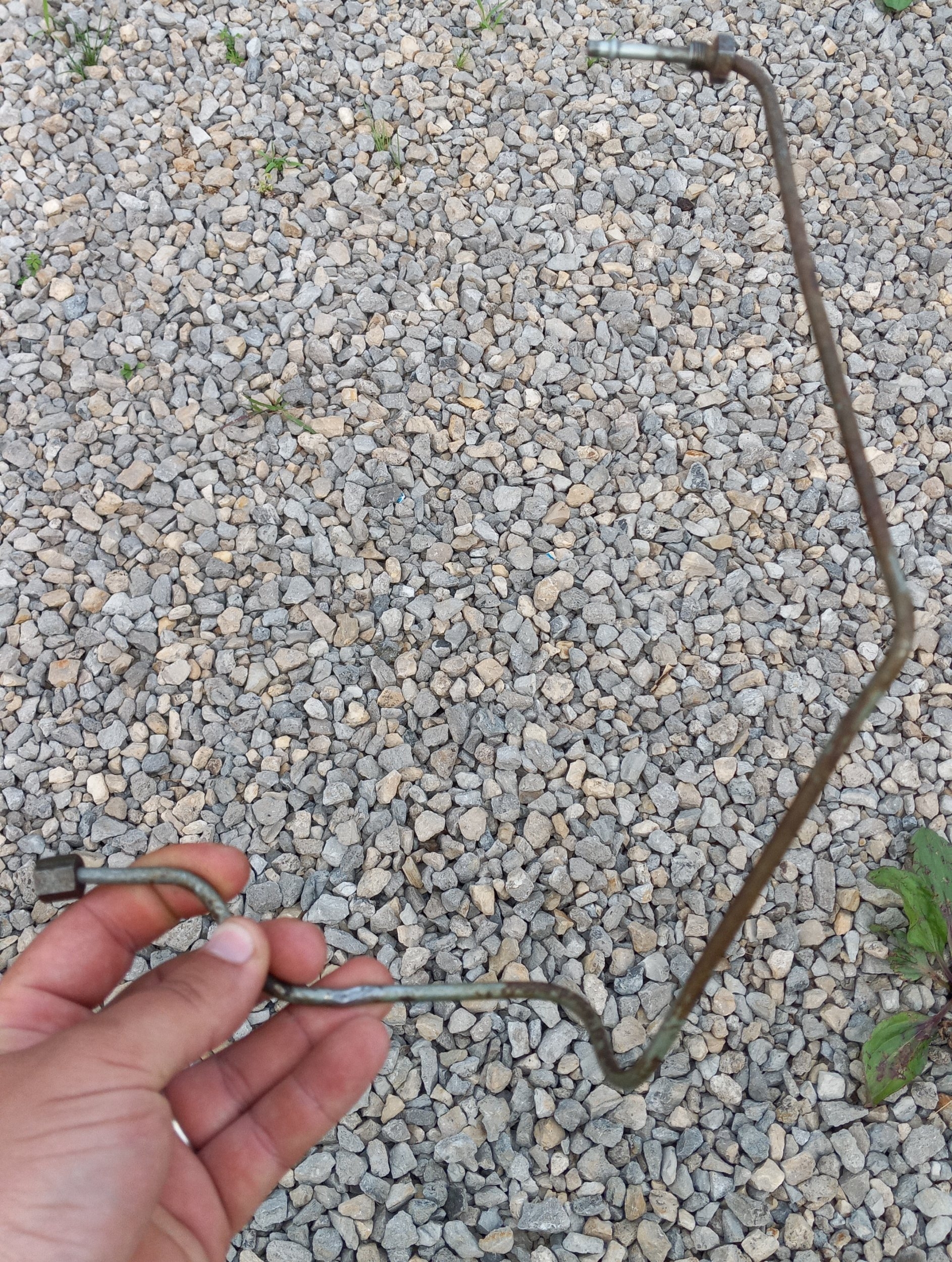

#17
That little pump wasn't running. I followed it's hot line to a capped end. Put it on the hott terminal and I could hear it turn on. Within a couple seconds I had fuel squirting out of a pinhole in the line that must have finally broke through. So ill find somewhere to get that line fixed and start again lol.

#19
Anyone have the part number for this line? It's the one that runs from the injectors, under the gas tank, and connects into the gas tank behind the battery. Rubbing the gas tank rubbed a hole in it where my finger is.
