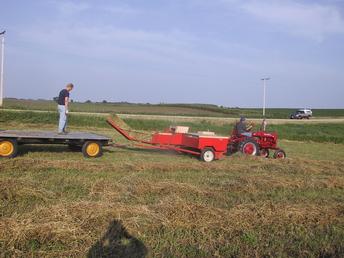

Your going to be a bit shy on the HP and also the weight of your machine. I am providing a link to Massey Ferguson model 1700 series small round balers. They require a minimum 30 PTO Hp. You might get away with it on flat property but its going to be a little dicey ! ;)
Im also going to post a pic of a 1939 Farmall A pulling a square baler and a hay wagon, doing all that with just under 20 PTO Hp ! ;) Although I dont think you will find anyone that will reccomend doing that !

Hey Scott was that you using the IH A ?
Mornin Bill,
No I cant say it was ! :) I got that photo off of Yesterdays Tractors ! ;)
