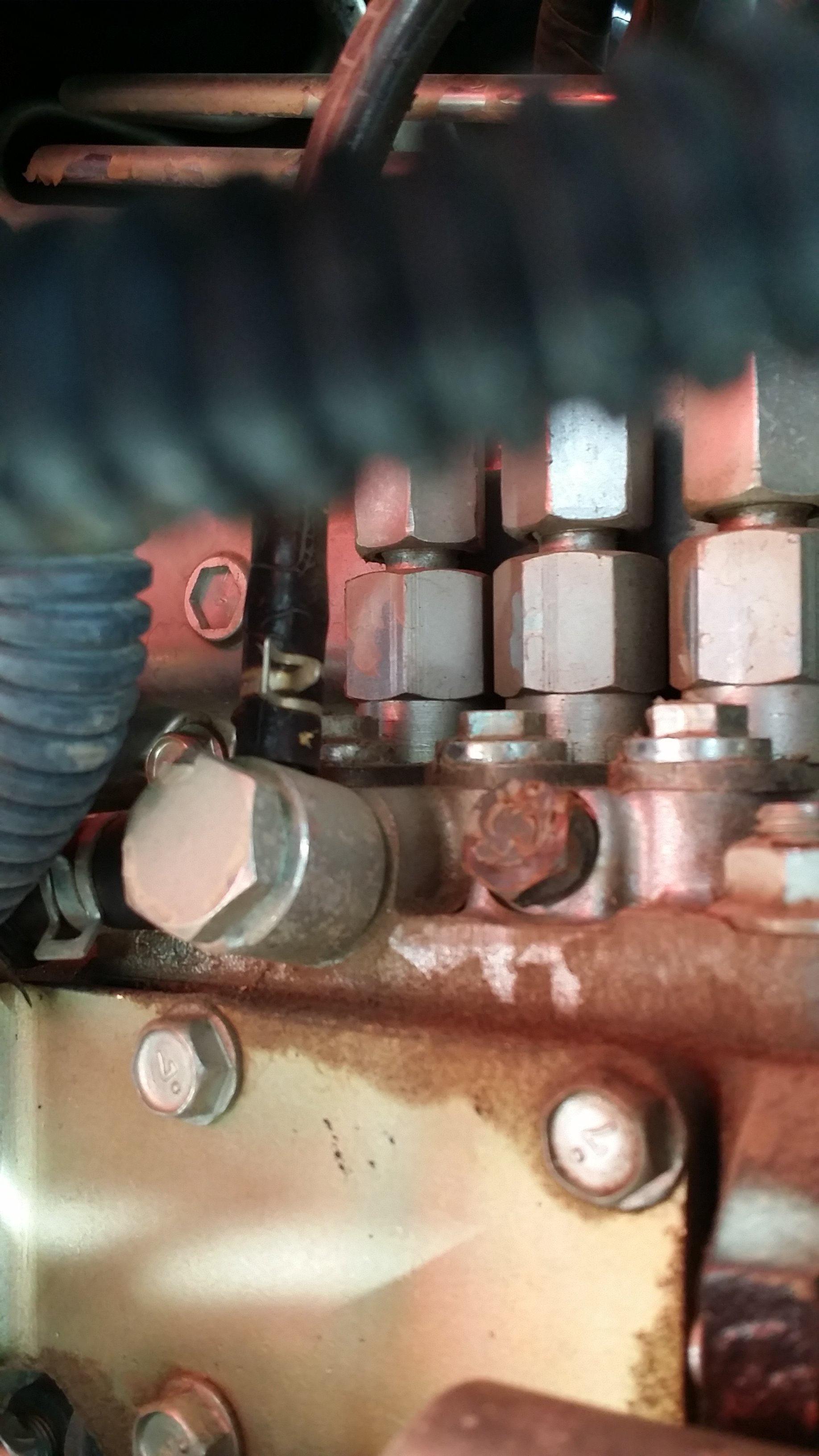

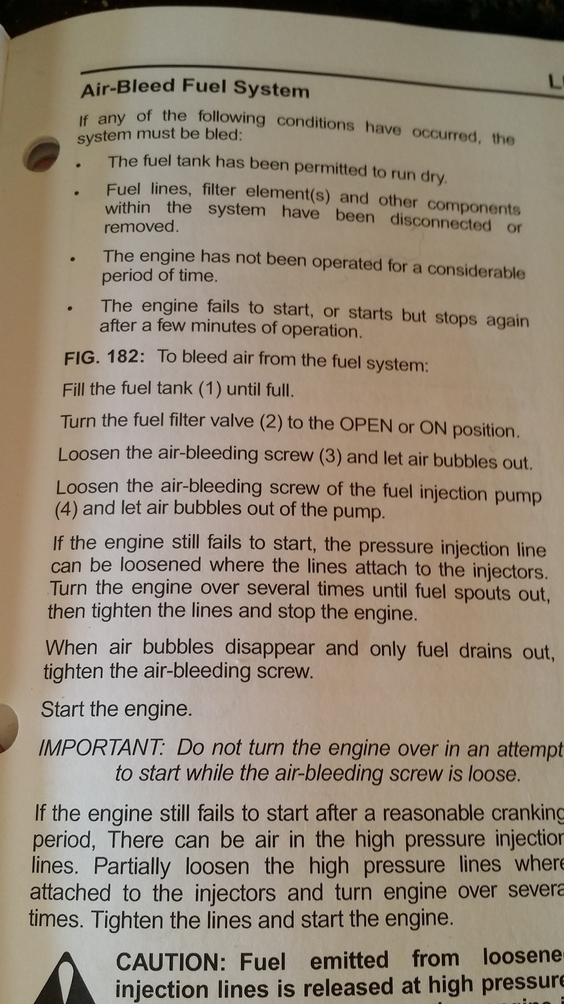

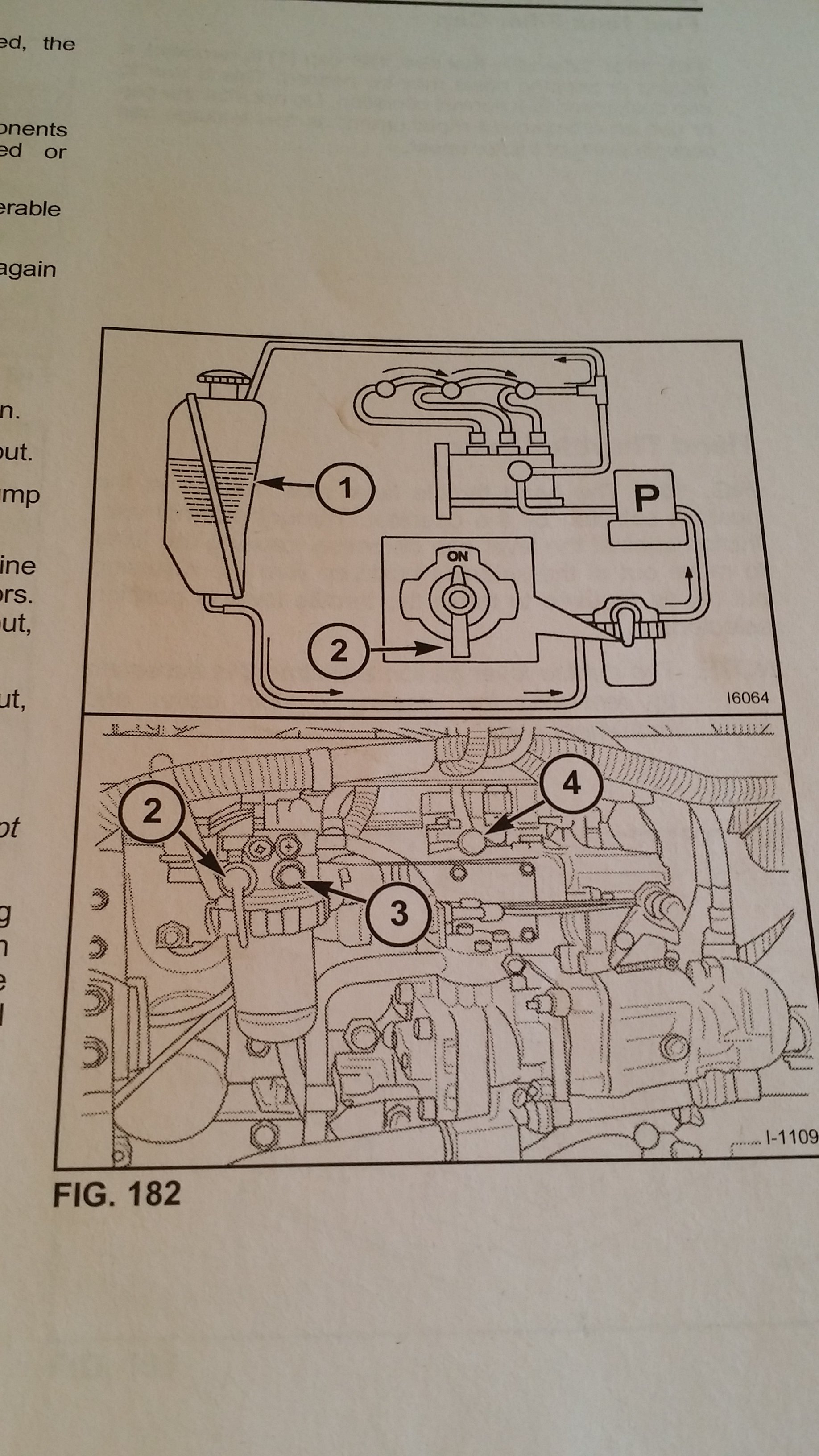

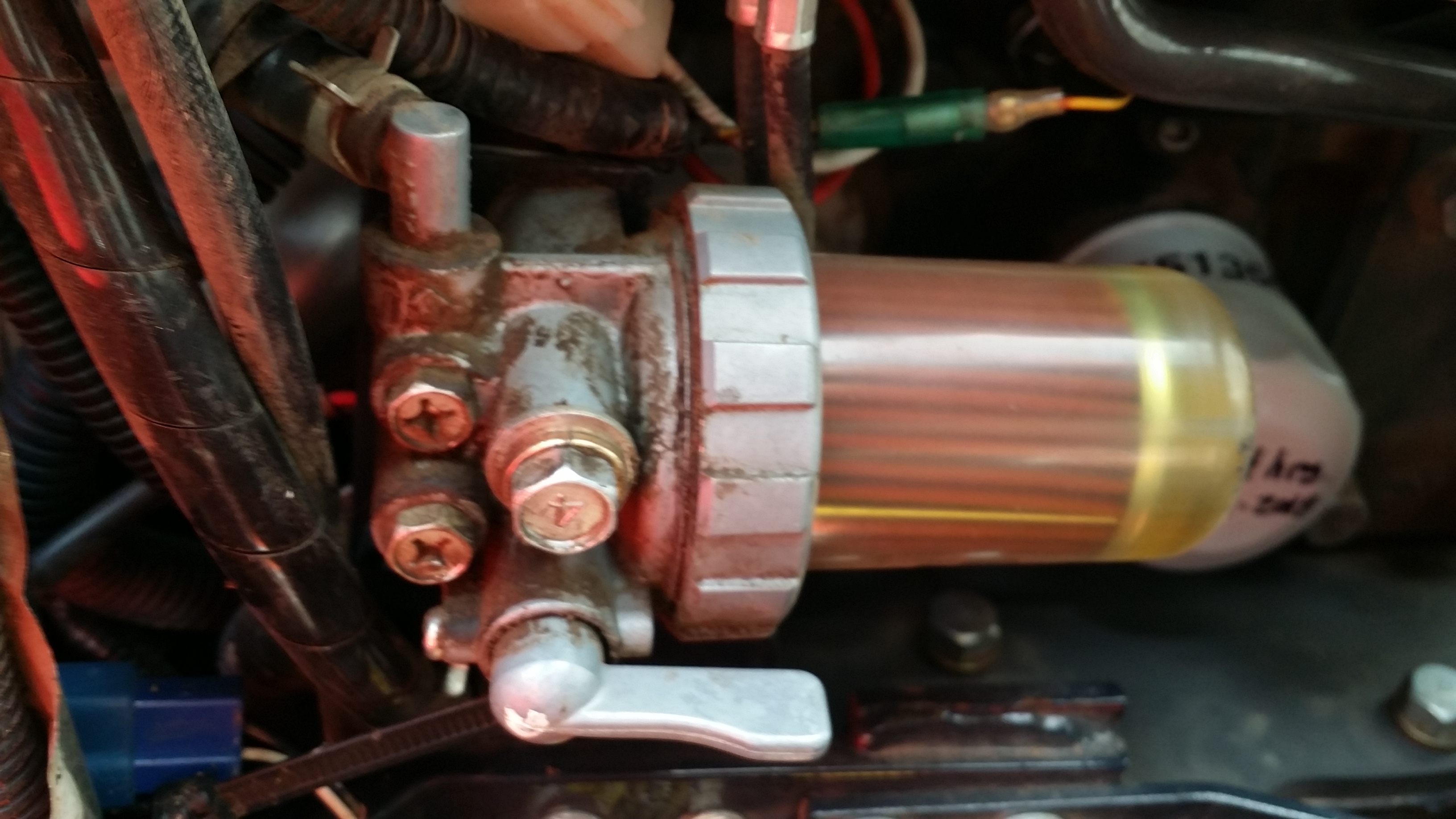

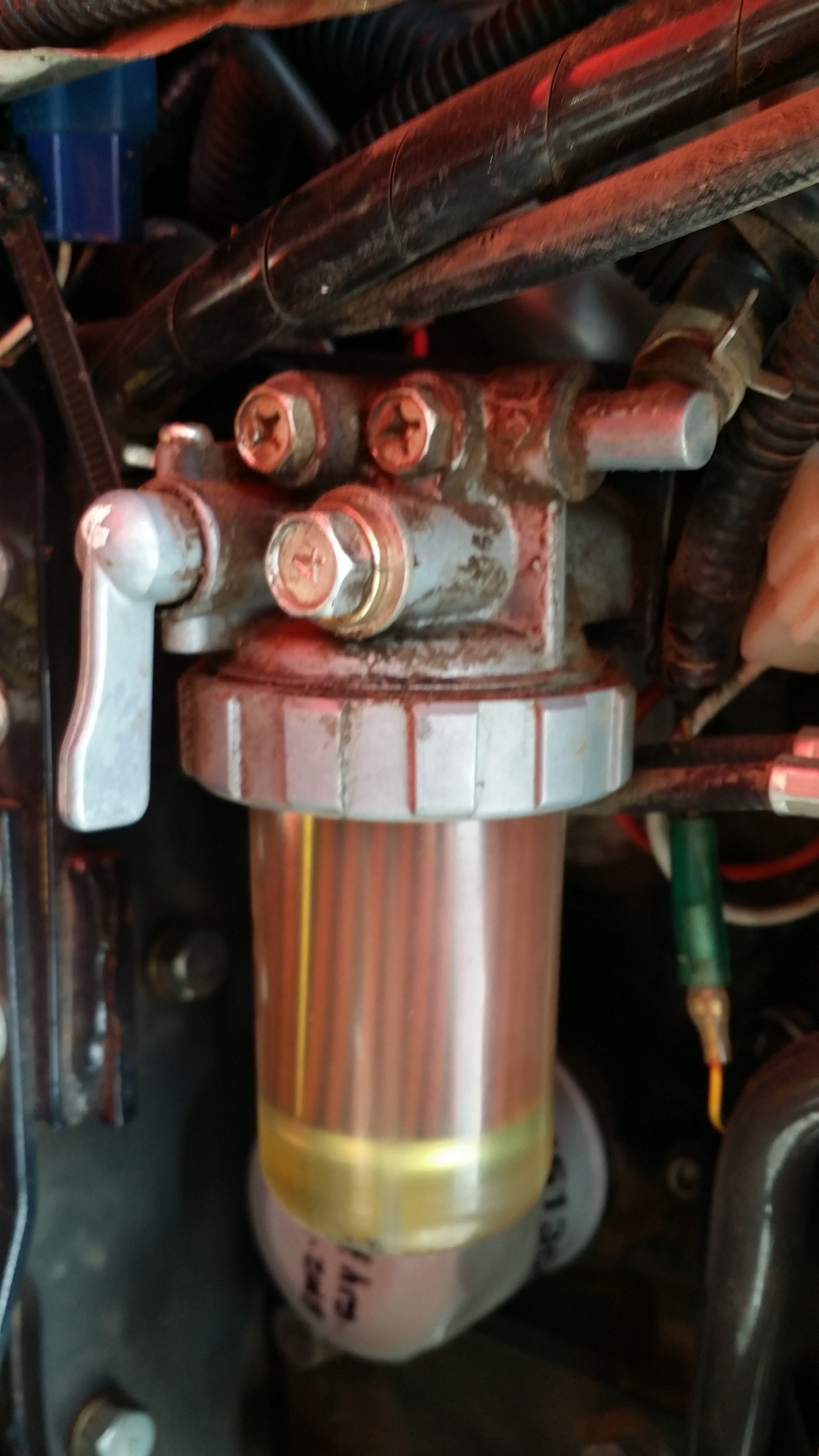

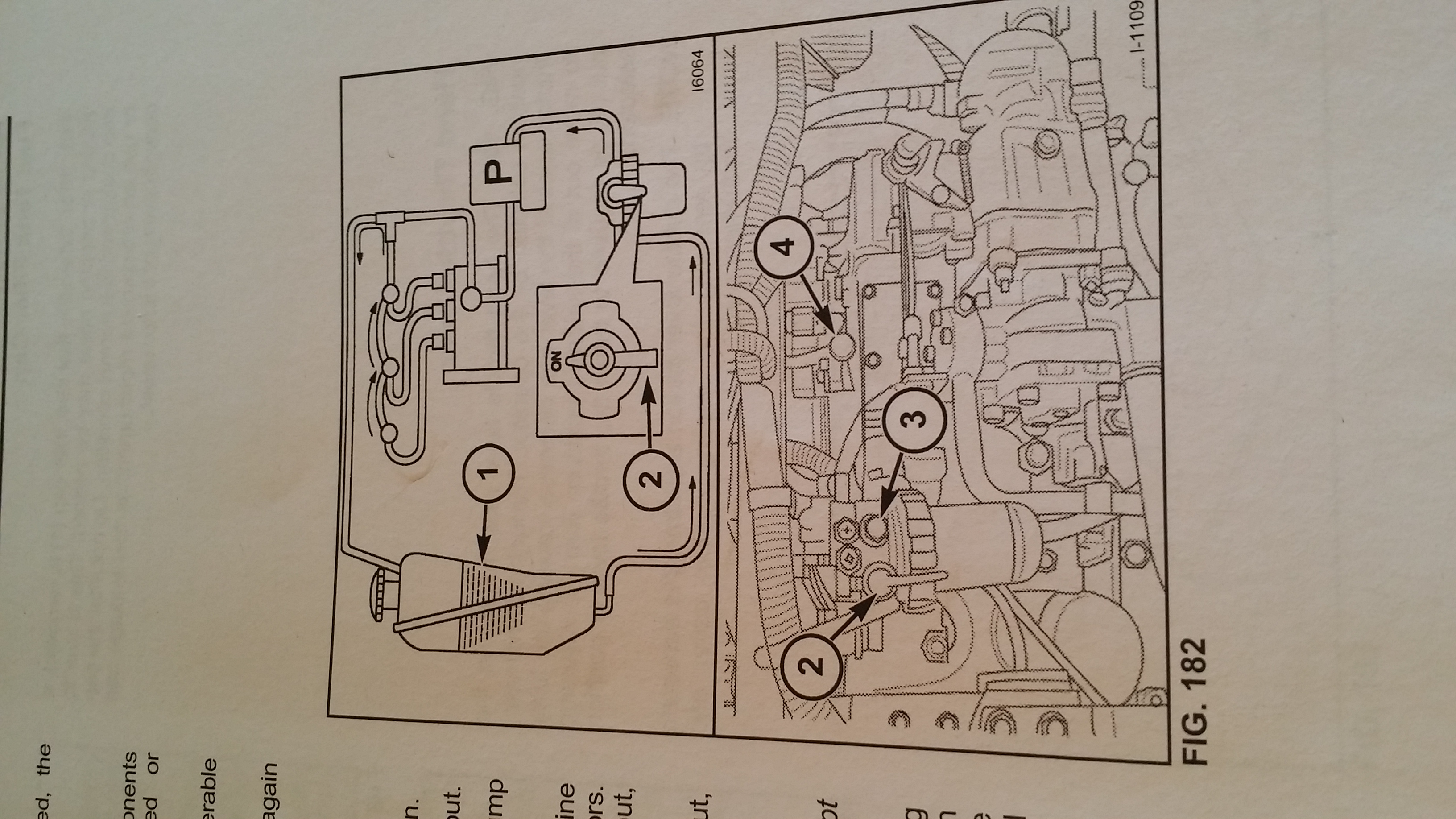

I decided to change the fuel filter element. This is where I ran into a snag in the owner's manual. I was reading the section on how to bleed the air out of the fuel system (see attached photo). The manual instructs you to bleed the air at the fuel filter by opening a screw. The one pointed out in the manual is actually the filter's 12mm mounting bolt (see #3 in figure 182). So of the two screws that are located above the mounting bolt, I don't know which one to open to bleed. I also have doubts as to the bleed screw on the pump now that I've seen the first mistake. At this point in time, I've NOT opened the fuel line system so I've not introduced air into it.
So....that is where I'm at. I'm open to suggestions. I've read the various posts in the forum about foreign objects in the fuel tank such as flies and plastic shavings which blocked the fuel line causing a loss of power. Given the time of year and the symptoms I'm seeing, and the fact that it ran well for the first 3 hours of use, I'm not thinking that is the problem.
If someone could point out which screw is the bleed screw on the filter and the pump, I would appreciate it. I've included photos taken of the manual and of my tractor. Any other suggestions are welcomed. I'm not too crazy about a fuel tank removal to check for objects given the ambient temperature this time of year and an unheated garage. :) Worst case scenarios is I call the MF dealer next week and take it to their shop. I'm worried that the problem might not show up once it gets in a warm shop...I don't know.

I would suggest to try the scew with the philips and hex on it above the mount bolt..

Your fuel bowl doesn't look like gelling is the problem and unless you have a hole in a supply line you shouldn't have air in the system.

I agree that the fuel doesn't look gelled in the bowl...but that is what I'm thinking it might be. But it was obvious today with the temp being colder that the problem was worse than yesterday. Not sure what the filter would look like if the wax was plating out on the filter or maybe in the fuel line itself.

Yes, that sounds like a good plan. Remember, if the fuel isn’t treated yet and the fuel temperature is below the cloud point, your anti-gel won’t work. The cloudy fuel you see is paraffin molecules already stuck together in clumps too big to pass the filter. You can treat this fuel, but then it must still get warmed up enough to “unclump” the molecules. Then it will stay “unclumped”.
(Anti-gel works by surrounding EACH wax molecule with a shield that prevents them from sticking to each other)
Can you bring that fuel inside somewhere for several hours to get it to 40*F or so?
If you can safely apply your heat gun, try focusing on the filter(s). It will take half an hour to get the filter warm enough to unclump the wax and get it to pass the filter.

I would save myself all that trouble & crack the inlet bolt ON the inj. pump..
Turn the key switch on IF you have an electric supply pump on your machine..
THAT'LL push all the air out.. Tighten it back up & crank it..

This morning, I got up and put my industrial heat gun about 18" away from the fuel filter assembly. Turned the air speed switch to high and set the temp for about 50% of max. At that 18", it felt comfortably warm but no where near hot. I let the heat gun run for 2 hours and checked it periodically to make sure things weren't getting too hot. The filter assembly eventually warmed to about 90F.
