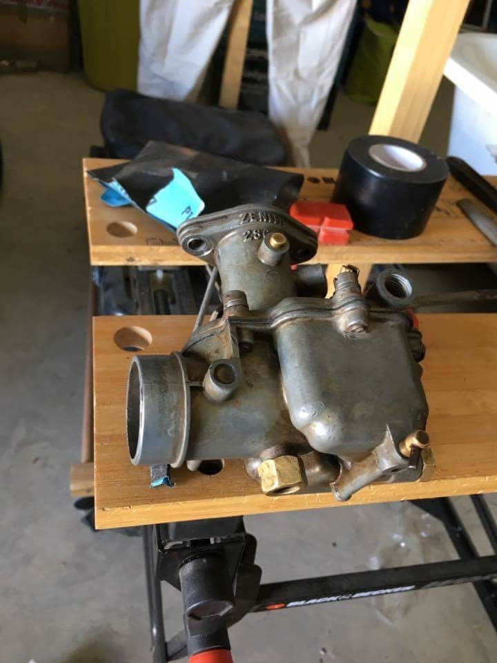

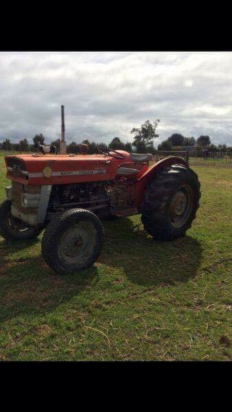

I bought an old 1967 MF135 at the beginning of this year (2016)
It is a 4 cyl petrol engine.
Whilst it is very well worn, it ran quite well for 7 or 8 months.
It had oil and filters changed. New plugs, points, condenser, distributor cap & leads, rotor arm.
I have fitted a new ROP, new exhaust muffler.
For no apparent reason, the engine has developed a heavy backfire.
So I thought it required the timing rechecked etc.
so, here is where my problems begin......

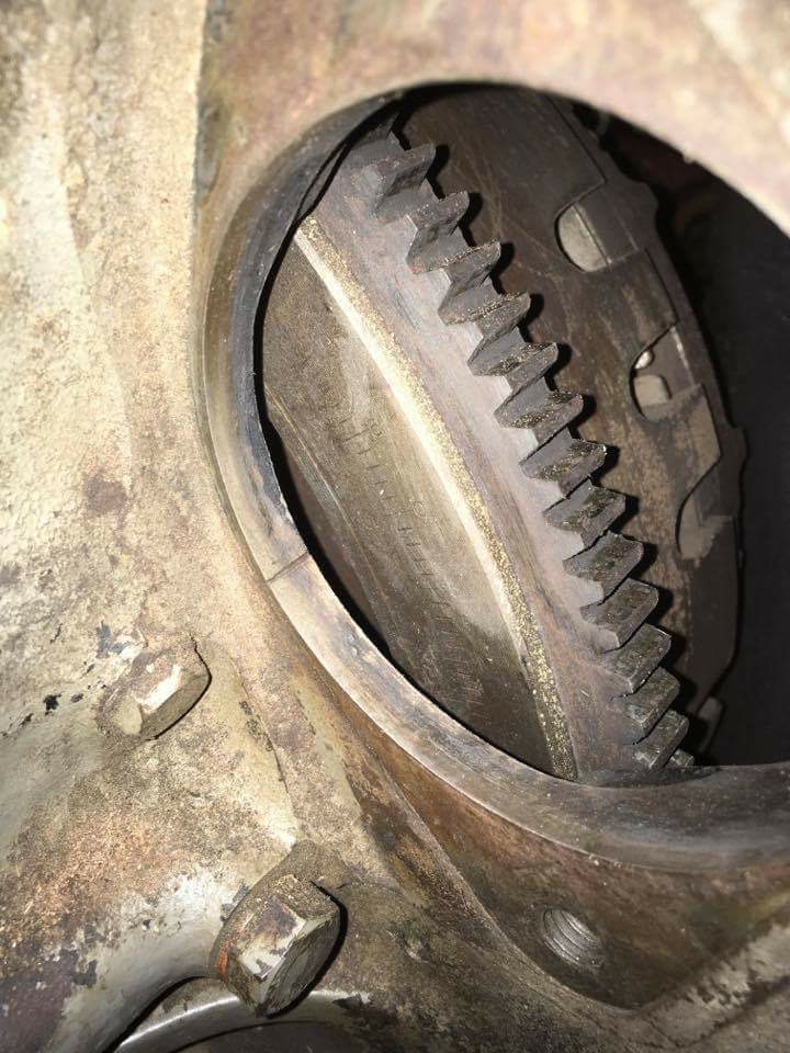

Looking for the flywheel access hole to locate the TDC marks etc.... There is no inspection hole.
I'm advised that it should be on the left side of the tractor engine (when viewed sat on it)
Just below the starter motor on the bell housing.... !!!
There is nothing there.
Any help please ?

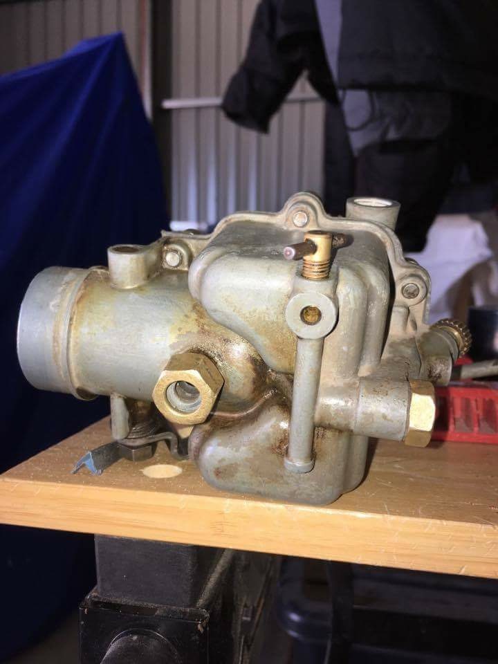

Also, I took off the zenith 28G carburettor and have checked it over and cleared all jets out and renewed the gaskets etc....
But underneath the carb body there is a hole into the bottom of the throttle chamber from atmosphere.
Obviously this is sucking extra air into the throttle chamber as well as from the air cleaner etc....
Can anyone help with their thoughts please...

Back firing can be caused by retarded timing ( either via improper initial timing, by worn distributor shaft bushings, failure of the centrifugal advance to function properly, etc) or by excessively lean fuel/air ratios ( leaking air downstream of the carb metering section via a leaky carb to manifold gasket, leaking head to manifold gasket, rusted or burned intake manifold, or misadjusted or clogged fuel metering jet).
What engine does your tractor have? Since you state it is a four cylinder, I presume it's a Continental Z series. What was the result of your timing check? Did you check the centrifugal advance mechanism ? The flywheel timing mark viewing port on the Continentals is below the starter assembly on the engine aft flange that the transmission bell housing bolts to.
"...underneath the carb body there is a hole into the bottom of the throttle chamber...." I believe the hole you are referring to is in the carb inlet where the choke is located and thus does not directly effect the carb fuel metering. It can however be a source of dirt. In some carbs, it is generally plugged with a piece of sintered metal and serves as a drain when the carb is "flooded " by over choking. I'm not familiar with the Zenith carbs so this is a guess on my part.

There should be a hole to view the timing mark on the flywheel on the lower left side behind your left foot when seated. It least that where it was on my Z145. You could always use the old school method to find TDC with number one cylinder when it reaches the top.
