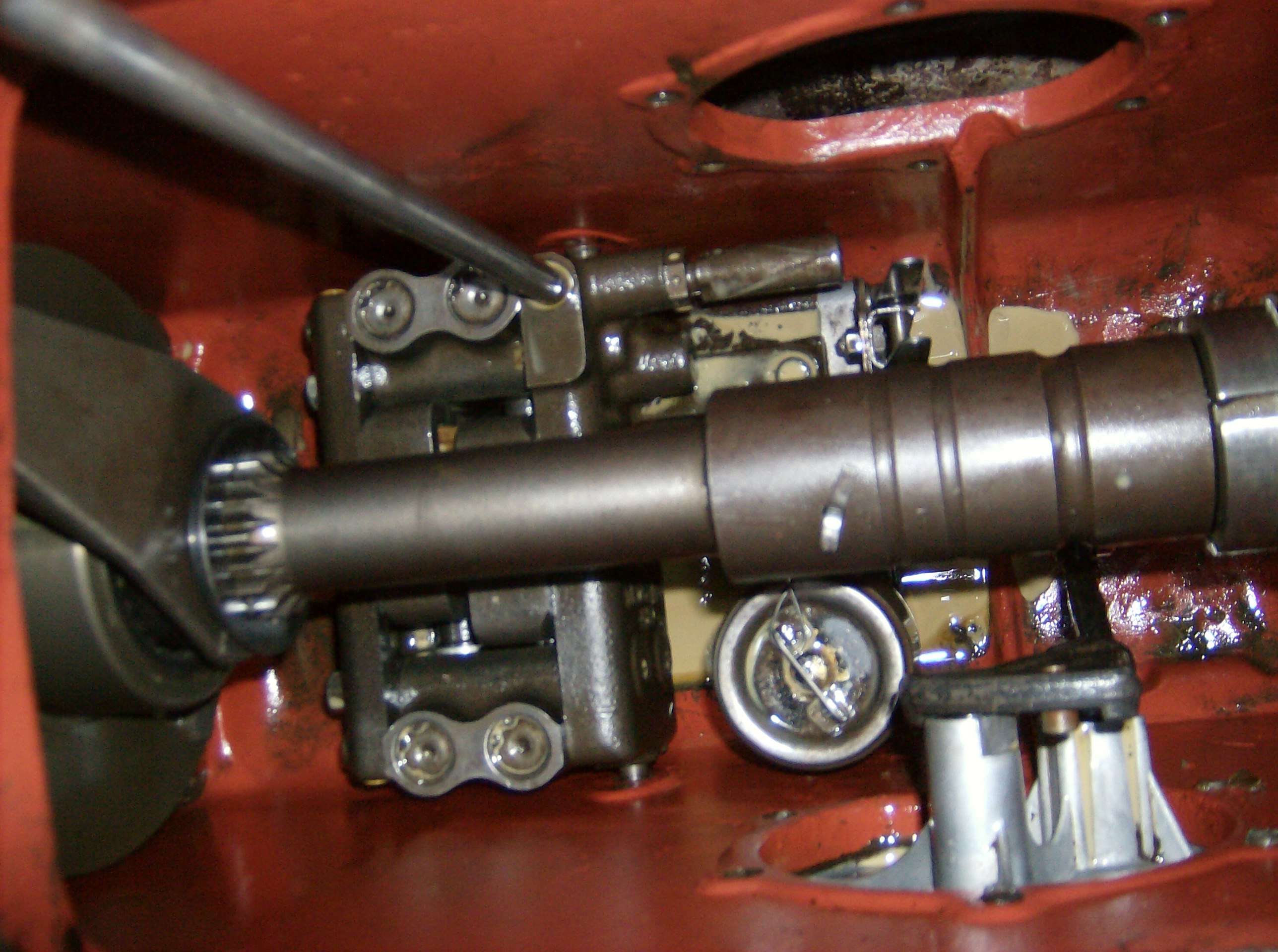

Picture of it from the top looking down. As has been said, it's adjacent to the side cover.

   / MF135 Hydraulic Filter #8
I would replace it. This is a screen filter and is pretty cheap. This is a filter that gets changed about ever 10 to 15 yrs or when people find out about them. :thumbsup:

Well dang. I was under the assumption that it didn't have a hydraulic filter(should have asked on here first), so I changed the hydraulic fluid this past weekend...is it possible to replace this filter without having the drain the fluid?
   / MF135 Hydraulic Filter #10
If tractor has 2 stage foot clutch for PTO strainer can be removed through PTO shift cover access hole. Tractors with hydraulic PTO three point lift cover has to come off as oil lines are attached to side cover on inside, can't be removed until lift cover is off first.
