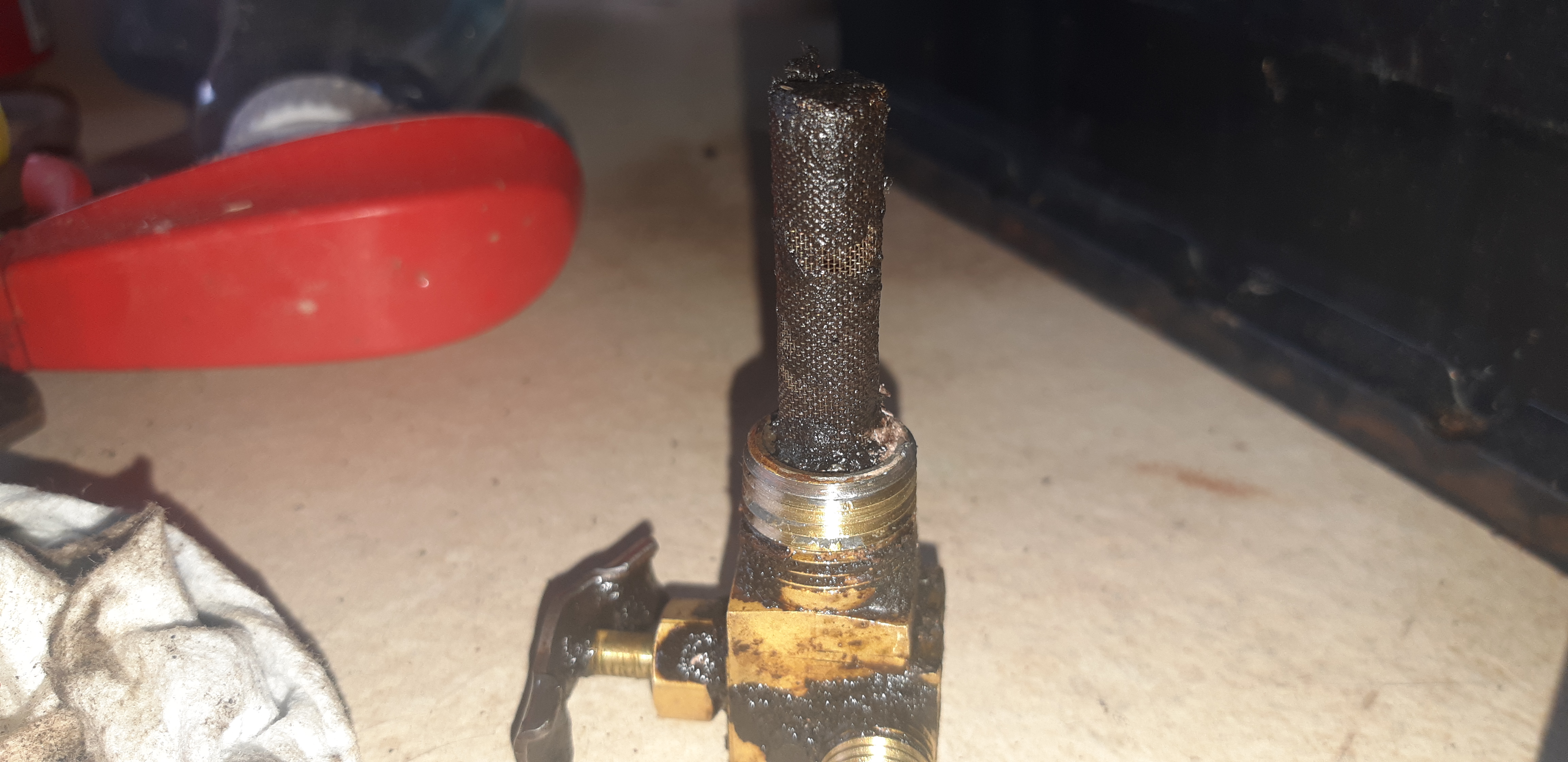

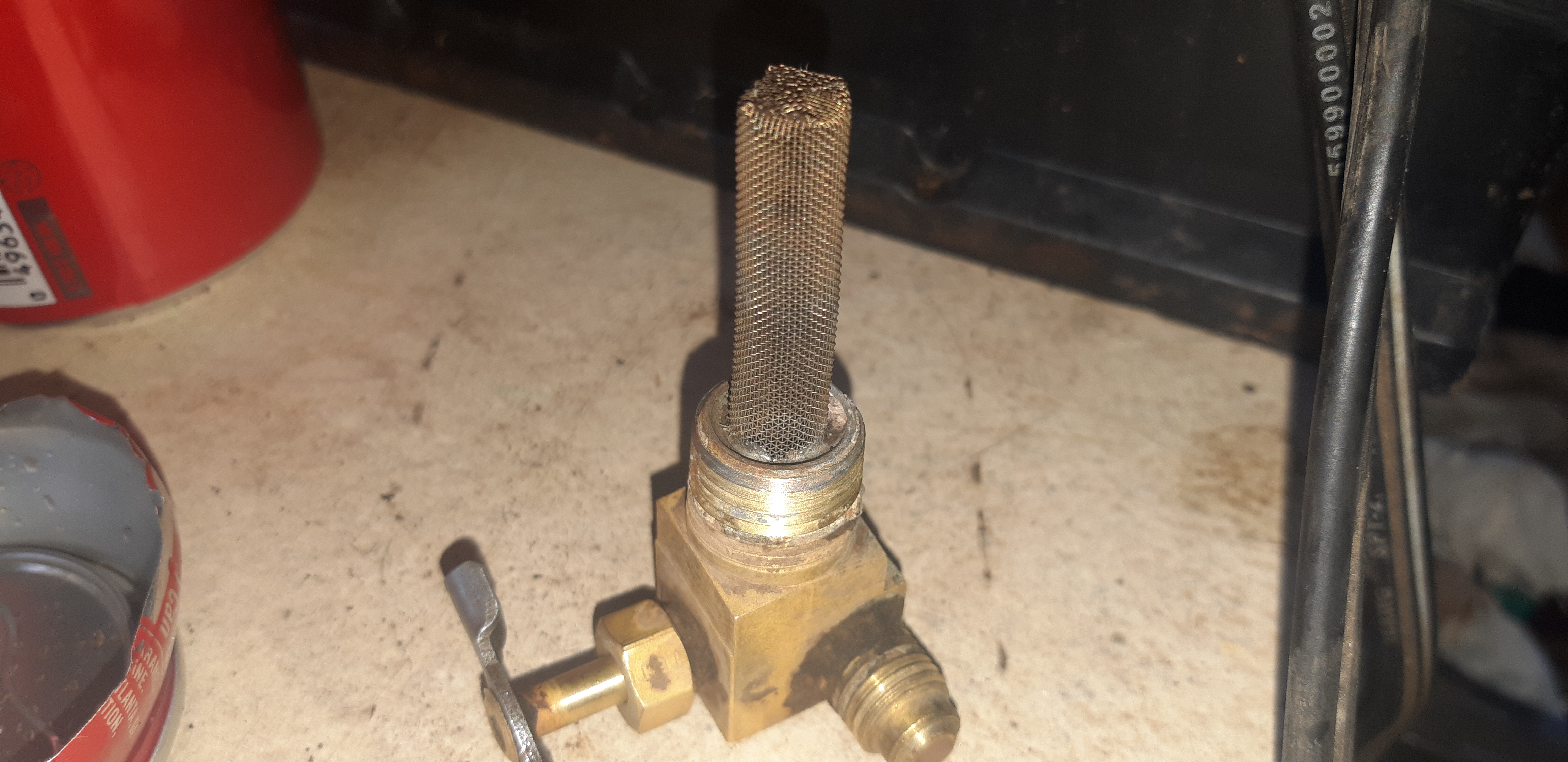

Finally got back to dad's ol 135...
Had to repair the cable from the battery to the starter, it was coming out of the crimped end at the starter, so I replaced the cable with a longer one, cleaned both ends well, and got that back on. I replaced the fuel filter a week or so ago, that's when I found the cable issue.
So, after the filter change, fuel flow was clearly an issue.. as there was no flow. Yesterday, I got the tank removed, drained, and found the fuel strainer/valve assembly totally clogged. I'll be putting it back together today or tomorrow, and would guess it will fire right up when purged of air and properly primed.
Pictures of before and after cleaning the strainer.

After putting the fuel tank back on, the lines all hooked up, fuel system bled, the ol Massey fired right up. Ran it today, with the rake and then baler, ran fine!
Lesson learned, check the screen on the fuel tank valve.
