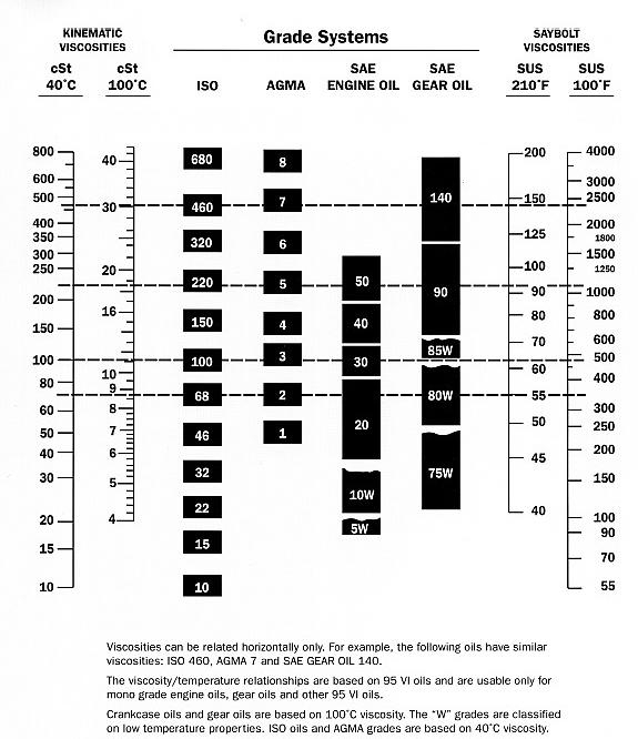

Most use gear oil ...
I know, that's why I asked.
There isn't a substantial difference between the hydraulic oil viscosity, and 85w or 90w gear oil viscosity, at normal temperatures. That's why it doesn't "fix" the leak, no matter how many times people try it.
Most hydraulic transmission oils are around a 30w. The exception to this is the Kubota UDT fluid, which around 20w.
Hydraulic oil is measured on the engine oil scale, and gear oil is measured on the gear oil scale.
If you want a "thicker' oil, you would have to put in 140w gear oil. Which is probably not a good idea. But, I'm always wondering if anyone has actually tried it.
