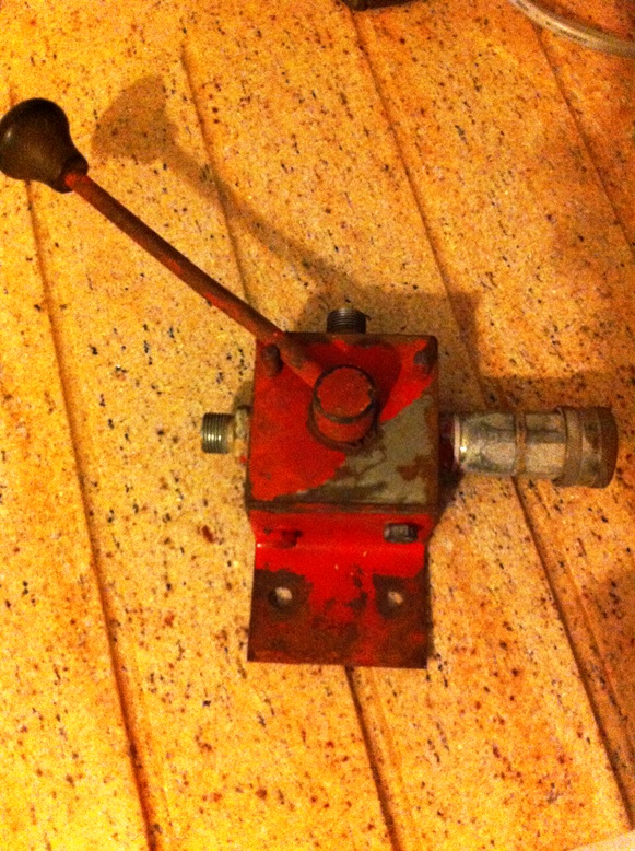

See below for a photo of the control lever which I got with the loader. It seems to have a quick connector on one side (for something else?). The other side went to the two ram pipes via a T, and the top appears to be the inlet pipe.

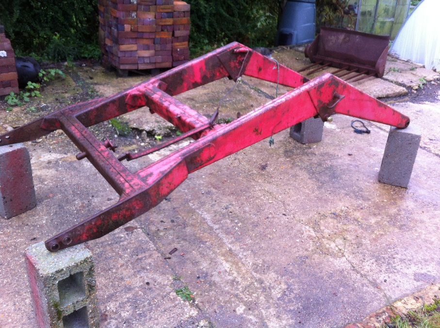

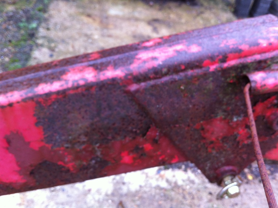

Hi again Hutch.
Well its quite difficult to take useful photos as the loader is in parts being refurbished by me at the moment. I've got quite far, and am pleased with the results up to now.
I have added a picture of the as-yet untouched forks for interest and to see what it was like before I started work on it all.

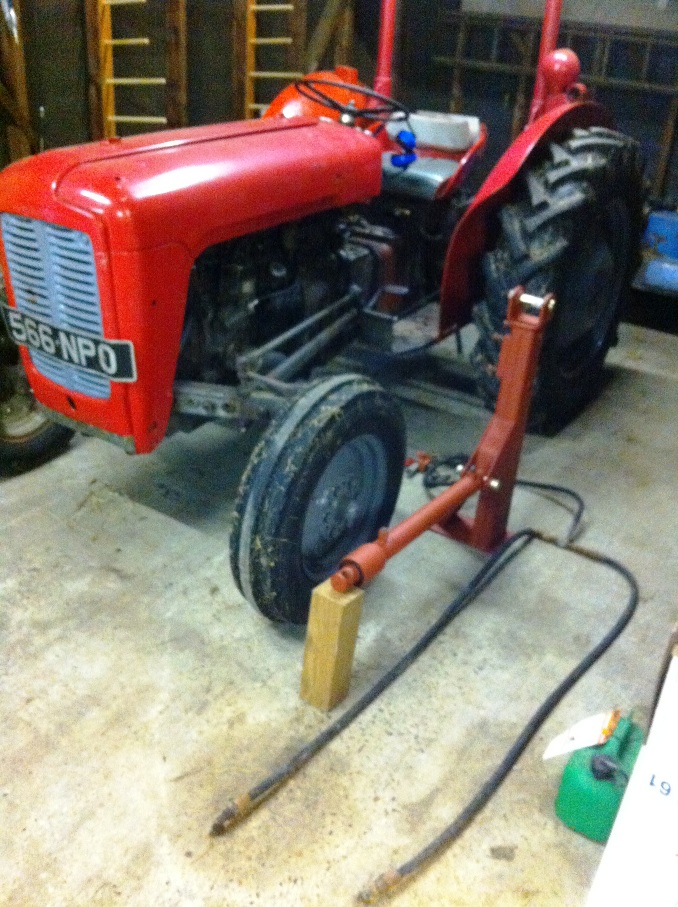

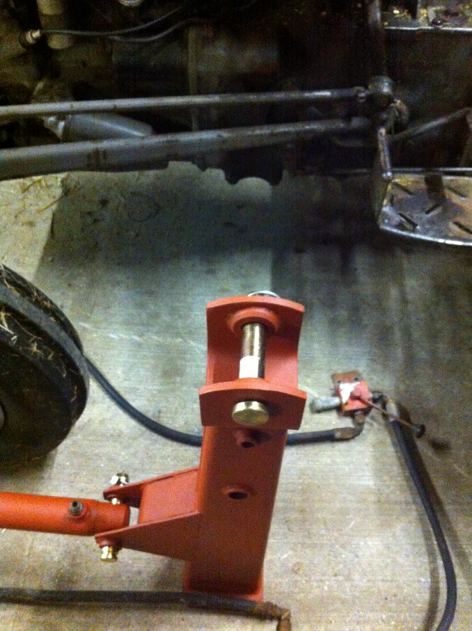

I have laid out the parts next to the tractor so you can see where I am coming from.
I have positioned the uprights lateraly where they mount onto a cross beam on the underside of the tractor (not yet fitted).
Some of my observations.
The T on the hoses has a distinct angle on the input side. I am guessing that it makes sense that the input hose angles upwards when mounted, leading me to believe that the control would have been to the RHS of the tractor.
The rams are single acting. The top inputs are blanked off, and there is only one set of hoses. I assume that when the control is shut off, then rams would drop under the weight of the load/forks, but where does the oil go?
The dead side of the control has a quick connector on it (See original post). Can we safely assume that this was just for some other attachment(s) in a previous life?
So does any of this help with my original question: whats the normal routing of the hoses and control lever, and how does the control connect to the hydro output on the tractor.
Cheers, Jim

G'day Jim.
The valve in the photograph is not familiar to me but if you had an air compressor you would be able to work out the flow path of the valve does the valve have two holes drilled through the body same centre to centre measurements as the hydraulic blanking plate on the front right hand side of the hydraulic lift cover if so it will bolt on in place of the blanking plate, Caution Do not remove the plate unless the three point linkage is at its lowered position ,I suspect that the quick connect is for a hydraulic tipping trailer!!
You are in the UK. So if you contact your local Bareco, Sparex or Bepco agent they will know what you want.
Ask for a beecraft type selector valve,this is a push pull type hydraulic valve which replaces the blanking plate mentioned above,connect the loader hoses directly the the valve .
With the valve button pushed IN this will give you three point linkage control .
with the valve button PULLED OUT this will give you hydraulic supply to the loader it will be controlled by the DRAFT lever the one nearest the mudguard just play around with it and you will work out how it works.
The position control lever will have to be in the forward Fast position this will give maximum hydraulic pressure when you are lifting something .
The lift rams ,the ram hydraulic connections should be installed with the hydraulic connections facing up ,not as shown in the photographs.

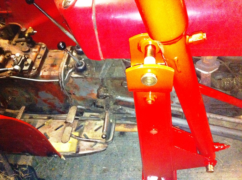

OK, well things have moved on a pace this last week, and Ive started re-assembly. The cross members and uprights are all back on, and the cylinders are in position.
I have bought and installed the diverter valve and replaced the O rings on the stand pipe while I was about it.
So, in reference to the attached picture, what is the correct routing of the hydraulic pipes from the diverter valve to each cyclinder?
Should the hose to the LHS cross under or over the gearbox?
Where should the T be located?
How can I route the the RHS cylinder and still avoid the exhaust?
How my 'slack' in the hoses do I need for the articulation of the cylinders in operation?
Does anyone have a picture of their loader hose layout?
Thanks all. (especially Hutch)
Jim
