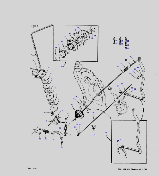

Bought a new to me 65 and and i dont see any spring on bottom of throttle shaft? anyone know where you can buy the spring? Its item 11 in the parts diagram.
Anyone have any pics of throttle linkage?

I believe you are overthinking this. Get a good measurement for length and go shopping. I'd start with a soft spring and work my way up.
What exactly does this spring do?
/ MF 65 throttle spring
its a the balance spring on bottom of throttle shaft it attaches to a curved arm on one end and the balance bracket on the other, I guess must keep tension on the throttle handle
you need to hold it down to increase rpm, if you take your hand off it goes back to idle
/ MF 65 throttle spring #9
Best I can tell from your pic, parts 4 and 7 combine to hold the throttle in place. 4 are fiber discs that work like brake pads or clutch discs. 7 applies pressure and is adjustable using the bolts that hold the stack together. I think if you tighten the bolts and pressurize the stack, the throttle will staywhere you leave it.
The spring might hold tension on the carb linkage assembly. But don't think it has anything to do with position control of the lever.

ok got a couple of carb springs from o'rielly's will see if they work. Also bought some cork from walmarts for new friction disks if needed. Thanks for the explanation

Added the spring and now it actually will idle were it is suppose to and I can set the rpm with the handle pretty well now.

seems like I have to pull up on the throttle handle to get to work but it seems to stay. Must be an clamp or screw to tighten around throttle shaft to remain in pulled up position.
