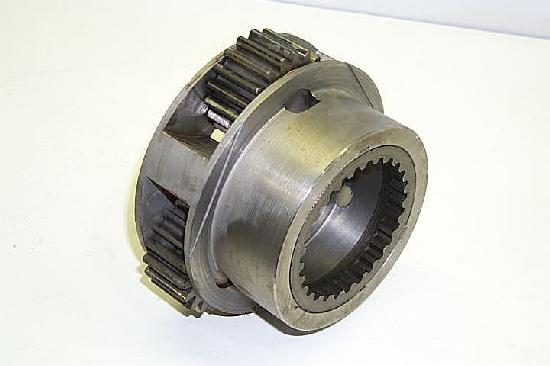

It is the planetary high-lowgear, if you pull the top cover, IIRC, ours looked like this:

Nothing is ever easy it seems. The Planetary Carrier Assembly is a component of the rear differential. It doesn't have any place to weld. Maybe it connects by the main drive shaft to the transmission? At the transmission end you probably are thinking of the "pinion gear gear assembly". I can't show you a picture of the part from the dealer as you can only buy parts within the assembly. But on my manual I can see it on Transmissions Group II Section B part 1 page 279. Maybe something on that could be welded with cover off but looks like I'd have to separate the tractor between the differential center housing and the transmission. My brain is sore now. Need to take it apart, just worried I won't see the problem when I do!

Perhaps I am misremembering the name of the part. It was in the transmission, NOT in the rear end.
It was quite a few years back, but we did NOT have to split the tractor to get it out, "just" remove the top plate from the transmission and we could then get it out.
IIRC it looked somewhat like that picture and the inner ring had separated from the outer ring, so it was pretty obvious what had failed.
All we had to do was remove the gear, tap it back together, then tack the two together in 3-4 places.
Aaron Z
