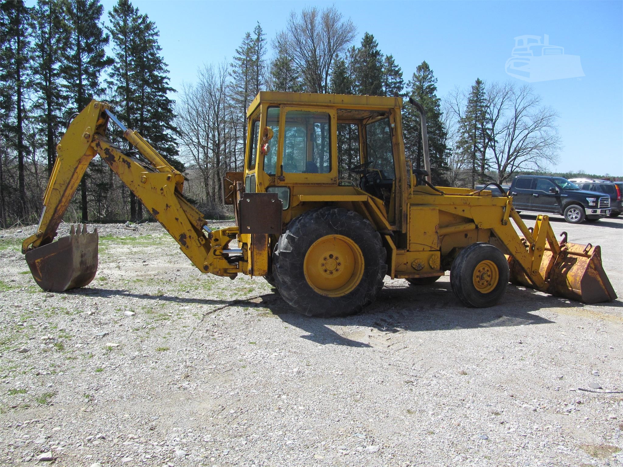

I owned a 1981 MF 60 hoe in the past. I'm assuming yours is a little newer, here's a picture of the one I had. It didn't have to many electronics on it, especially "solenoids" . I also never heard of an "override" button. Usually the large red button you described is a safety feature to "kill' the hoe, usually shutting off the injection pump solenoid. Pushing it in should kill the machine, pulling it out should let it start. Could be the wires were wired in wrong, I don't know. Where are these "hot" solenoids you described located?
It does sound like an electrical issue to me as well.
