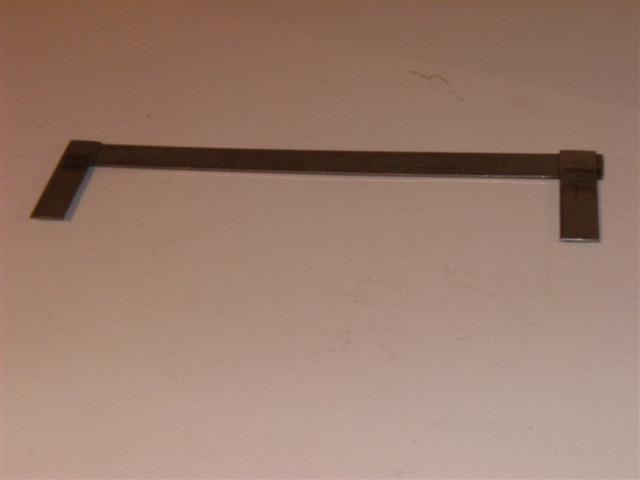

Hi,
I have a MF 50 and I'm instaling a new clutch. But I can't find any specifications to make a tool to adjust the three main plate fingers.
Does anybody have the specs?
Also the manual says that there is a spacer on the end of the input shaft. But I can't find a part number for it and I didn't see one when I disassembled the clutch and tractor.
Thanks Jesse

This is what I made up for adjusting mine hope this is the one that your that your asking about.It doesn't have to be right on the money as you use a feeler guage on top of each of the fingers to get them so that there within .oo5 in of each other.They just want them set so that they press on the release brg all even. Anyway the inside measurements are width 12 1/2" and the inside height is 2 3/8" hope this is what your asking about.I made the tool out of 1" x 1/8" flat bar and just welded them together.Larry:thumbsup:
