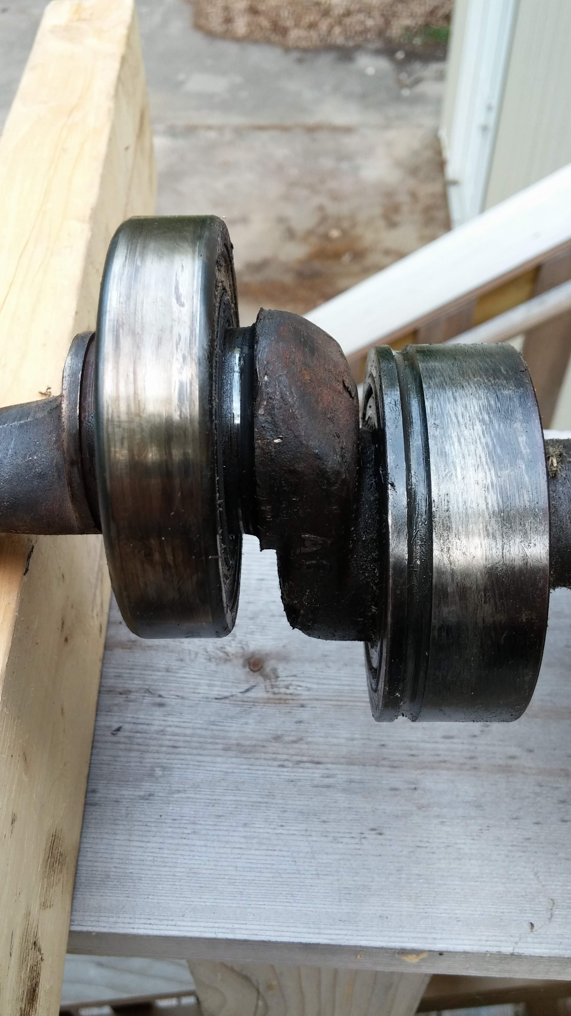

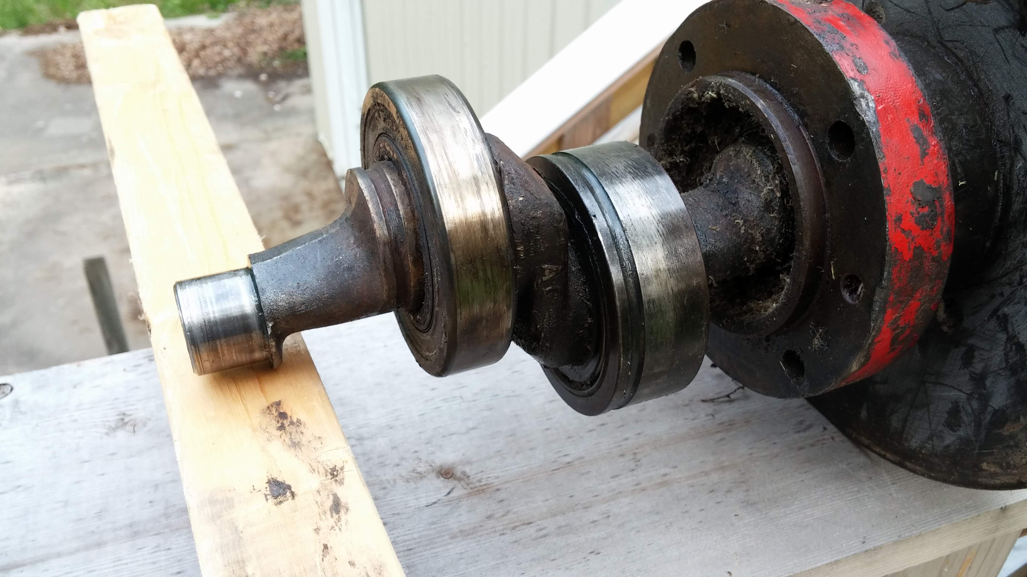

Kit, the non-contact thermometer worked great! The front connecting rod bearing was over 400 degrees and the other bearings were around 120-125 degreees. I pulled the crankshaft and sure enough the front bearing did not spin smoothly. It's the one on the left in the following photo. Crankshaft Front.jpg
Something that concerns me is the fact the two connecting rod bearings are not identical. Both Connecting Rod Bearings.jpg The bad bearing is narrower than the other one.
According to the parts diagram both connecting rod bearings should be the same. Does this look funny to anyone?

Yes they are identical. I found one place that had MF31 bearings but the small front shaft bearing was $76 so I used a 6205 which has some problems but can be made to work.
I bet the big rid bearings are either NLA or $125

Kit, the non-contact thermometer worked great! The front connecting rod bearing was over 400 degrees and the other bearings were around 120-125 degreees. I pulled the crankshaft and sure enough the front bearing did not spin smoothly. It's the one on the left in the following photo.View attachment 376548
Something that concerns me is the fact the two connecting rod bearings are not identical. View attachment 376549 The bad bearing is narrower than the other one.

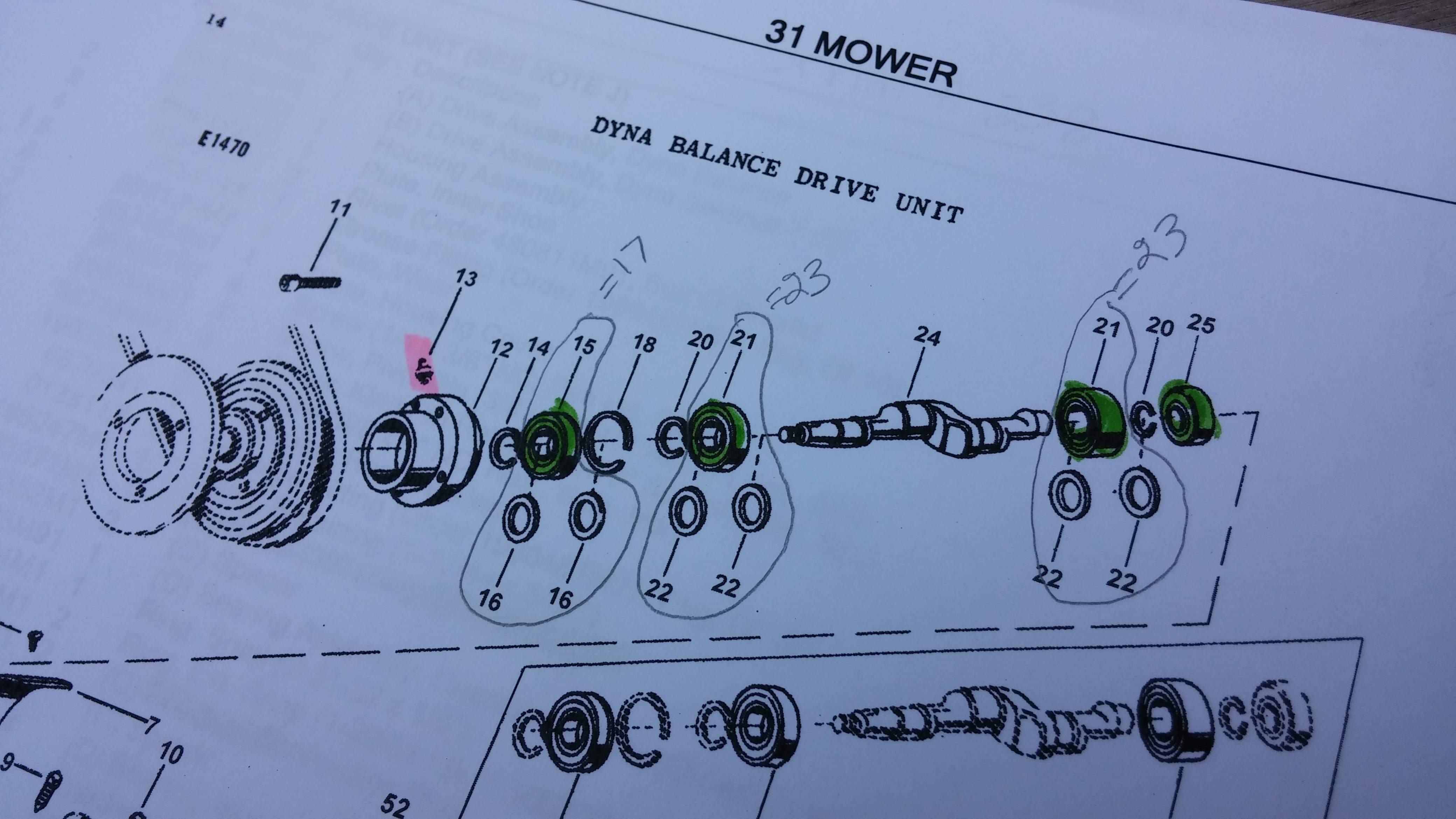

I couldn't find the parts diagram, can you link to it specifically, please?
The crankshaft journals show wear, obviously, but where are pics of the actual bearings for each journal? If you can show the outer journal's bearings, and the connecting rods end caps beside them, it would make it easier to determine if there is anything really funky about your setup.

I bet the narrow rod bearing (non-original) has no grease hole. Or maybe it rotated such that the grease hole does not align with the fitting hole. I bet you can't get another original. I'd take that narrow one to a bearing shop & replace it.
If you can't get one with a grease hole you will have to grind a grease hole in the one you have. I have used a dremel with the cutoff saw for this. Grind until its so thin you can break thru with a pick. Then you haven't contaminated the bearing. You might test-grind the bad bearing first to learn how. Then you might grease it and run it (then go get a new one when you have time).
Take a closeup pic of the bearing with your phone so you can see its bearing spec numbers. I'm curious what bearing it is (in case I have to replace one).

Coyote, it appears Agco has shut down access to their parts diagrams unless you have a logon. Fortunately, I printed a copy of the MF 31 mower diagram before they locked it down. Attached is a copy. It shows both rod bearings as item 21, which is part number 833770M1.MF 31 Crankshaft dwg.jpg
Sodo, thanks for confirming both bearings should be identical. I thought something looked wrong. You are correct, the narrow bearing does not have a hole in it to allow grease to enter the bearing. I will take some close up pics of the bearings later today.
