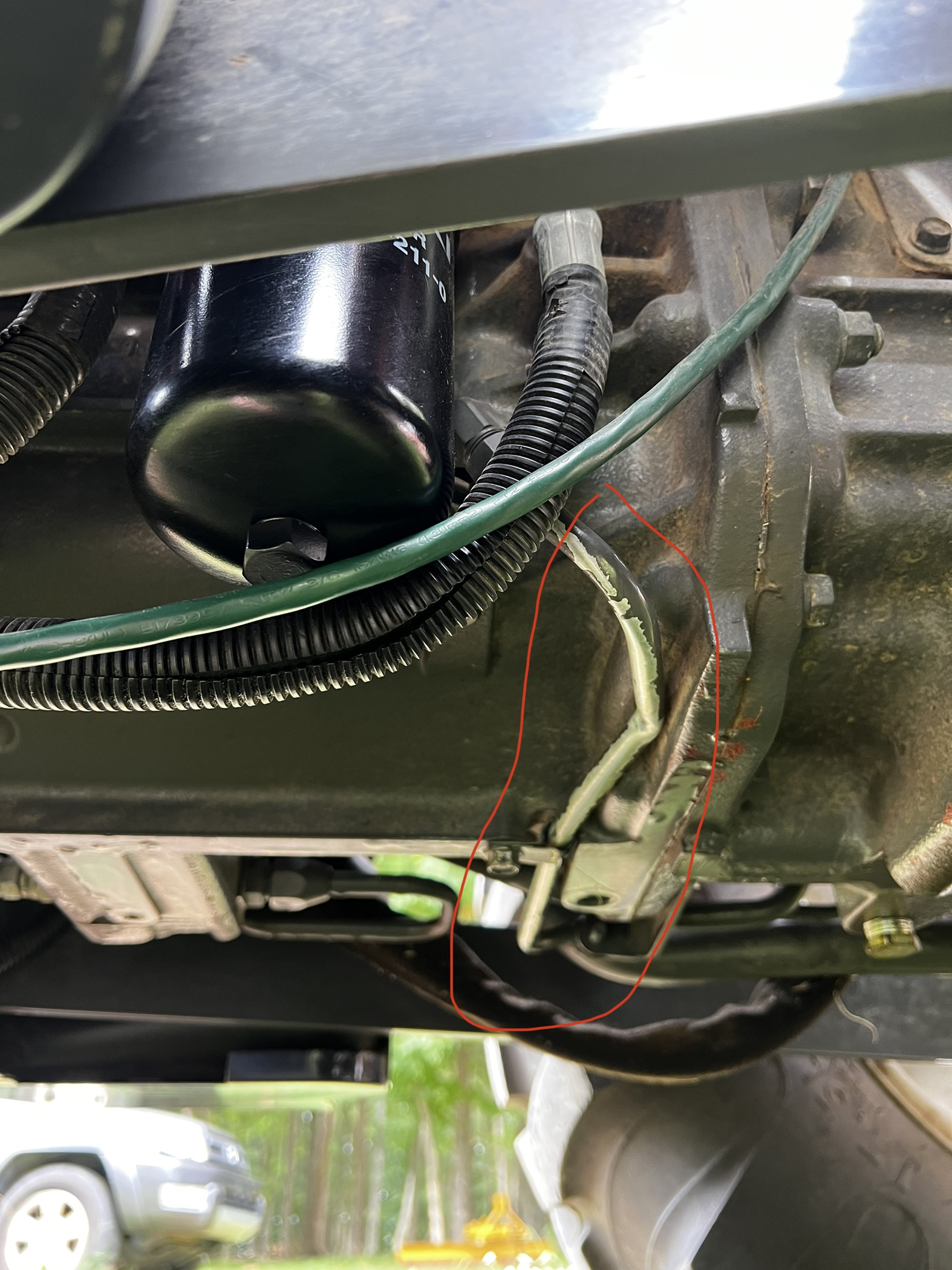

MF 2706e Hydro bogs down w PTO
   / MF 2706e Hydro bogs down w PTO
#11

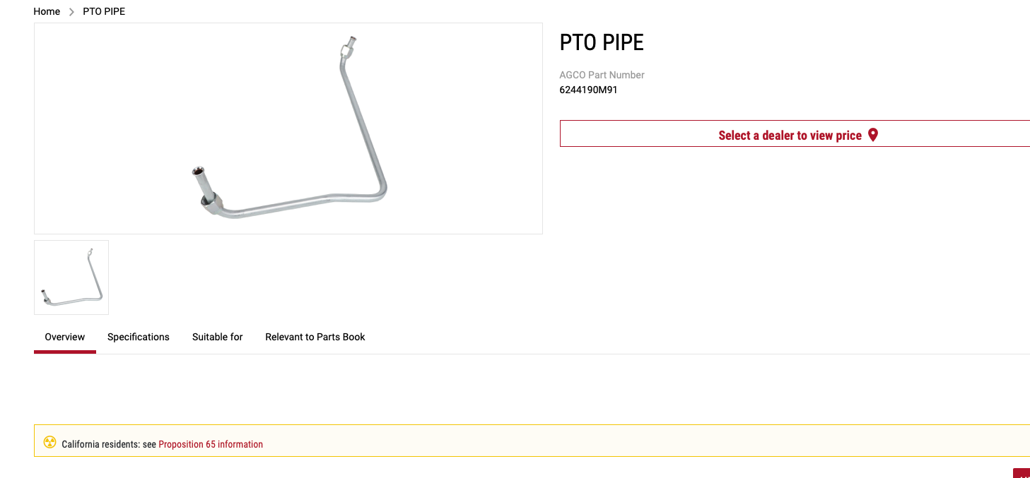

My have found the culprit. What is this metal line? Appears to be a hydraulic line to me. It's bent... Guessing that would slow the flow and make the pump work harder to keep up and the engine harder to keep the pump pumping.
   / MF 2706e Hydro bogs down w PTO #12
Interesting....I wonder what that hydraulic line actually feeds?
   / MF 2706e Hydro bogs down w PTO #14
Good job spotting it. (y) Sure glad it was something easy to fix.
