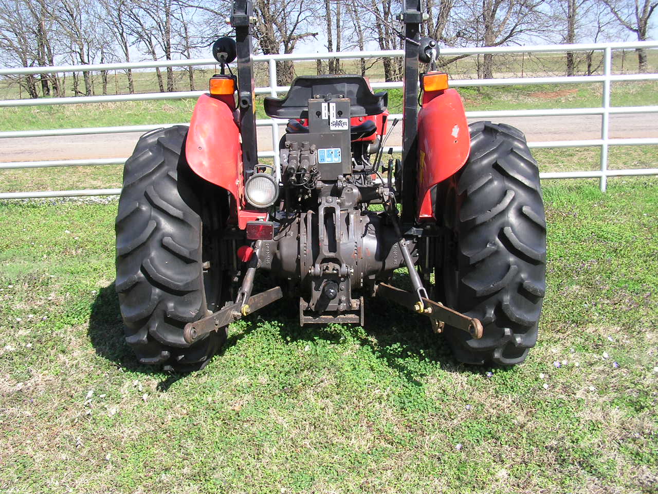

After lots of searching I can't find an answer. Is it possible to add hydraulic remotes to the 240 without having to use a divertor valve? What good is a hydraulic top link when you have to switch off the 3PH?
Anybody got one installed?
   / MF 240 Top-n-Tilt #2
I had a MF240D with two remotes, used one for a hydraulic toplink. Did not have to turn off the 3PH.
   / MF 240 Top-n-Tilt #3
Adding another hydraulic pump is the way to go if you need to operate the 3pt, and the remotes at the same time.
