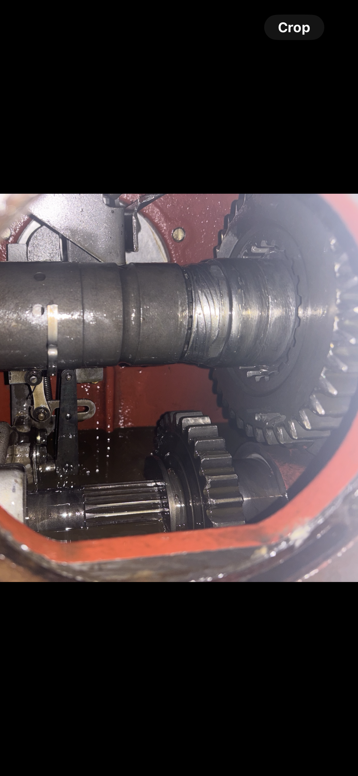

Hello all. First post. I have a Massey 231 and the PTO lever broke. After I took off the side cover, I see that the ground speed pto gear is just floating on the shaft. I’m not understanding how it stays put. I can put it back in place but it is a loose fit. The engine pto at the bottom moves freely on the splines. Does the upper pto gear need a retainer? I felt around in the oil and don’t find anything. Thanks!

Replace the gear and the shaft? Major project. And for what? A ground PTO feature that's (probably) never been used, and chances are never will be. I'd be looking for a short section of pipe, the I.D. of which will closely match the O.D. of the messed up portion of the shaft. Slice it length wise, place it around the shaft so it butts up against the gear and install a couple of hose clamps to keep it in place. Put the shifter / side cover back on and get back to work.

This seems like the most logical. Thank you for the advice and the reply’s on the other forum. I just want the gear out of the way since it will never be used. Going to my scrap pile now looking for some pipe.
